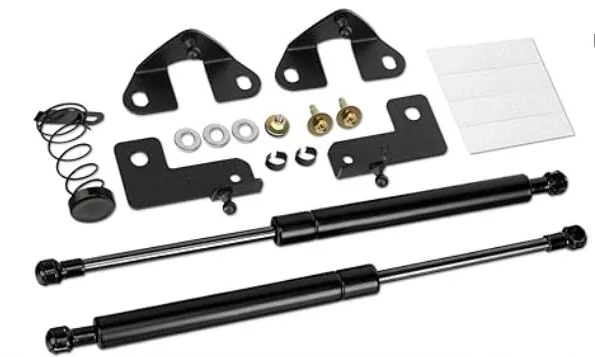

Recently ordered hood struts from Amazon, the TOYCIDFG. Okay, not name brand, and I cannot recommend these struts. Here is the deal. The hood bracket pivot point (where strut attaches) is to far forward, the struts are way to stiff, when you pull down on hood to close, the metal on underside flexes at the crease just forward of the hinge attachment. I considered that I installed the bracket incorrectly. After trial and failure I determine that you cannot install the brackets and move the pivot point. With the hood closed the strut breaks over center and pushes the hood closed. To open the hood you must overcome this tension on the closed hood, which flexes the crease in opposite direction. I determined that the flexing would eventually break the underside metal of the hood. I returned the struts. Be aware of this flexing if you have installed hood struts that the metal may be placed in a bind. Other struts may not have this issue but I highly recommend that you watch for flexing when plling the hood down. I will not be using hood struts. It sounds like a good idea, but the hood is just not that heavy.

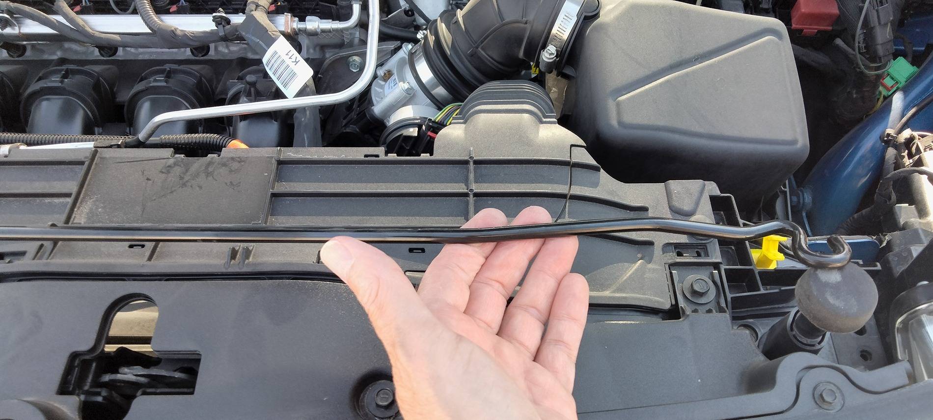

As seldom as I open the hood.
I think, I'll keep using the prop rod.
Ford Maverick Hood Struts IMG20241008130450
Simple and cheap works for me.
