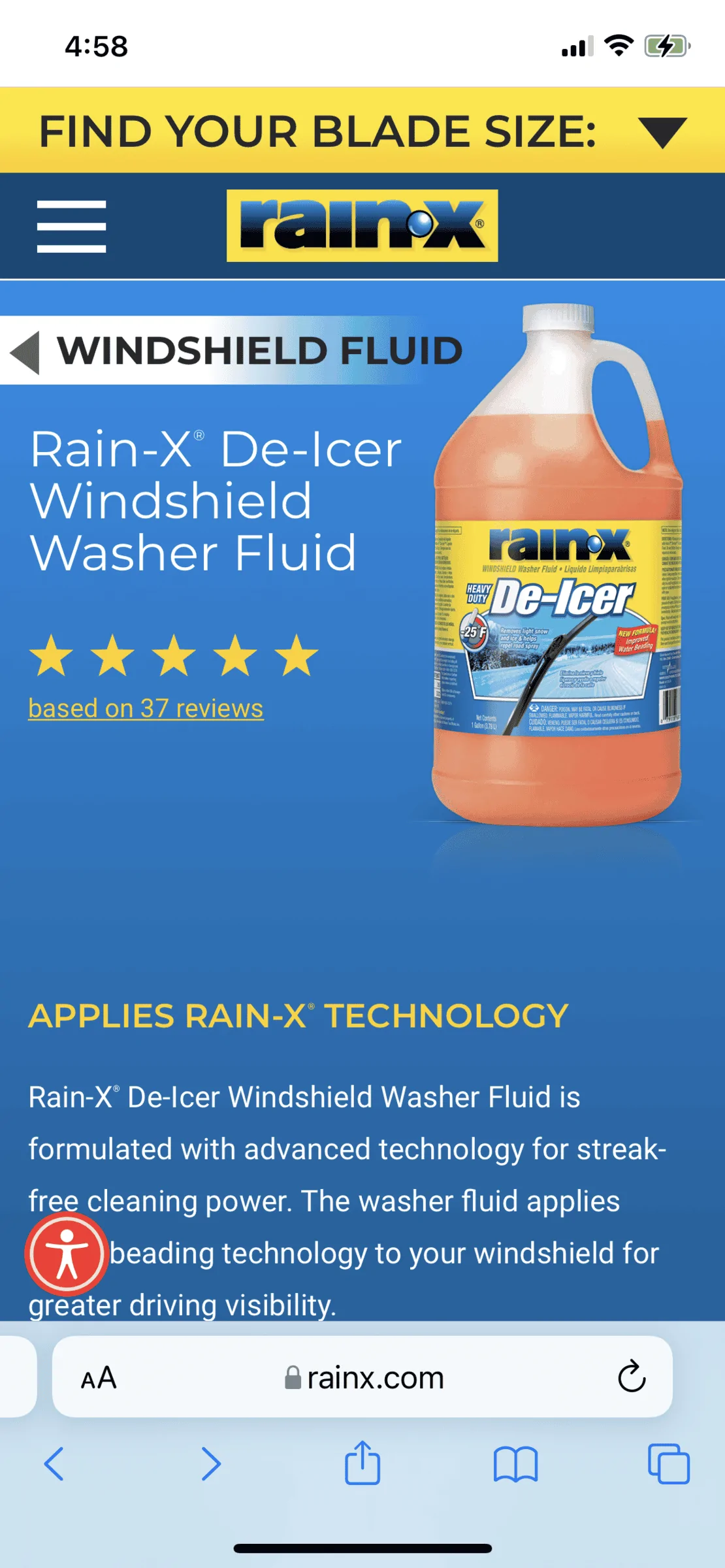

Lots of passion on this topic. I think this mistake is on the OP. IVe been using rain x windshield cleaner for ever and a day. Reduces the ice build up if used regularly. Might not do so good in Canada 🍁 with their ice age temperatures. Bonus is rain just beads up and flys off your windshield. I never put my windshield wipers up. And yeah I live in Arizona now because I was tired of freezing in Nebraska.

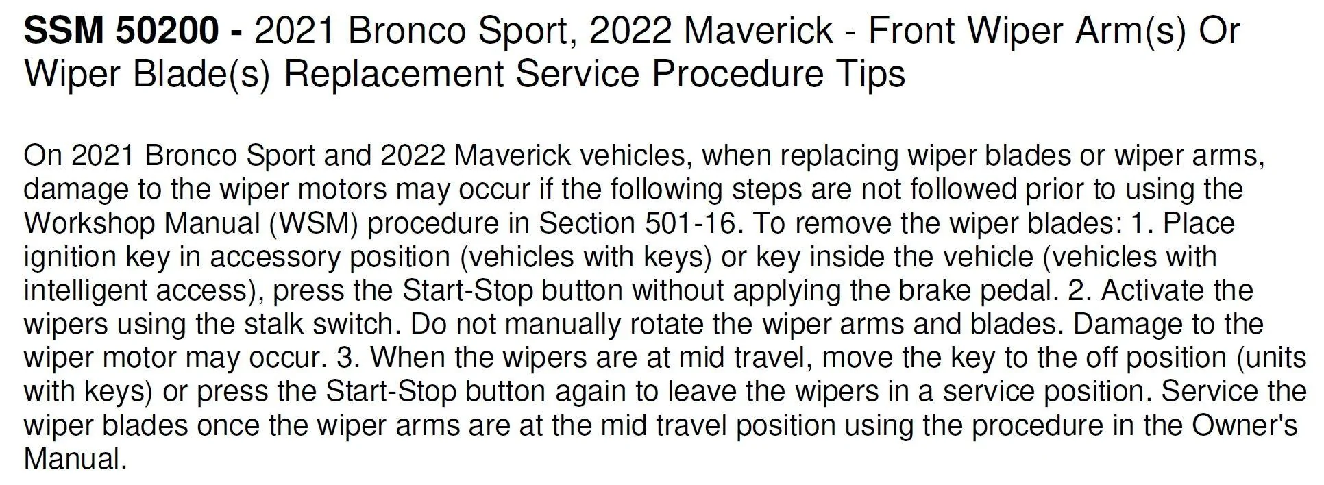

Actually the post you've called out is exactly what Ford says to do. There is a TSB on this from Ford for both the Bronco Sport and the Maverick.
https://static.nhtsa.gov/odi/tsbs/2021/MC-10202628-0001.pdf
You have to be careful, yes. You have to be careful in lots of ways to not damage your car. But saying that Ford's instruction is why people are damaging their hoods is 100% false. People are damaging their hoods by pulling up on the blades while the blades are parked.
For over 40 years now, this TSB describes exactly how I have replaced wiper blades and arms. In fact, this is how my dealer replaces blades as well. I know because they sold me a set that didn't fit and when I came back for the correct ones, they put them on for me while I watched.

From the few times I have stood my wipers up the paint on the edge of the hood has been rubbed off and is down to the metal.
A couple of previous threads have covered this subject already:
Wiper design Fail?
Wiper arm hits the engine hood
Primary reason for this problem is incorrect procedure in extending the wiper correctly:
There is an "nhtsa 10202628" warning telling you how to correctly extend the wiper blades so that they do not hit the hood (causing paint damage) or damage the wiper motor.
Would this be covered under the warranty?
No as this is basically operator error
Here is a video for doing it the correct way:
Ford Maverick Hood paint rubbed off from wiper Wiper Blade Replacement Warning
