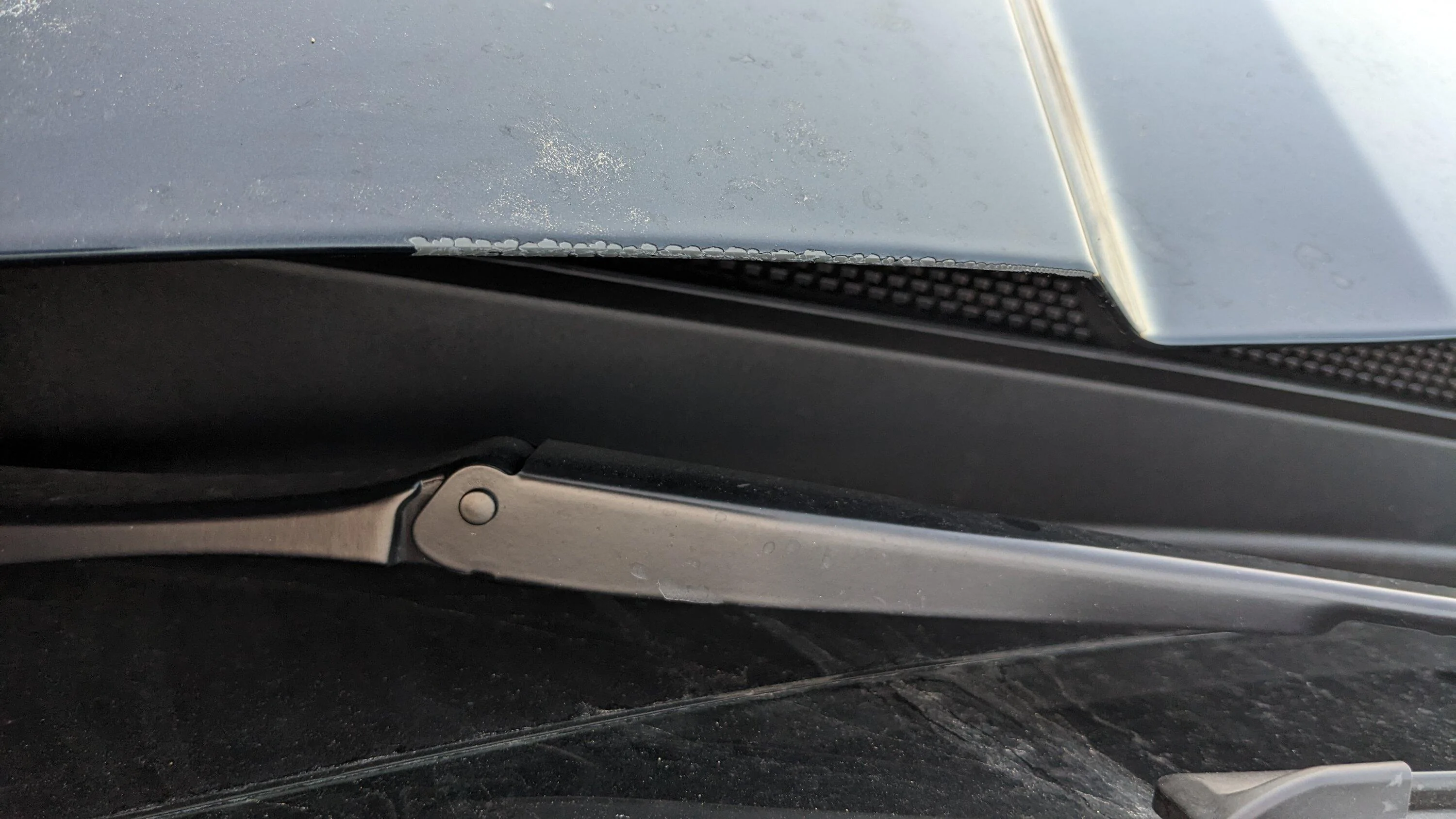

This happened to me, and there is a simple solution to get you back to a factory paint job look and protection.
it was going to snow, so I put the wipers in service mode, stood them up and used ford pass to start the car and defrost the next day. The wipers were on and they smashed the hood edge and scratched it on the way down.
I sanded the edge, cleaned and prepped it, got duplicolor touch up paint and applied two coats. Then applied clear coat twice with the brush applicant. Cover all edges so it doesn’t peel. Only I know it’s there and I can’t see the spot unless I’m really trying.

I bought a primer pen a Alto Blue paint pen and a clear coat pen. Hope and I can at least get it myself. Any recommendations on a fine grit sandpaper?

Correct. If you try to lift the arms up while the wipers are parked, the arms will hit the hood and scratch the paint. Lots of modern cars are this way.
I do miss the ability to lift the arms when hood is down. I like to lift them when washing the car, but can't on my Mav.
