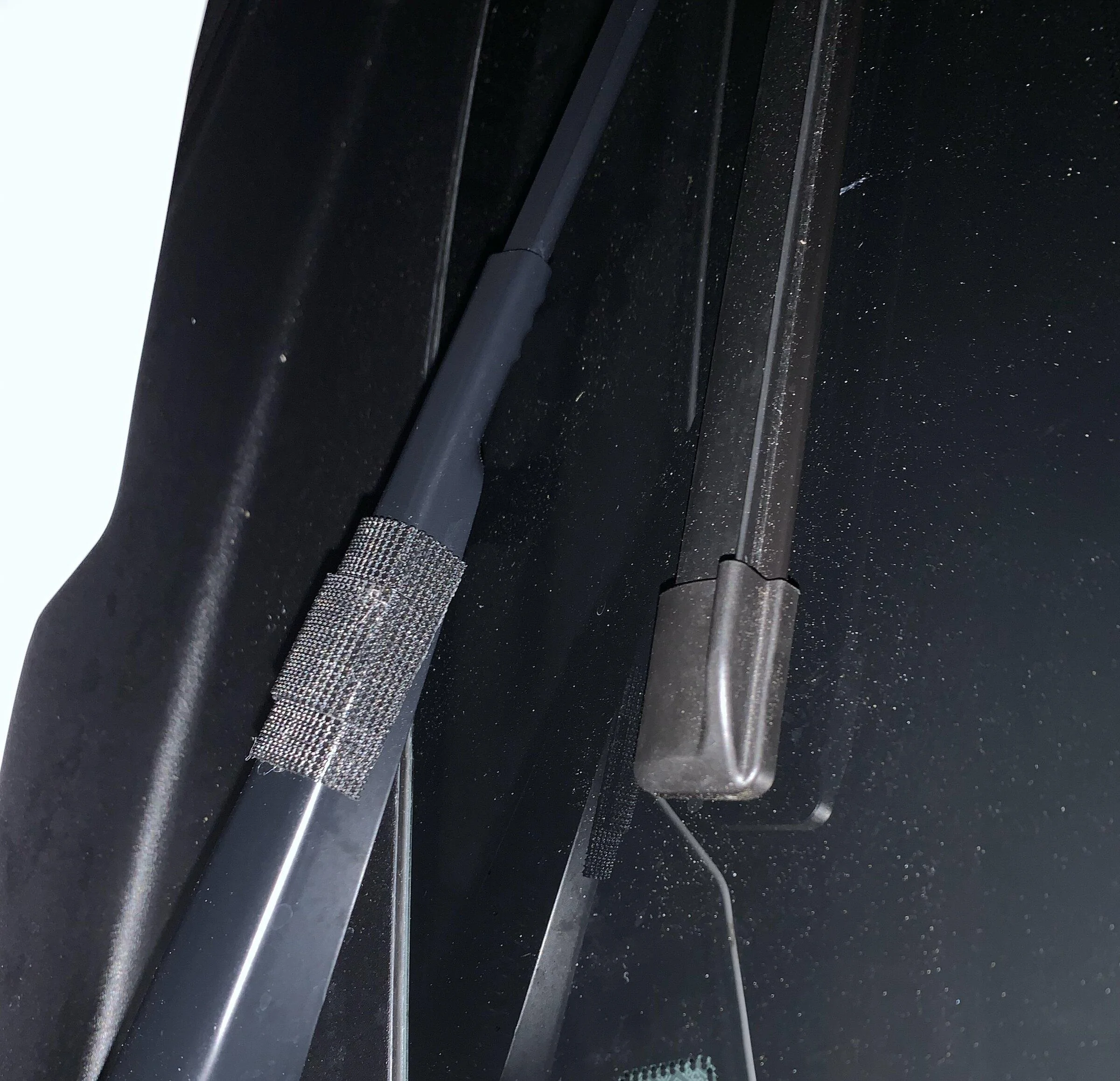

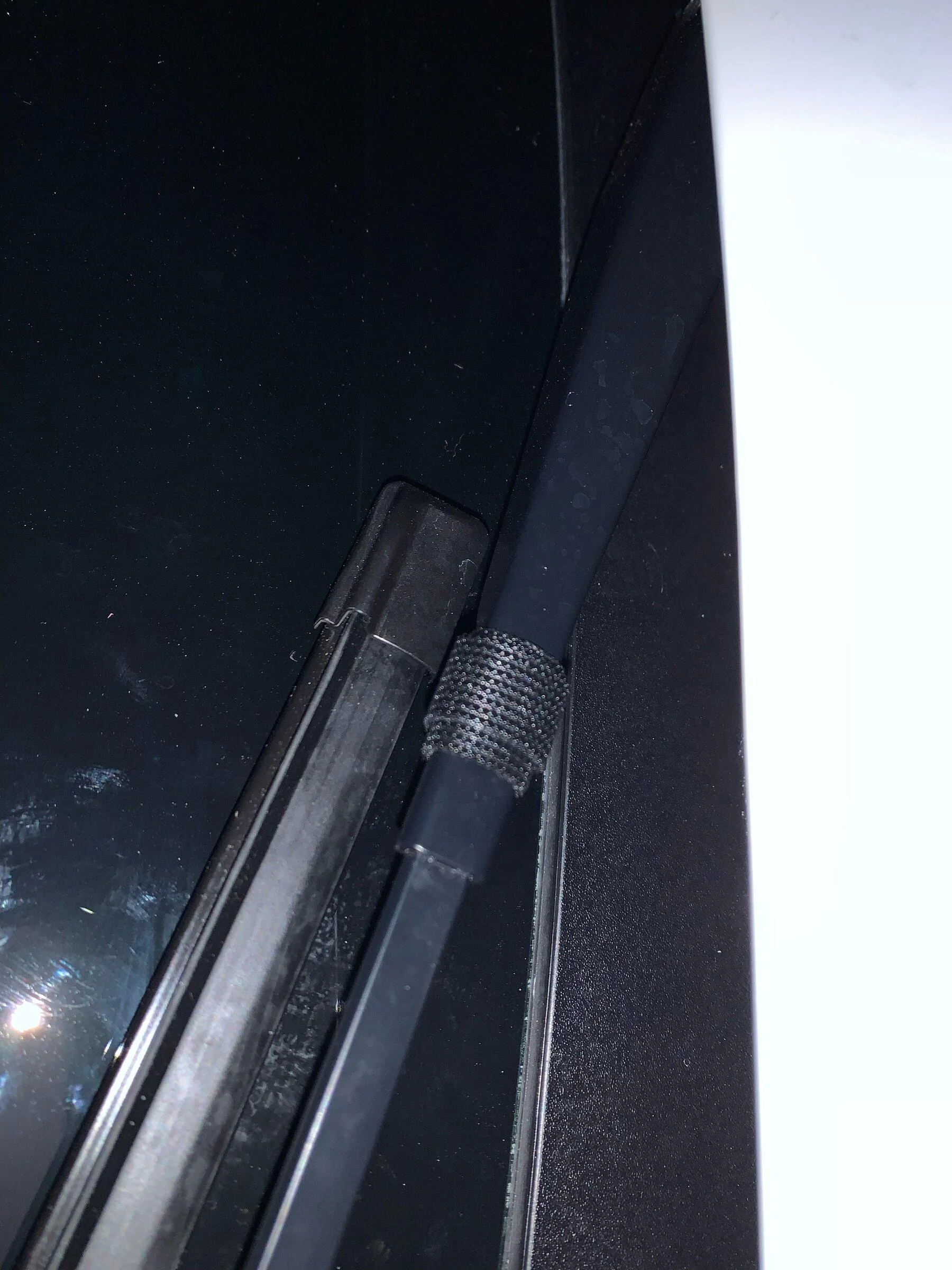

I know I would damage the paint on my car so I went and put some black padding on the wiper blades. You can not see the padding unless you look down in the wiper area. It does cushion the wiper against the paint.
I just used one side of black Velcro.
Ford Maverick Hood paint rubbed off from wiper 8A8314AA-0967-49D4-9116-959B7ECBF939
Ford Maverick Hood paint rubbed off from wiper 93EEDF51-2ABB-4558-B645-1E2371E74224
