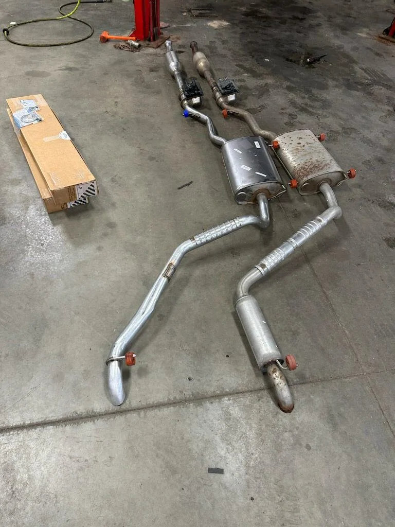

Interesting. My dealer just said the part arrived but was "defective". To define how it was "defective", the dealer sent the pic below, and told us we're back to square 1 and waiting on parts, like you said.
For those who don't see what you do, how is this proof that it is defective?
I don't know. The replacement does look different than what they took out of my Mav, but I'm not a tech. I'm not sure that's the right question anyways. The dealer's tech tried replacing and said the part is defective, and are sending it back to FoMoCo.
How is it defective? Maybe it's an updated exhaust? Did they just look at them side by side and say it looks different so it must be defective?

Doesn’t look like it would line up very well. πŸ˜‚
Maybe they accidentally ordered the part for an eco boost and not a hybrid.
I see what looks like the heat exchanger, so maybe for an Escape
Eh, they're just not lined up exactly the same next to each other. Looks like it should fit just fine unless the modified angles in the middle cause any conflicts.

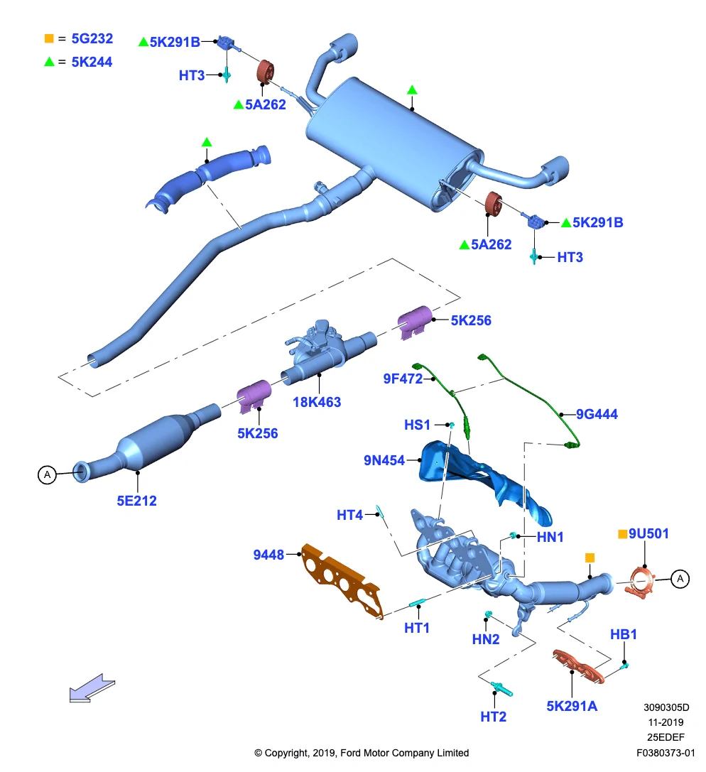

As others have noted, the design is different (primarily the modified heat exchanger and the resonator, plus the angles), but it still should fit just fine.
Further, it's not the Escape FHEV exhaust as that one has a different heat exchanger, different muffler, dual exhaust tips, etc. The one shown above looks like a redesigned Maverick part with no obvious defects...
Ford Maverick Help with P237C code? 1687365527450
https://parts.ford.com/shop/en/us/exhaust-pipe-auxiliary-heater-25l-(gas-electric-hybrid)-p-lx6z18k463g?pdp=y#/sectionId:214673251

Thx to folks for taking a look at the pic and checking.
The dealer didn't say the replacement didn't fit. They said it was "defective". I've not had issues with this dealer's techs in the past and they go above and beyond. One time they didn't charge me for a non-warranty wiring fix. That was for my other truck that's also had a couple of part replacements that went on backorder. If I didn't trust them, I would have asked for more details.
When they have the replacement's replacment to replace it -- say that 5 times fast --, I'll ask for more detail.

both bends at the "S' curve behind the blue hanger isolator appear to be crushed.
I would ask the Dealership what exactly is defective...
