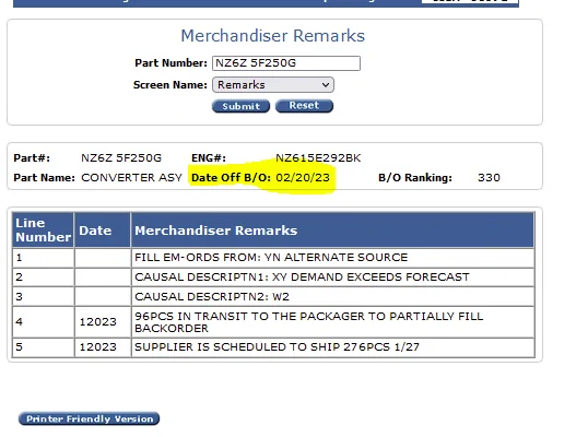

Here's the latest notes on the part availability: SUPPLIER IS SCHEDULED TO SHIP 276PCS 1/27
If that does happen, I think that will take care of all the backorders.

Thanks for the info. Shipping on the 27th might get it to the dealerships by the first week in February. We can hope! 🤞

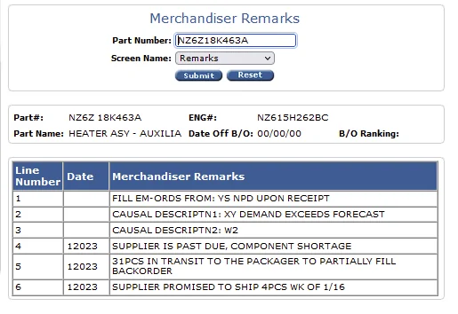

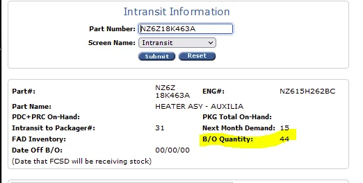

Not to rain on the parade, but it looks like the heat exchanger is now available separate of the exhaust. So which part is ordered?
If it is the exhaust, you might see it at the end of February unless something delays shipping.
Ford Maverick Help with P237C code? 1674275999508
If it is just the heat exchanger, there is not enough to cover back orders.
Ford Maverick Help with P237C code? 1674276278006
Ford Maverick Help with P237C code? 1674276331382
If the heat exchanger is available, that should be ordered. If not, next level assy would work. The date off B/O looks more promising on the exhaust right now.
I wonder if the work shop manual has been updated too?
There may end up being a TSB or SSM that states to replace 18K463 if P237C is present. That is my prediction.
