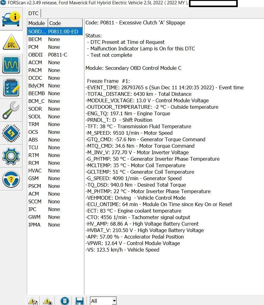

Driving home today and my check engine light came on for the 2nd time since I have owned the truck. The first time was in September and I posted this thread about it https://www.mavericktruckclub.com/forum/threads/4-000km-on-hybrid-and-my-engine-light-came-on.21205/
Since I had already cleared the code from that incident, I decided to just drive the truck and see if it happened again. It did. This time I have FORScan and was able to see it. Since there are a few threads about it already, it appears to be not that uncommon. From the threads I have read, I am not sure that it has been fixed. I see a few where people took it to the dealer and were waiting on parts, dealer couldn't recreate, or just cleared it and played wait and see like I did last time.
I am not sure that there have been many with definitive fixes yet.
Here is what it looks like in FORScan...
