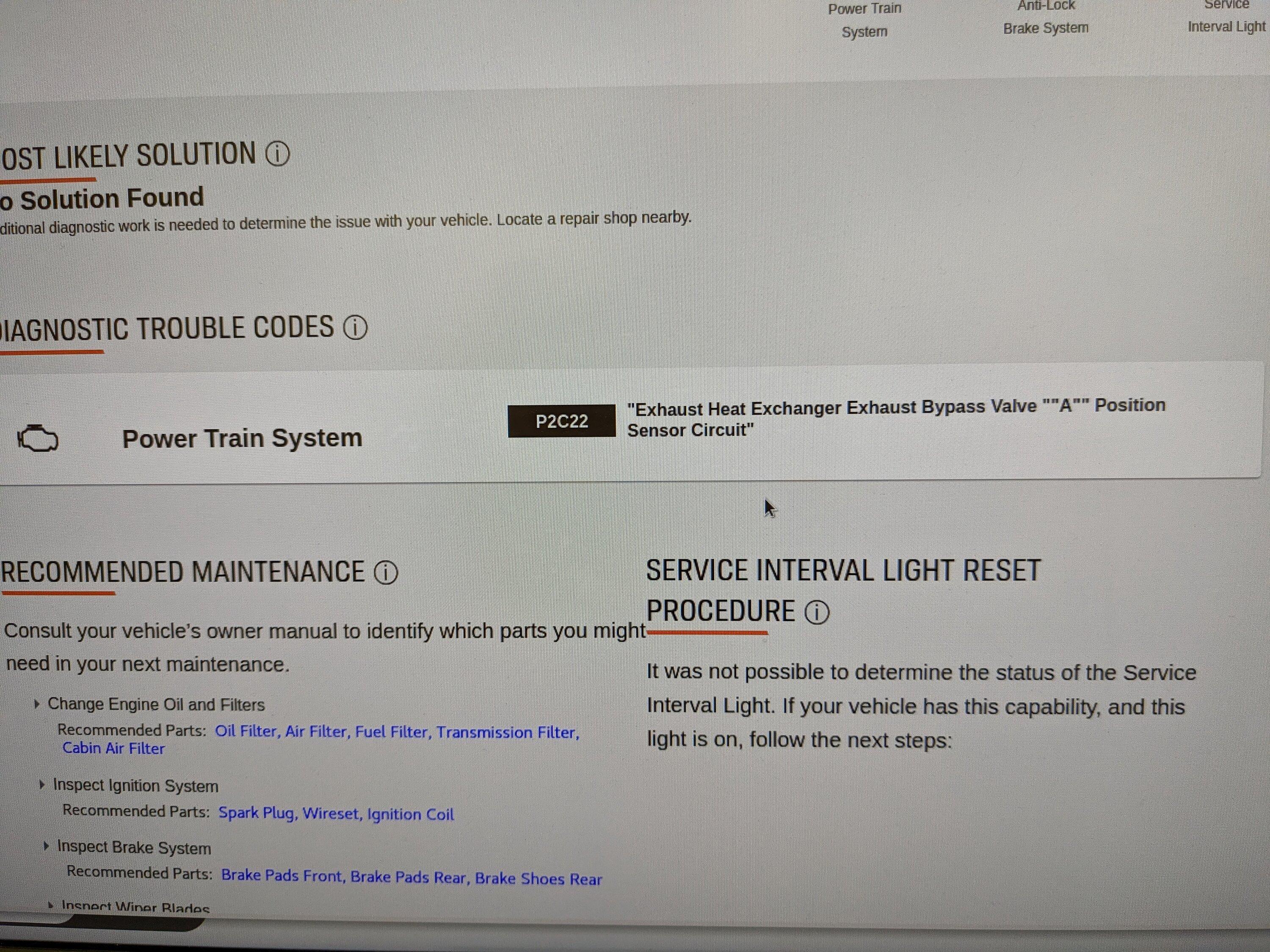

Hybrid XLT 19k miles. I've had the CEL on for a few weeks. No issues driving. Dealer set up a tech appointment for March 3rd. I was told it's ok to drive as long as the light is not flashing. I've just been using the vehicle for light errands. This is the code from Auto Zone. Frustrating to have the light on because I'm obsessive compulsive about stuff like that🤷. Will update when I have more info

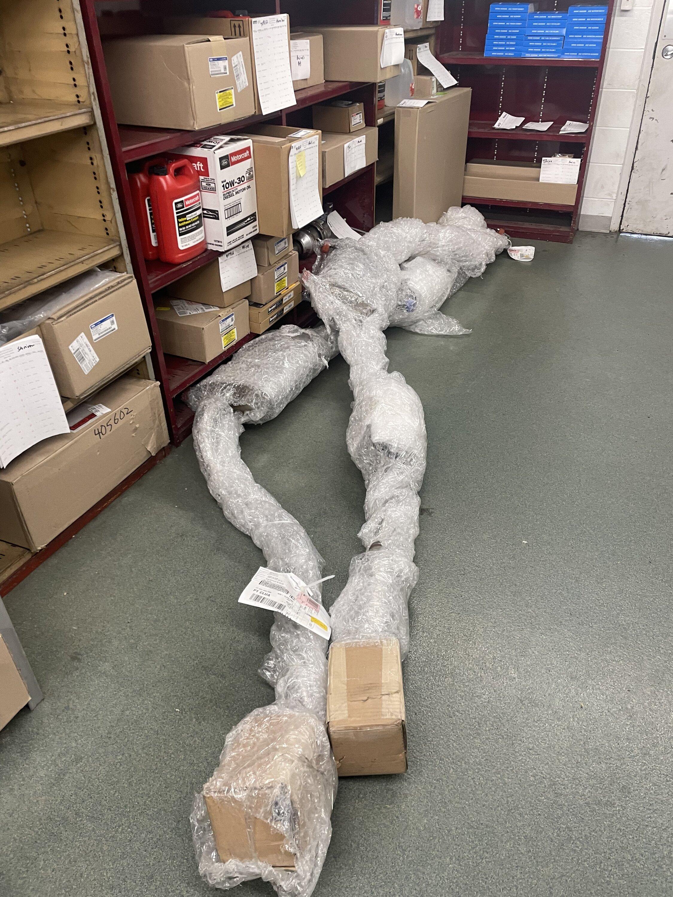

Anyone get the "cat/exhaust" replaced yet for this Code? My dealer has been waiting on the parts since december.
SuperDave71
Sep 19, 2022
238
303
Carthage IN
Ford F-350 CCSB 6.7
Still waiting

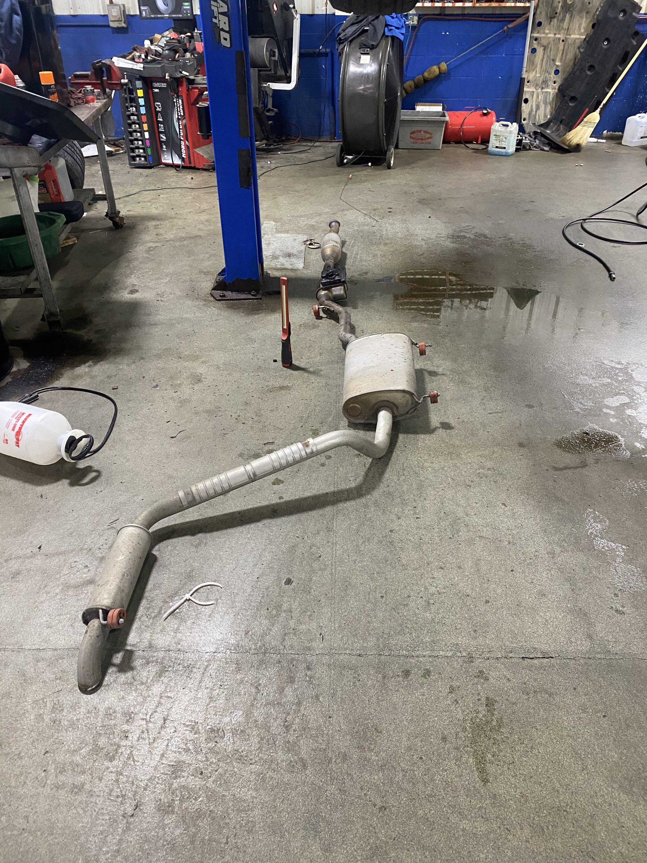

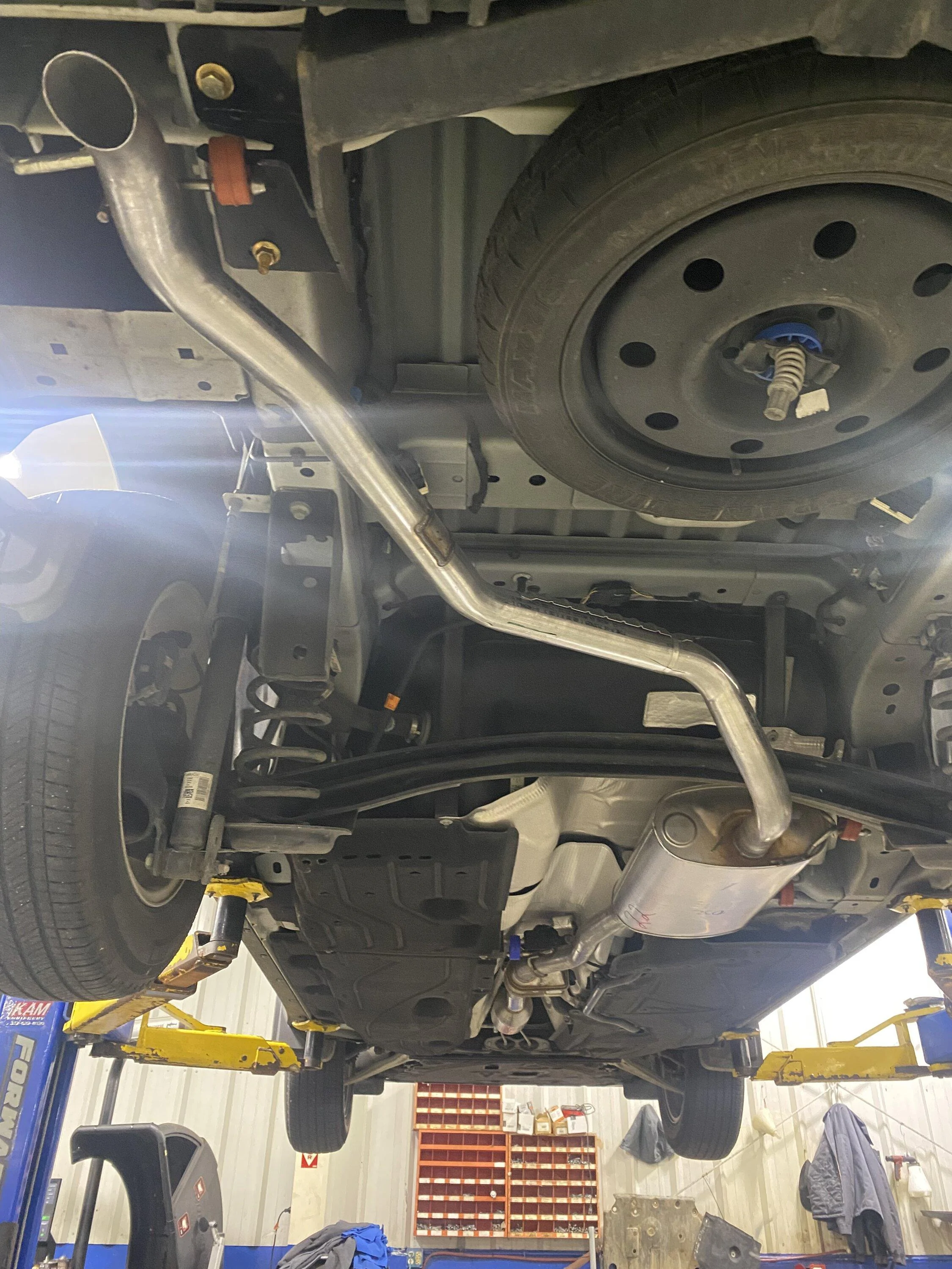

SuperDave71
Sep 19, 2022
238
303
Carthage IN
Ford F-350 CCSB 6.7
The new one does not have the resonator at the tailpipe. (Old one on the ground for comparison)
Ford Maverick Help with P237C code? 393D9108-1D7A-461E-9A7E-5F8125B808F8
Ford Maverick Help with P237C code? 0D8D9B4B-4408-48B1-A644-53AD5E307D1A
Darnon
Jul 4, 2021
5,766
7,311
WNY
All Mavericks after around September '22 are like that. Ford switched to that metal mesh patch which functions similar to a resonator.
Yes, this is normal. On both EcoBoost and Hybrids the resonator (used to be just before the tailpipe on early builds) was deleted in favor of the resonance patch seen here. All Mavericks going forward are built this way.
