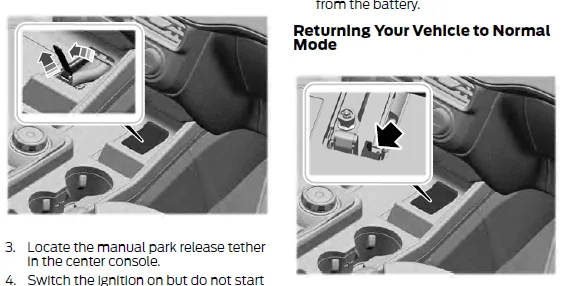

Look up the maverick manual, page 186. Red pull loop under plastic plate. Above cup holders.

From Owner's Manual - Pages 186/187:
USING "MANUAL PARK RELEASE"
Activating the manual Park Release Cable
  1. Apply the Parking Brake. See Electric Parking Brake (Page 194). NOTE: If the battery is dead, for example, no electrical power available, you could need an external power source to apply the parking brake.
  2. Remove the access cover with a tool or key by prying the panel in the upper corner.
  3. Locate the manual park release tether in the center console.
  4. Switch the ignition on but do not start your vehicle. NOTE: do not activate the manual park release with the engine started.
  5. Once in the drivers seat, fully apply the brake pedal and hold. Do not release. Pull the tether strap rearward until engaged. If done correctly, a message appears in the instrument cluster. NOTE: There is an audible click when you pull the tether back in the locked position.
  6. With your foot still fully applied on the brake pedal, disengage the parking brake. See Electric Parking Brake (Page 194). ---> **NOTE: Your vehicle is now out of the "Park" (P) position and is free to roll** <---
  7. Your vehicle remains in "Neutral" (N) for emergency towing purposes.

Thank you!
