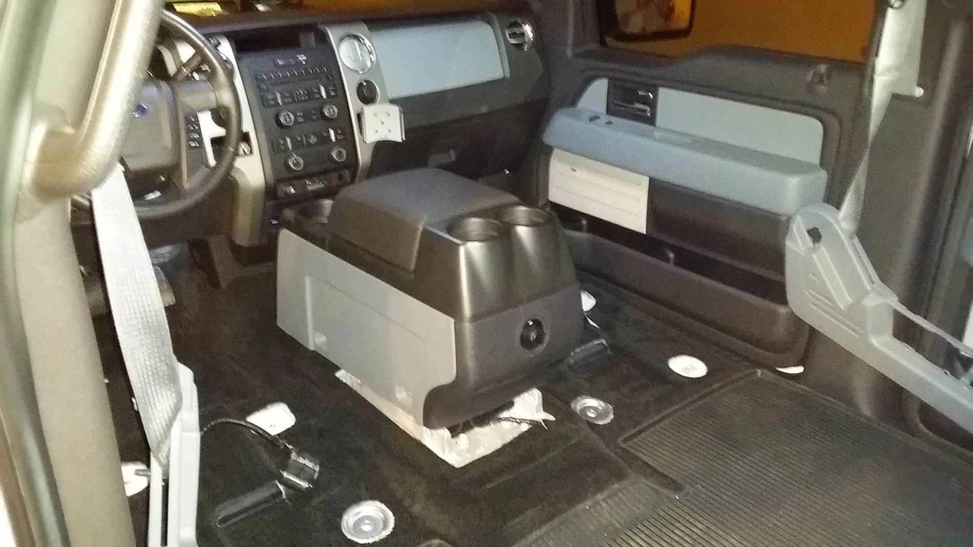

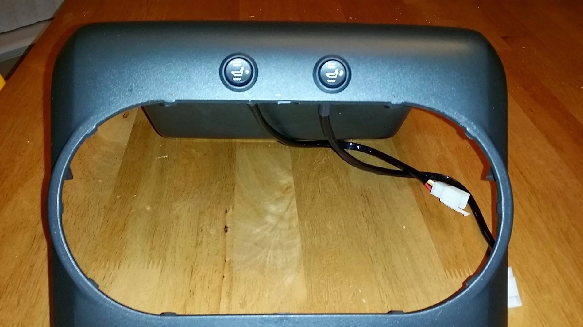

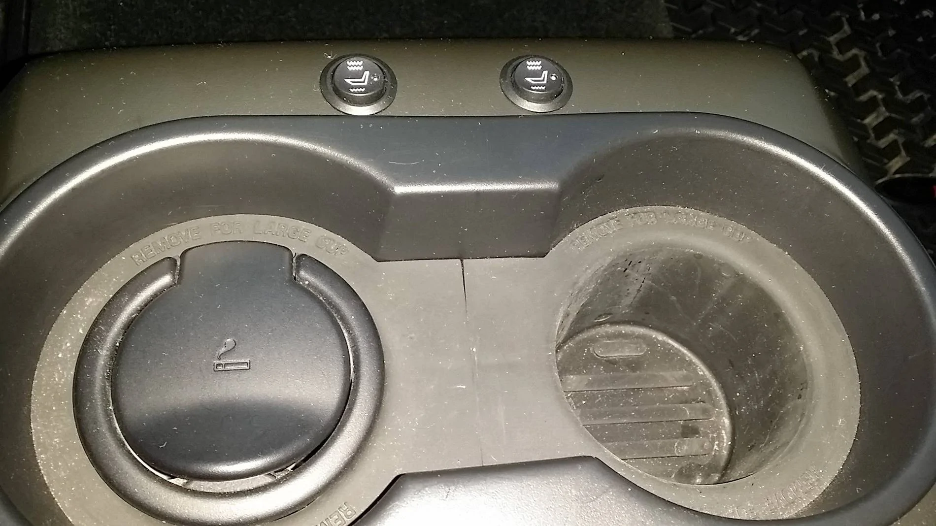

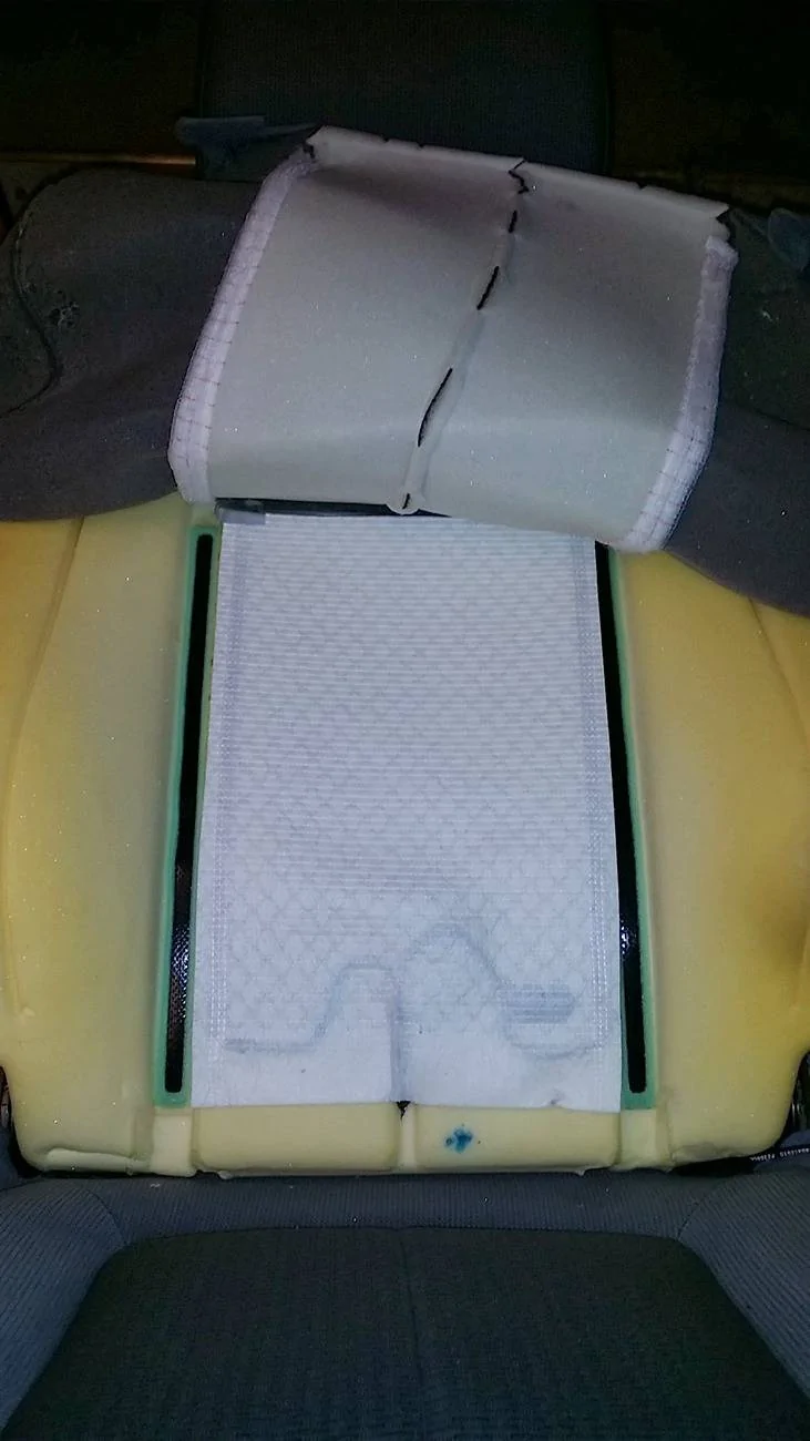

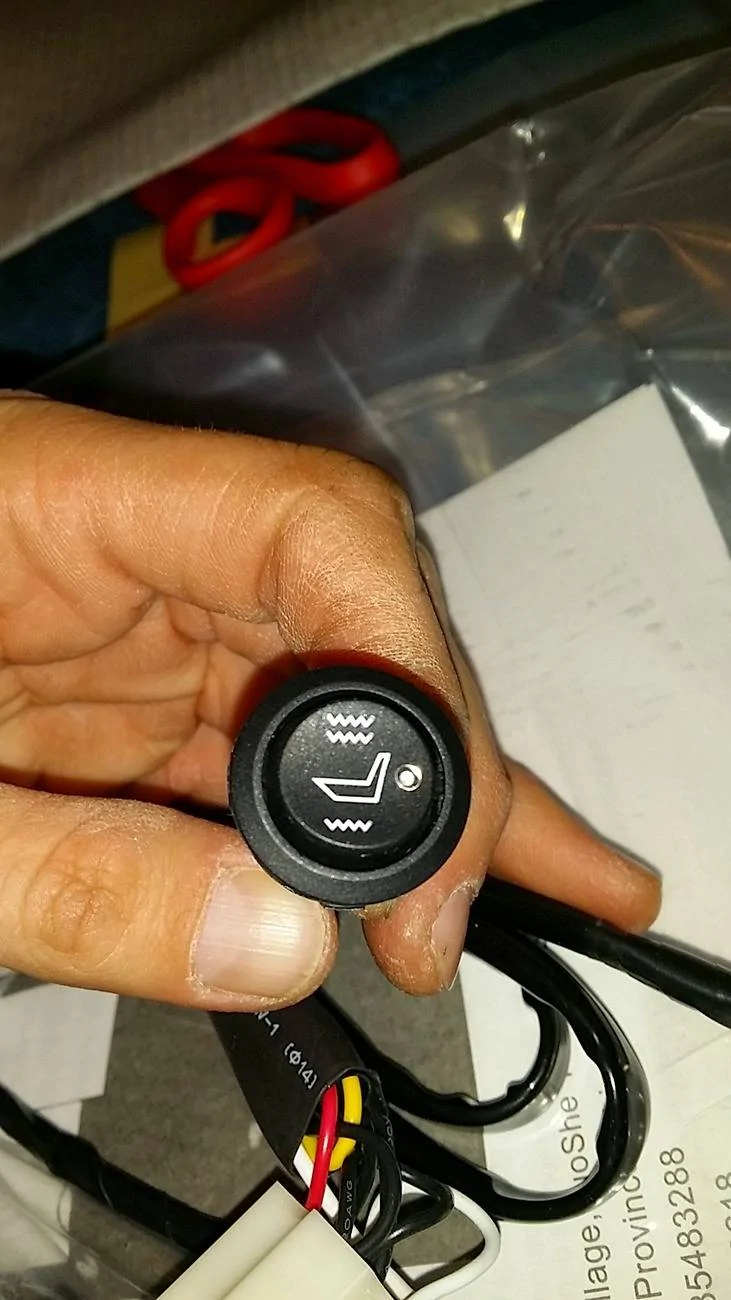

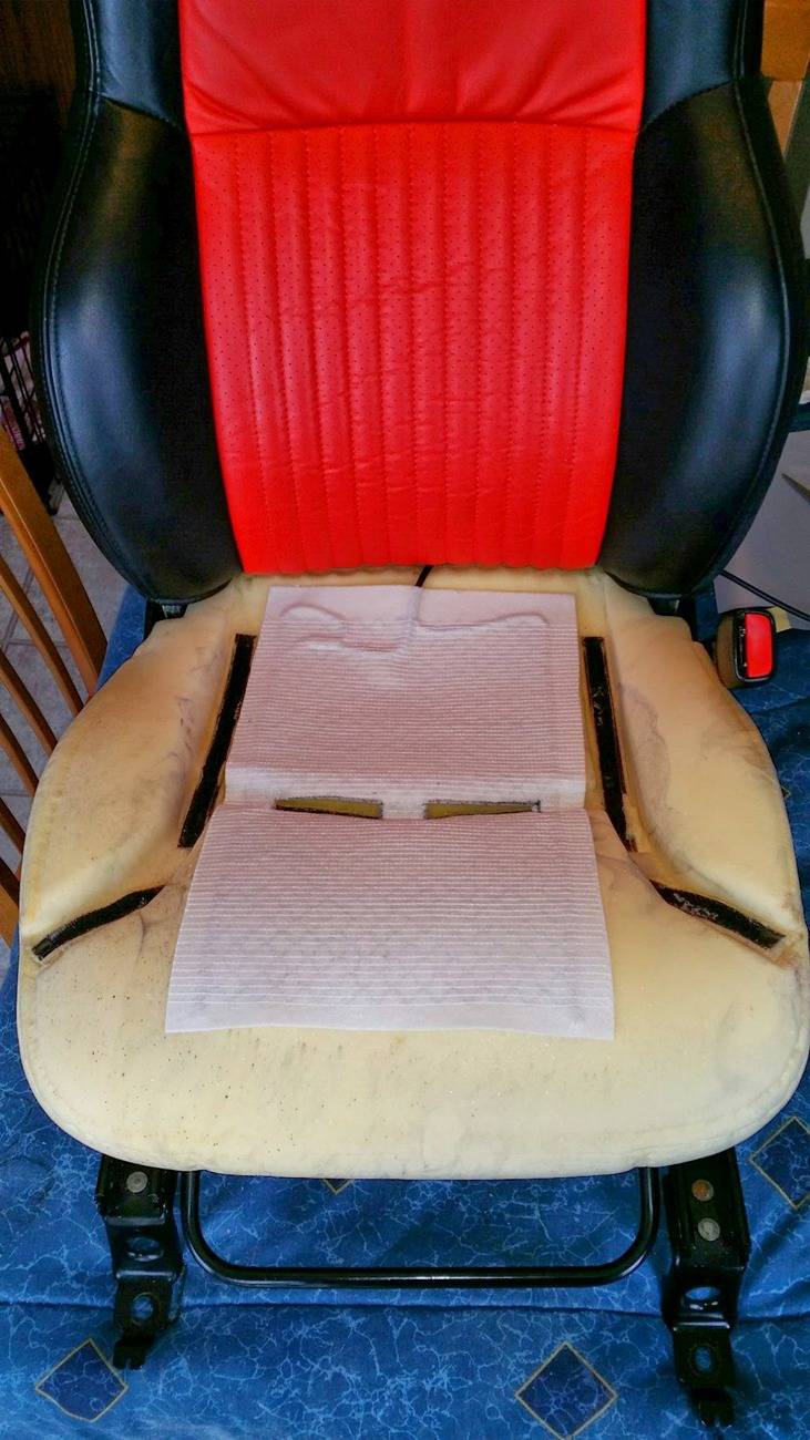

They're worth it, if you were close I'd help you install them they're fairly simple. After having them in almost every vehicle except my 12 F-150 XLT I'll never order another vehicle without getting them.
When I installed them in my 12 F-150 XLT I tapped the OEM heated seat circuit, and when I would remote start the truck they would come on with remote start even though they were manual switches, The heated seat circuit turned off with the key and on with the key which was great. So you didn't have to worry about draining the battery, I don't know if you'd be able to install them the same way on the Maverick, that would be great though something to check when you do your install.
In my opinion GM does it best where you've got one button to turn on both the butt and back heater or a separate button to do just the back and it's three levels of heating.

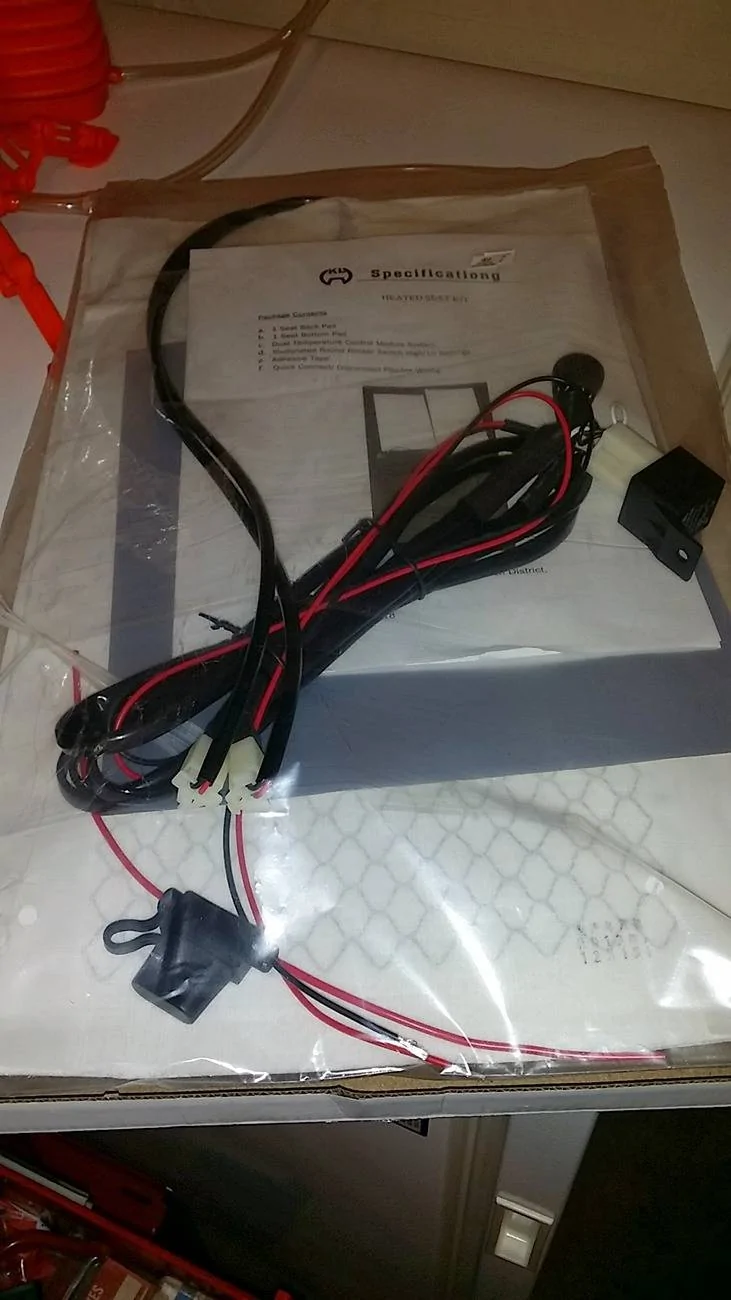

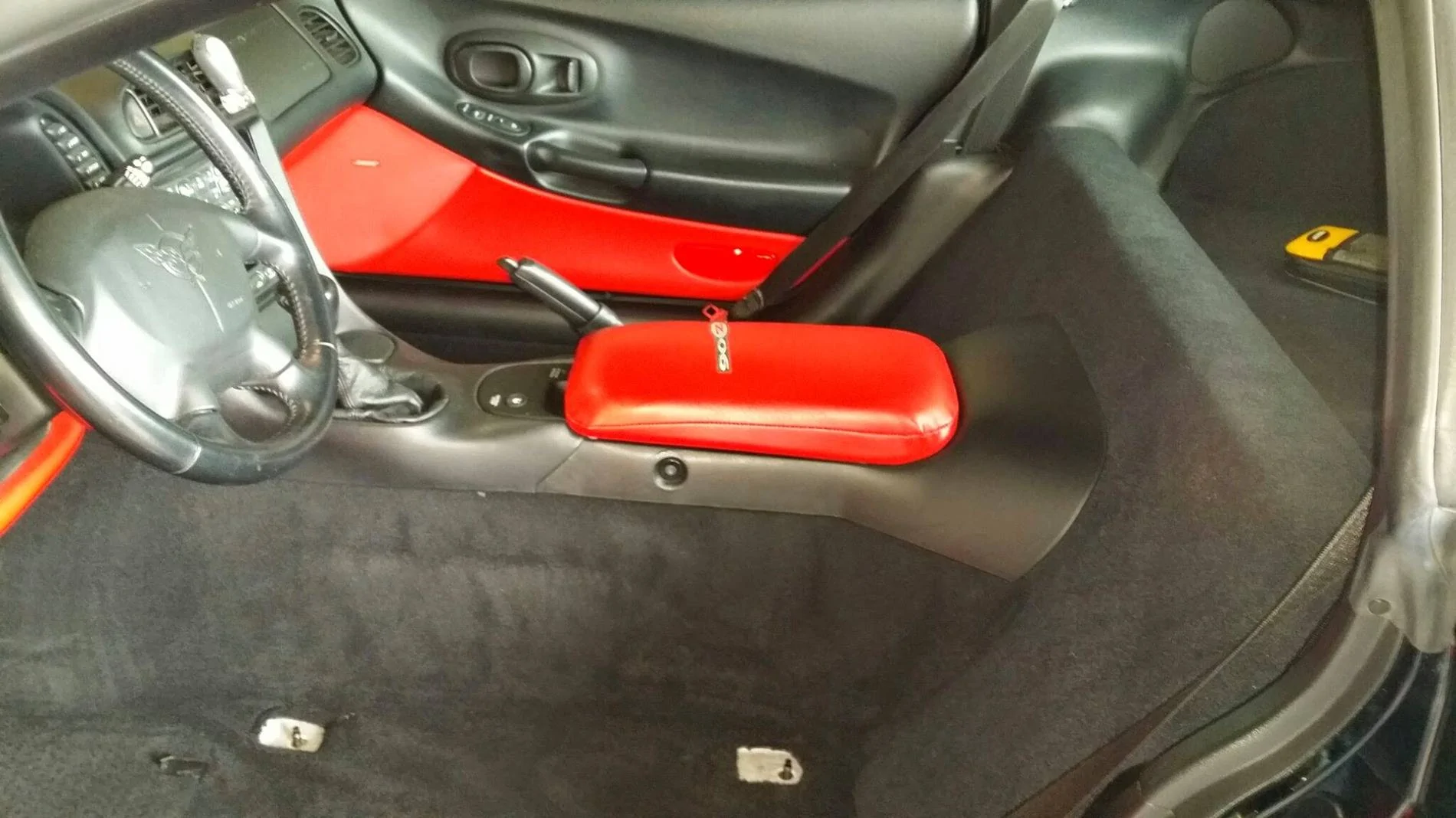

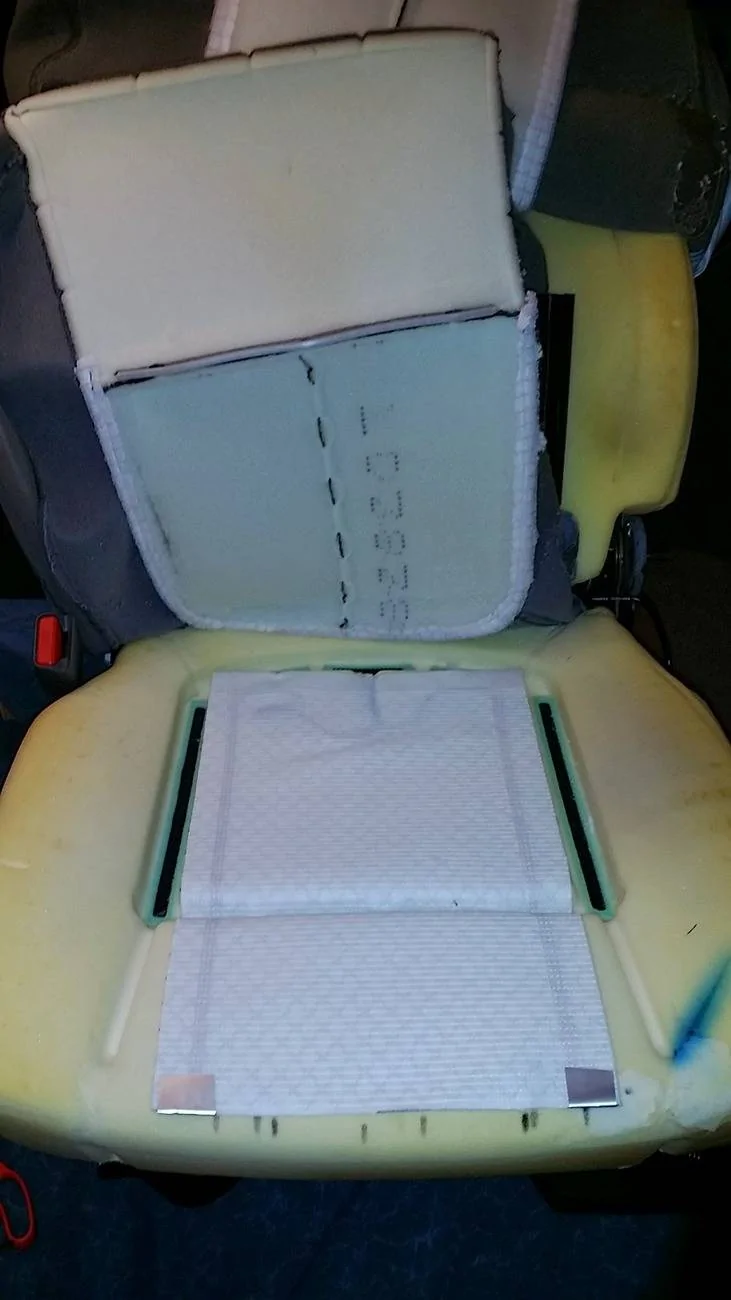

I put the aftermarket heated seat insert kit switches in my 2012 F-150 XLT, My dad's O2 Corvette ZO6 and my wife's 2016 Ford fusion SE all when purchased new.. Each time I removed the seats from the vehicle and put them on a fold-out table I use in the garage made it much easier doing the install versus in the vehicle. This made it easier to run the wiring under the carpets and to the fuse panel in the passenger footwells then reinstall the seats and connect the wiring harness to the heated seats.
The F-150 was the worst as the seats were heavy as hell, the Corvette be in the easiest as the seats were light as a feather, especially compared to the f-150s.
