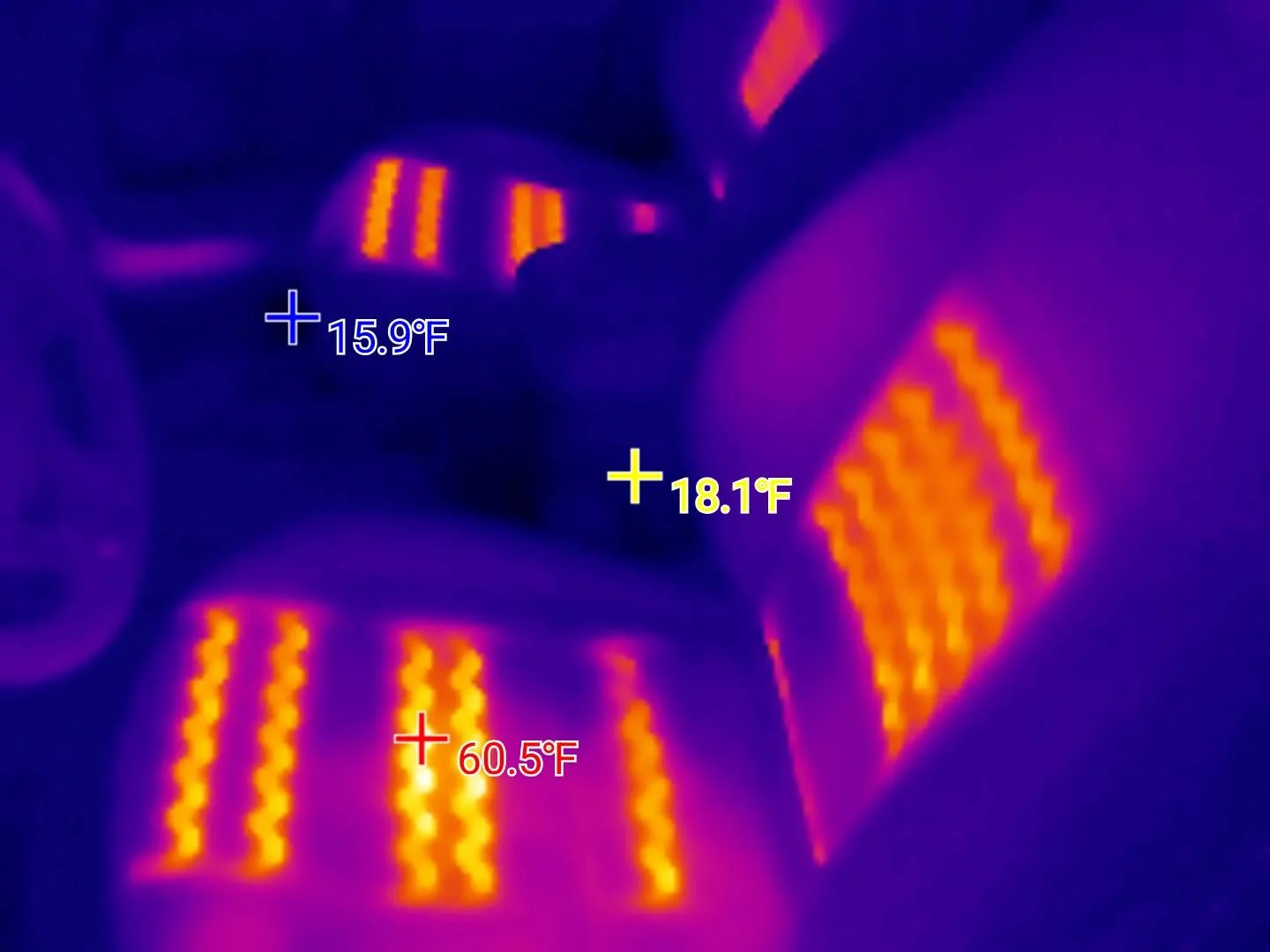

Total time for the installation was about 5 1/2 hours. I chipped away at it over the past couple months. The seat bottoms took about an hour each and the backs took about 1 1/2 hours. Running the wiring from the seats to the fuses took 1/2 hour. The rest of the time was figuring out hour to tap into power and location of the switches. I hope these pictures are clear.

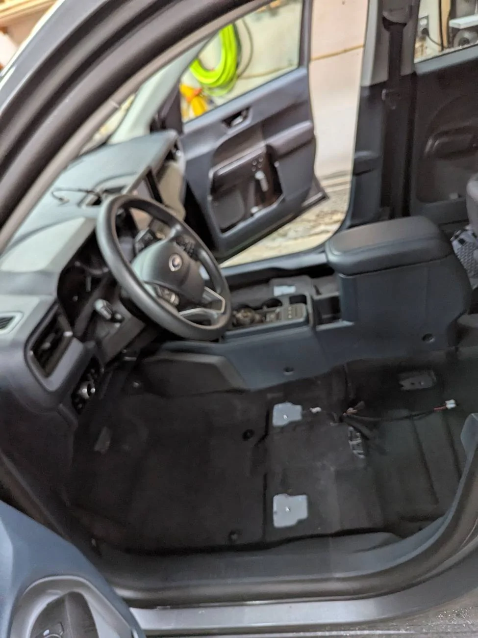

the wires were easy enough to tuck under both sides of the center console to run to the fuse panel on the passenger side footboard. I found a ground on the right side when removed the glove compartment:
then the power, I found these 2 10 amp fuses that are only on with the truck or accessories.

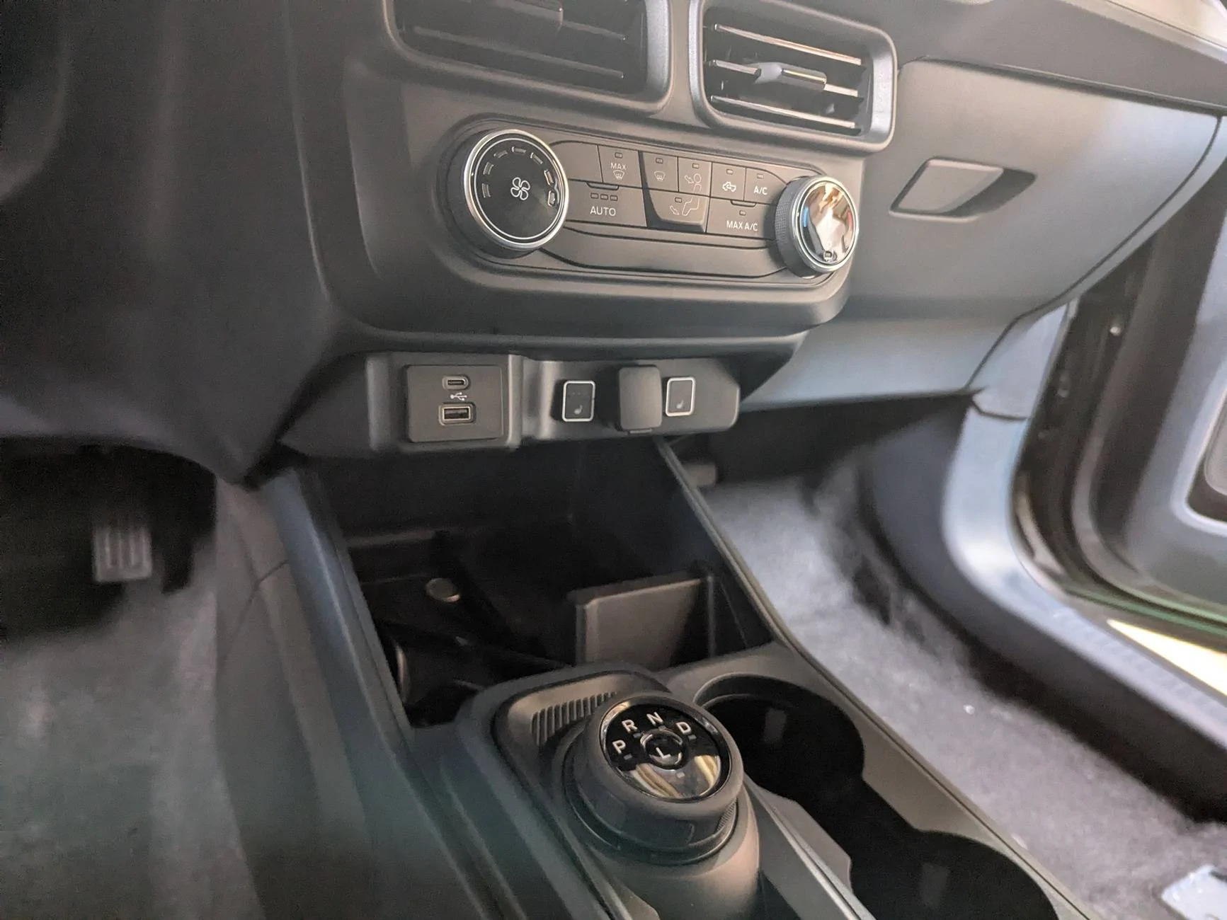

When using the pigtail, you must determine which side of the fuse is the power side. There are plenty of tutorials online. Then it was on to the switches, I chose the lower panel on either side of the 12 volt outlet. I think they fit well.

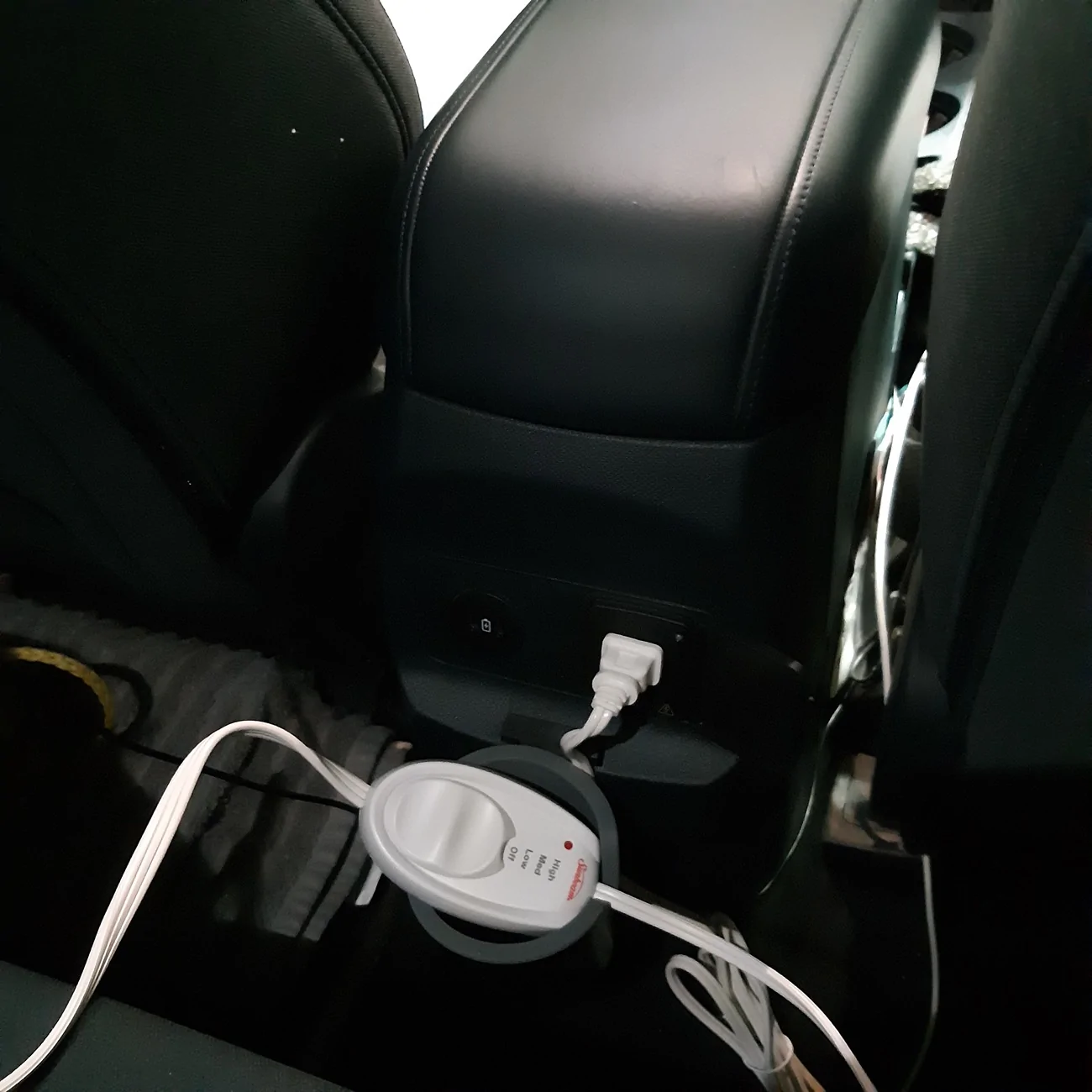

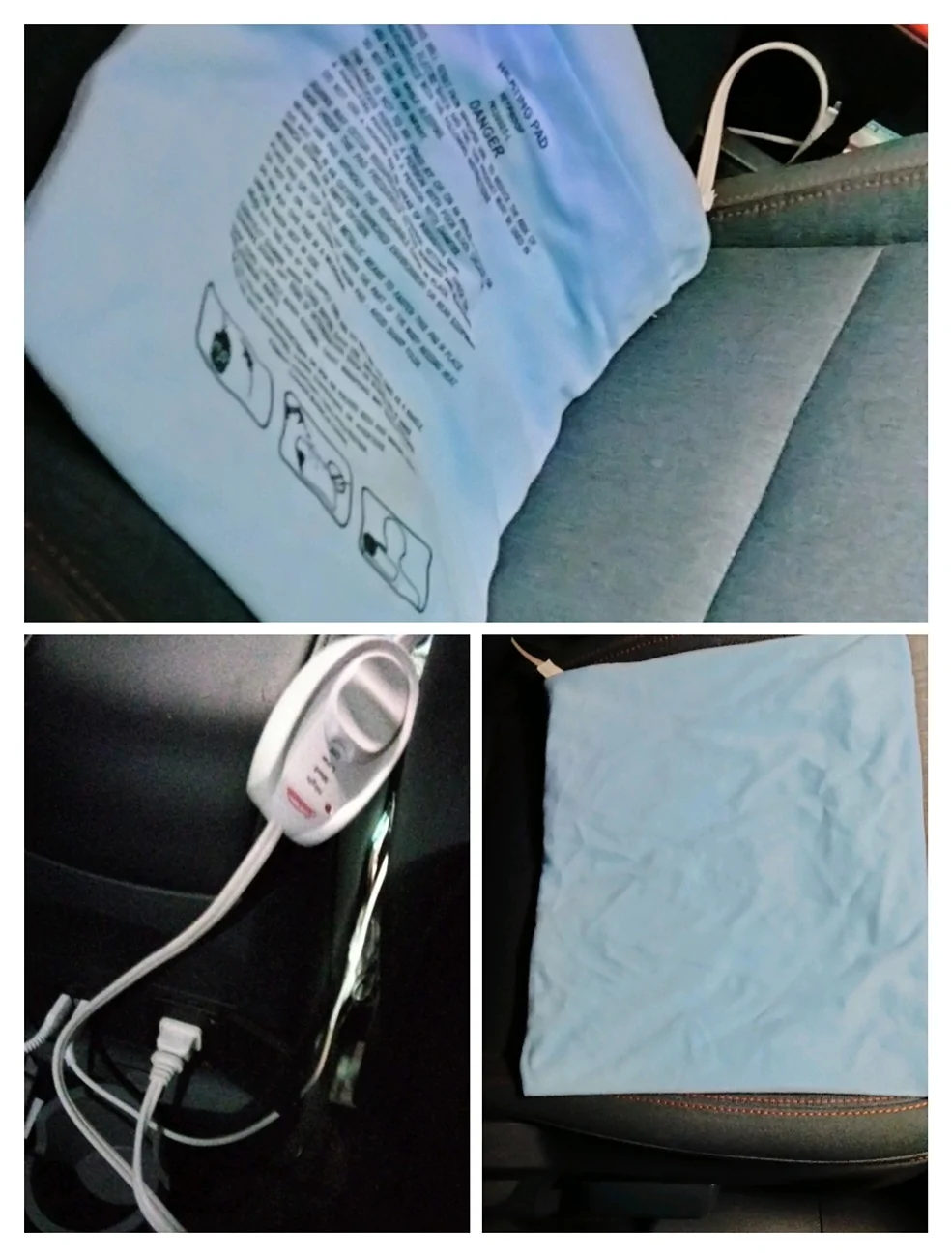

If you don't have the funds, skills or time to tear apart the seat and install a factory system.
Plug in a heating pad.
Redneck as hell, but it is simple, cheap and fast for heat in the cold winter.
The Mavericks 120 inverter can easily support this.
I use that one to preheat the dog🐕 bed in the backseat..The controller fits in the Mabett rear cup holder.
The Mavericks 120 inverter can easily support this. Use one to preheat the dogs bed in the backseat.
That is hilariously ingenious!!! Never thought of that solution!!
I've been using smaller Sunbeam pad in the front seat for my legs.
Was going to use a longer heating pad for my back last week but it wouldn't run off the inverter.
Folks often overlook the simplest solutions.
I'm really surprised that the Mavericks 400 W inverter would not power a large heating pad.
I looked up the specs of a few large heating pads.
Most are right around 60 watts for a large heating pad. 🤷‍♂️
Maybe try a different brand, they're fairly inexpensive.
I do have the older type pad like your photo that doesn’t have electronics in it. Watts isn’t the problem since a 300W pure sine wave I have can power two of my larger pads.
