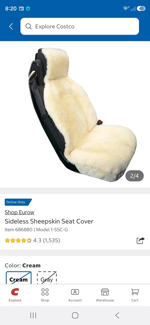

Ford Maverick Seat covers on a heated seat. 2952
Got these at Costco online $90. Out of stock right now. On in the summer of in the winter. Game changer.
