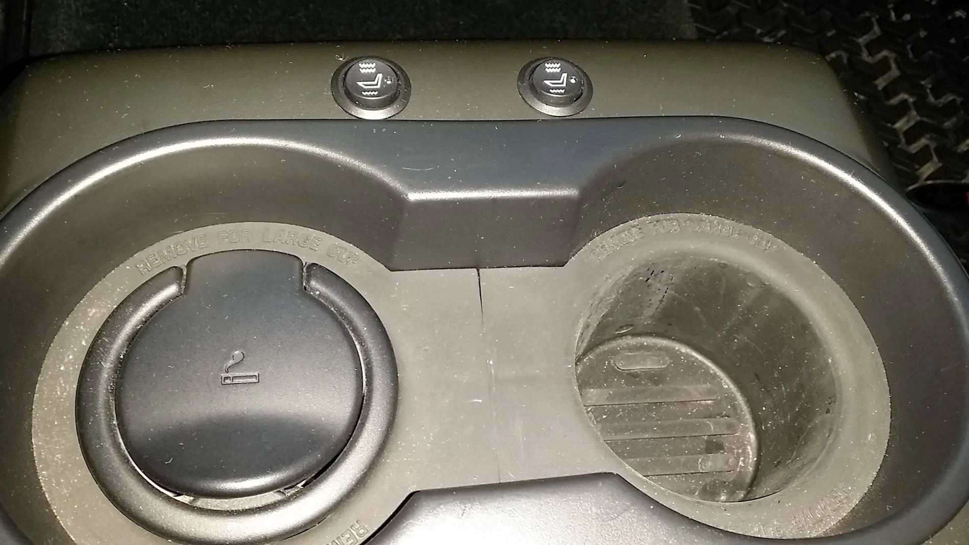

great install. Thanks for the idea. I thought of doing this as well but though the center console would be a good spot.

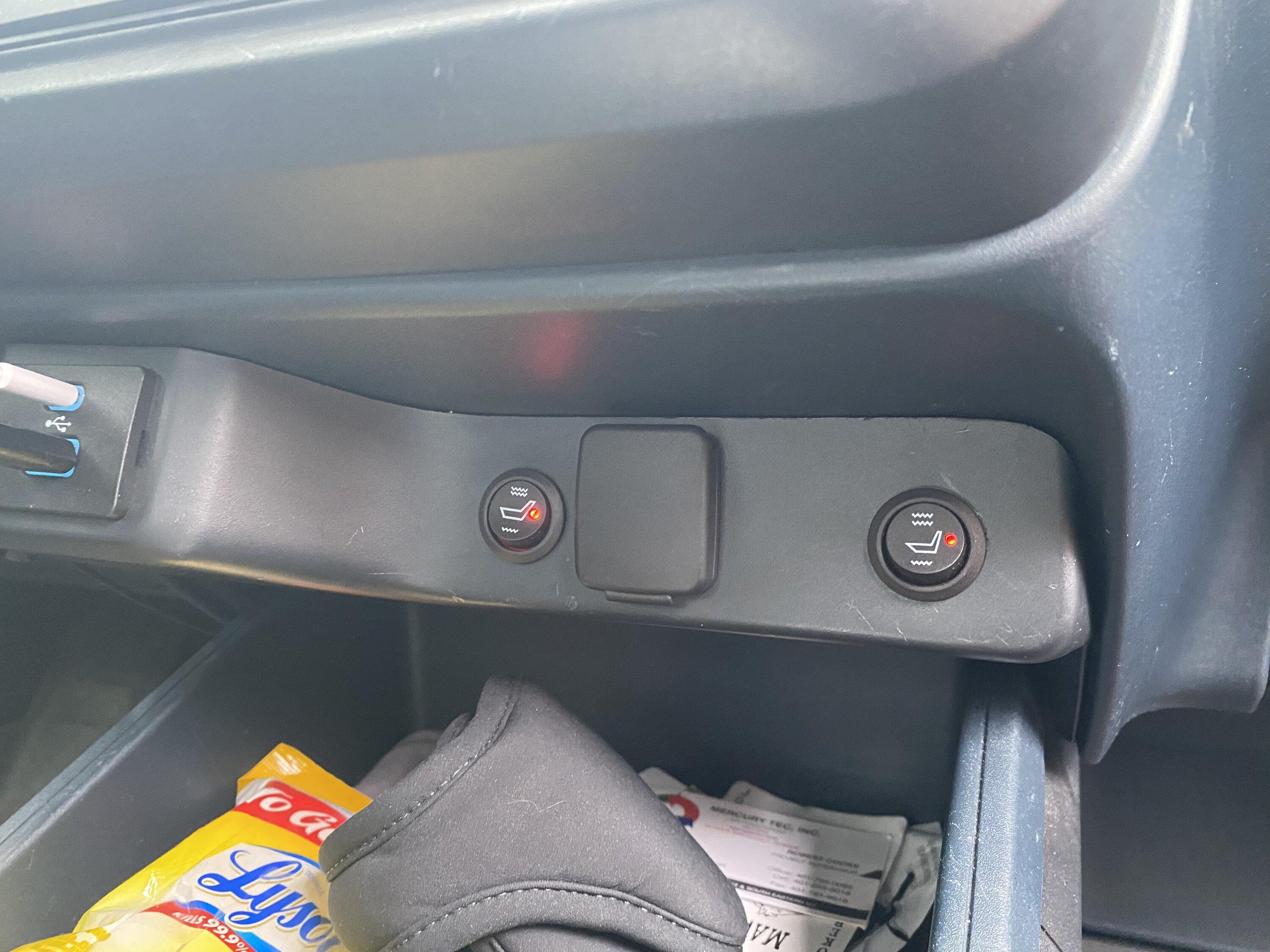

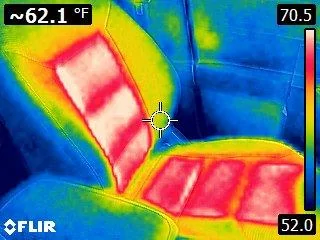

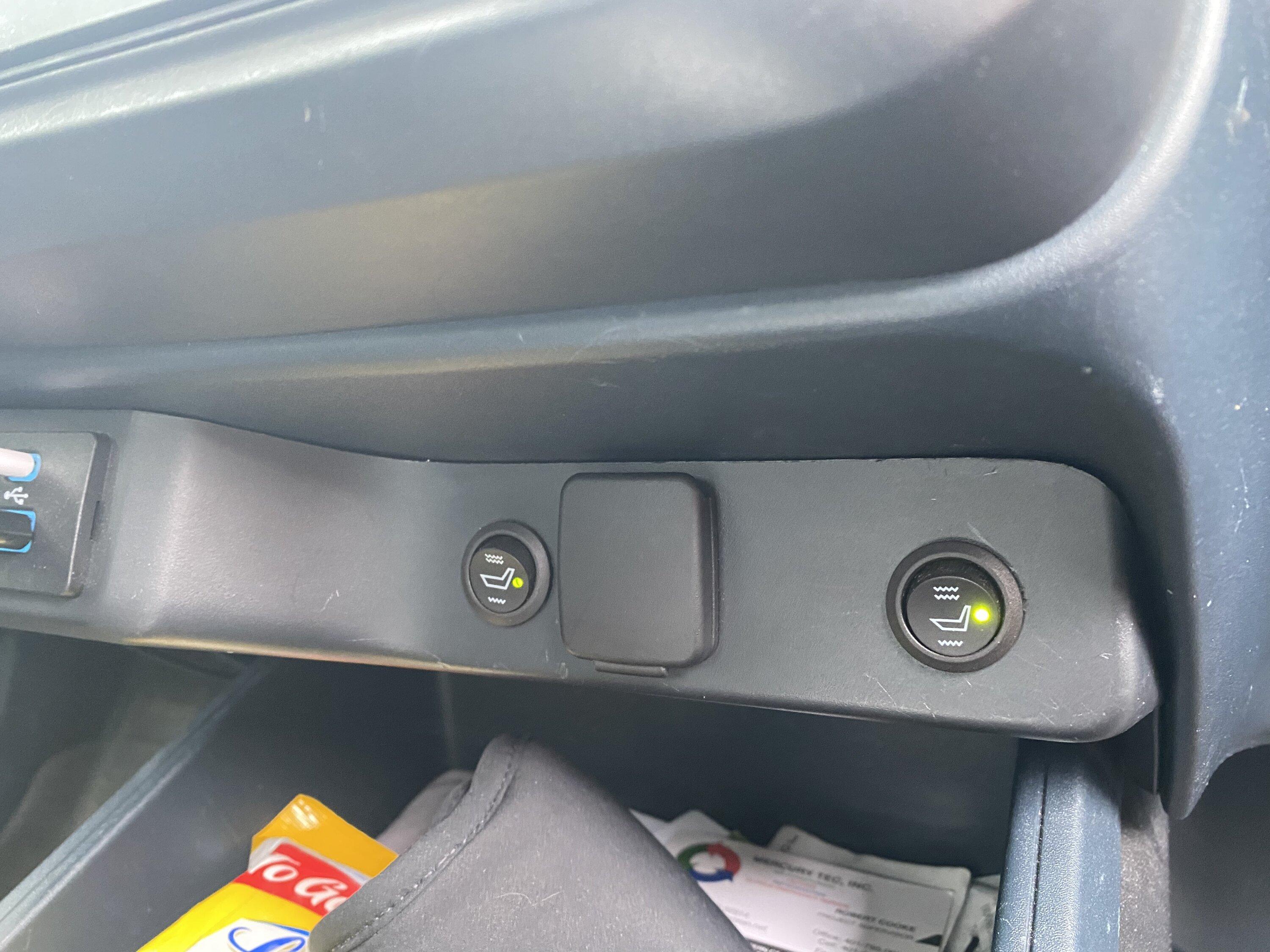

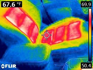

A few more pics:
green light is low heat, red light is high heat

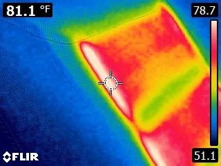

I have access to an IR camera:
it got much hotter when sitting in it!

Great! Only one issue, although, not enough of an issue for me to change the switches. The switches show a red light when on high and a green light whom low. The passenger side lost the green light, it glows red on both low and high. It didn’t change the pad temperature. From what I can tell, just the light, again, not enough to make a change.

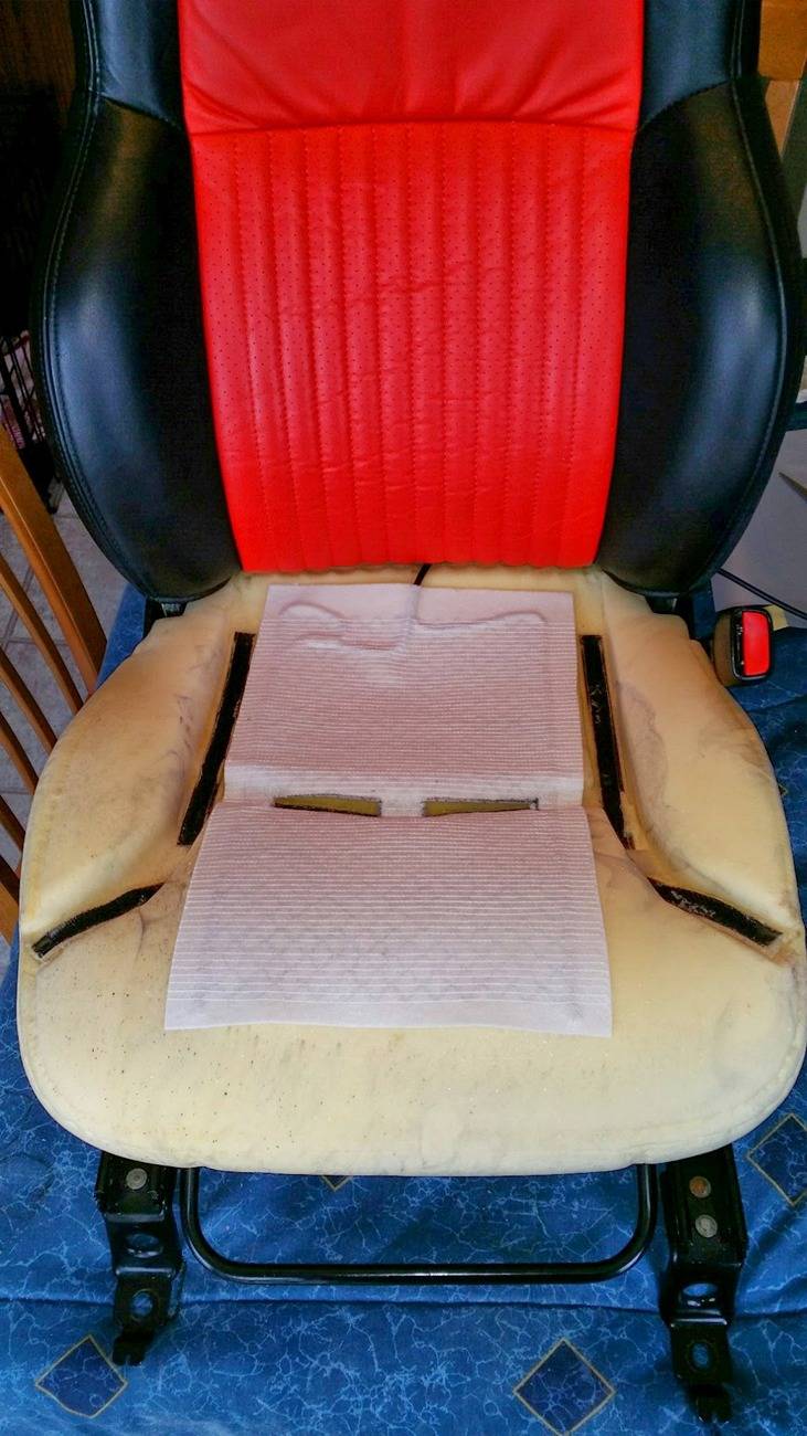

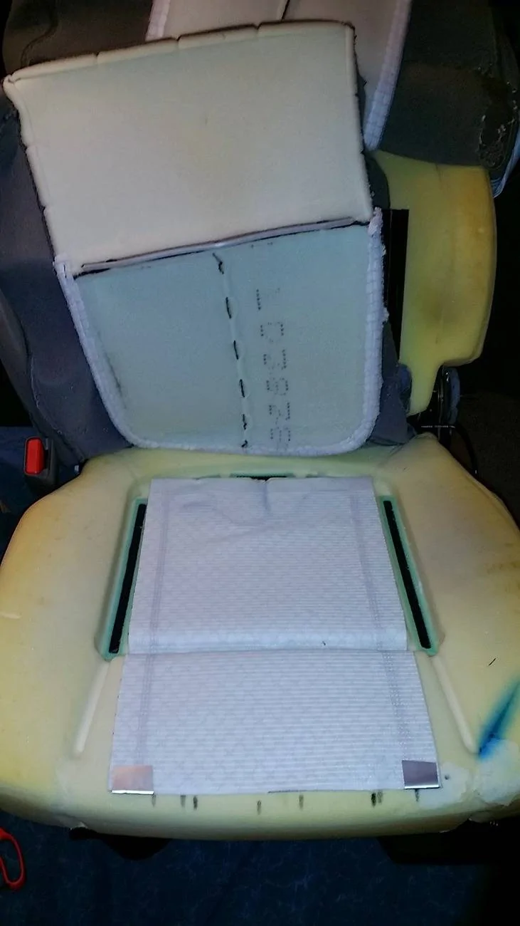

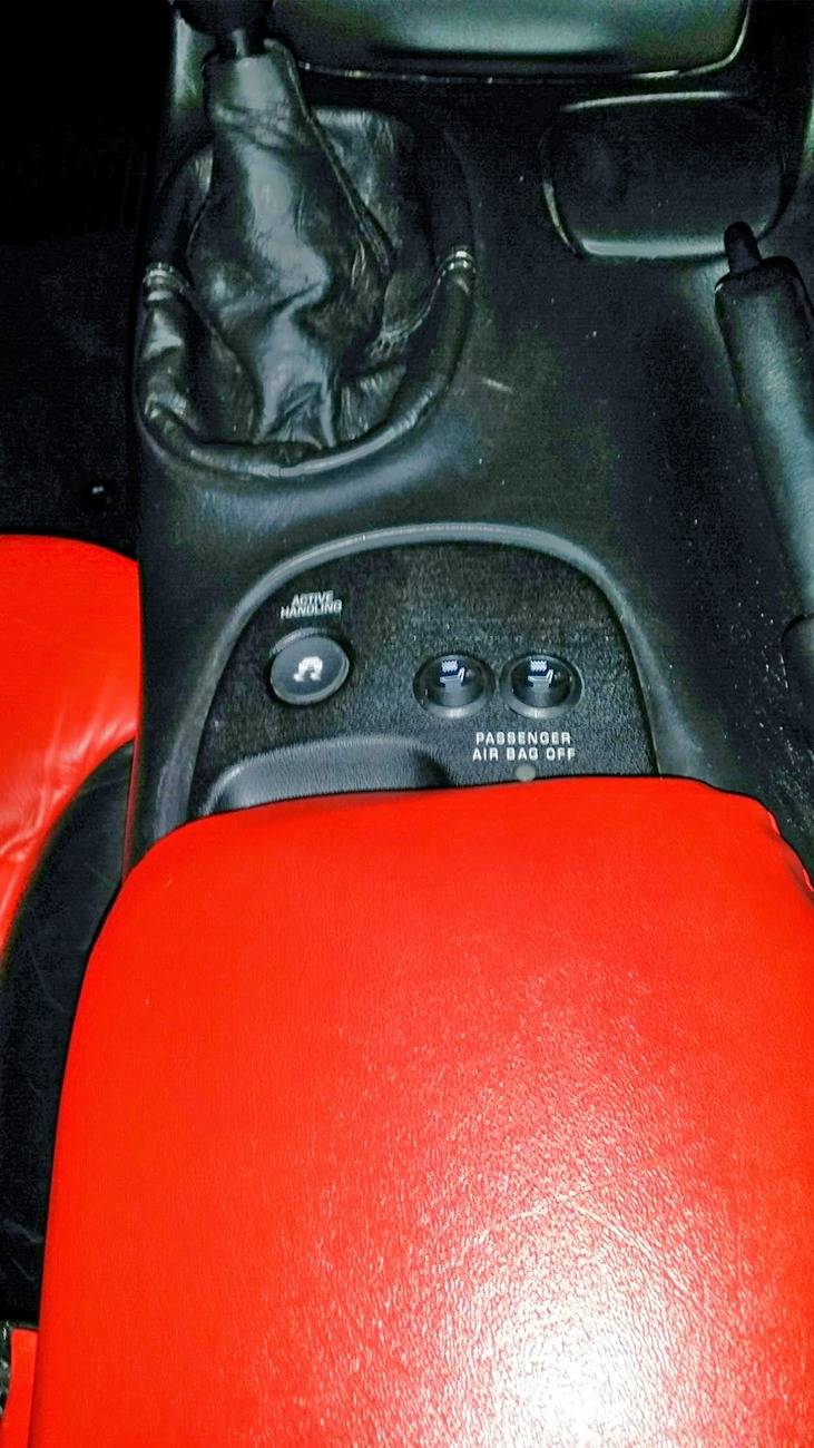

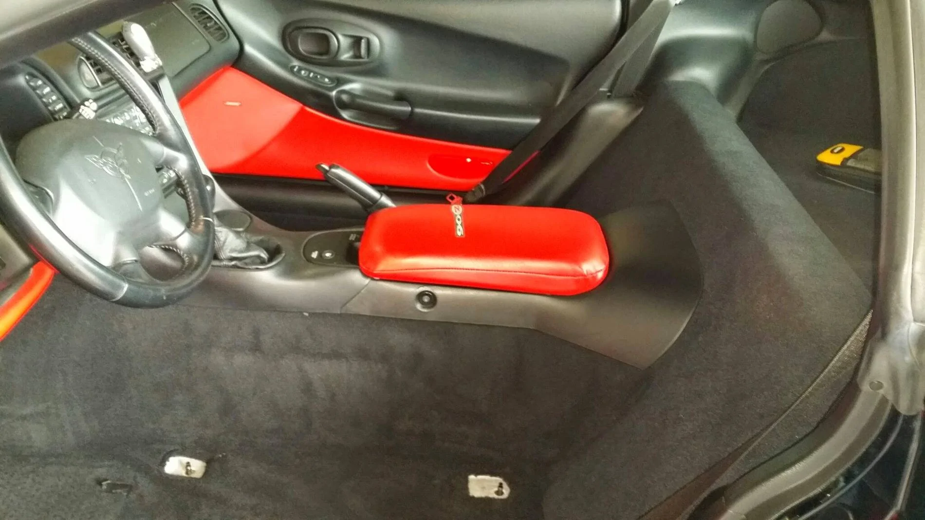

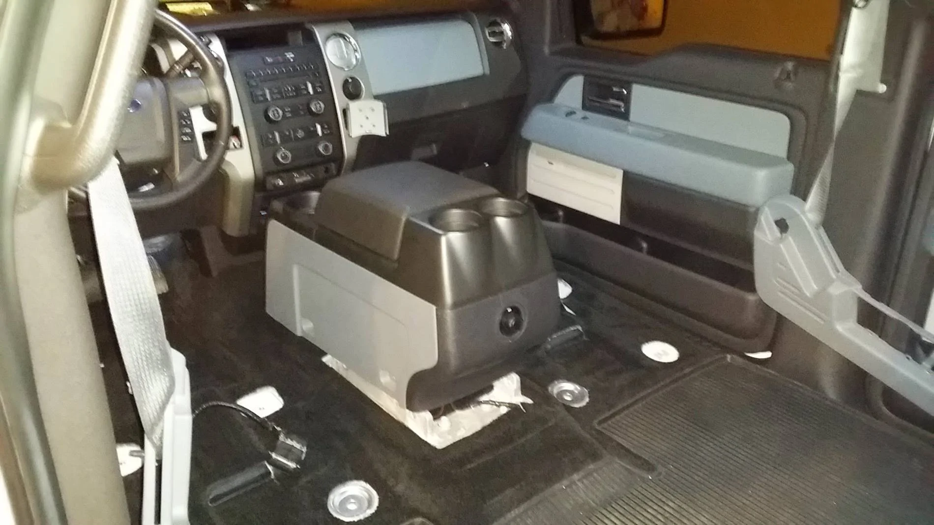

I've installed that same kit in previous vehicles of mine a 2012 F-150 crew cab a 2016 Ford fusion and a 2002 Corvette Z06. The kit was great and lasted as long as the vehicle or longer. You can find the kit for two seats with everything needed on Amazon for 70 bucks or less.
Worth every penny in my opinion.
It's so easy to do easiest if you have a garage and a spare table where you can set the seats on while you remove the covers to run the wiring and install the heated seat inserts.

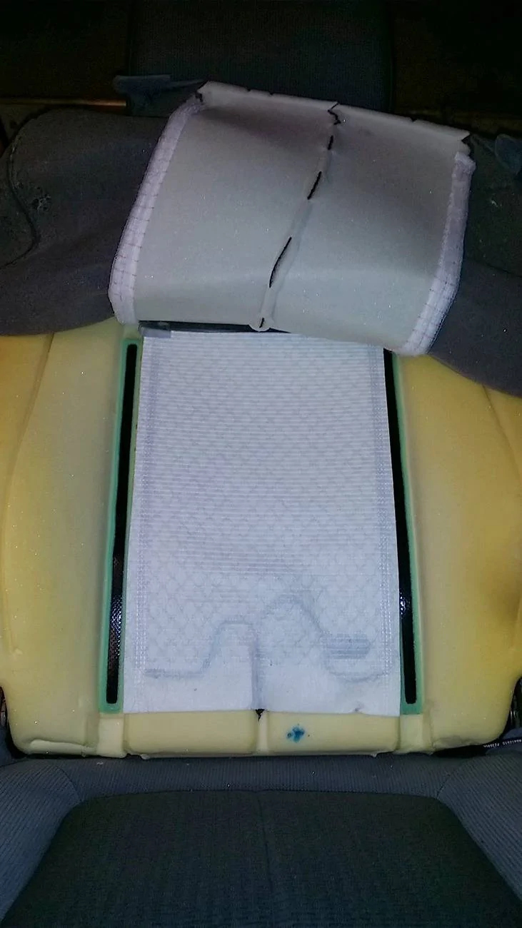

The aftermarket heated seat kit is the same as OEM it's a carbon fiber heating element that installs under your fabric seat covers or faux leather seat covers and sticks to the foam cushion. Nothing different other than your installing these after the purchase of the vehicle. Many times if you run them to the OEM heated seat circuit they work like OEM when you shut the car off they go off when you turn the key on they come on if you leave them any on position even with remote start. That's how I wired them in my 12 F-150 XLT and they worked perfectly with remote start and everything.
Each heated seat has its own fused circuit. If you install it properly you cannot feel the wire running to the heated element you install it just like OEM it runs through the bottom or the back side of the seat cushion foam. You can see that on my previous post pics of my past installs.
The heating element pads can be cut to fit the cushions as long as you don't cut the heating wires that run along the sides.
