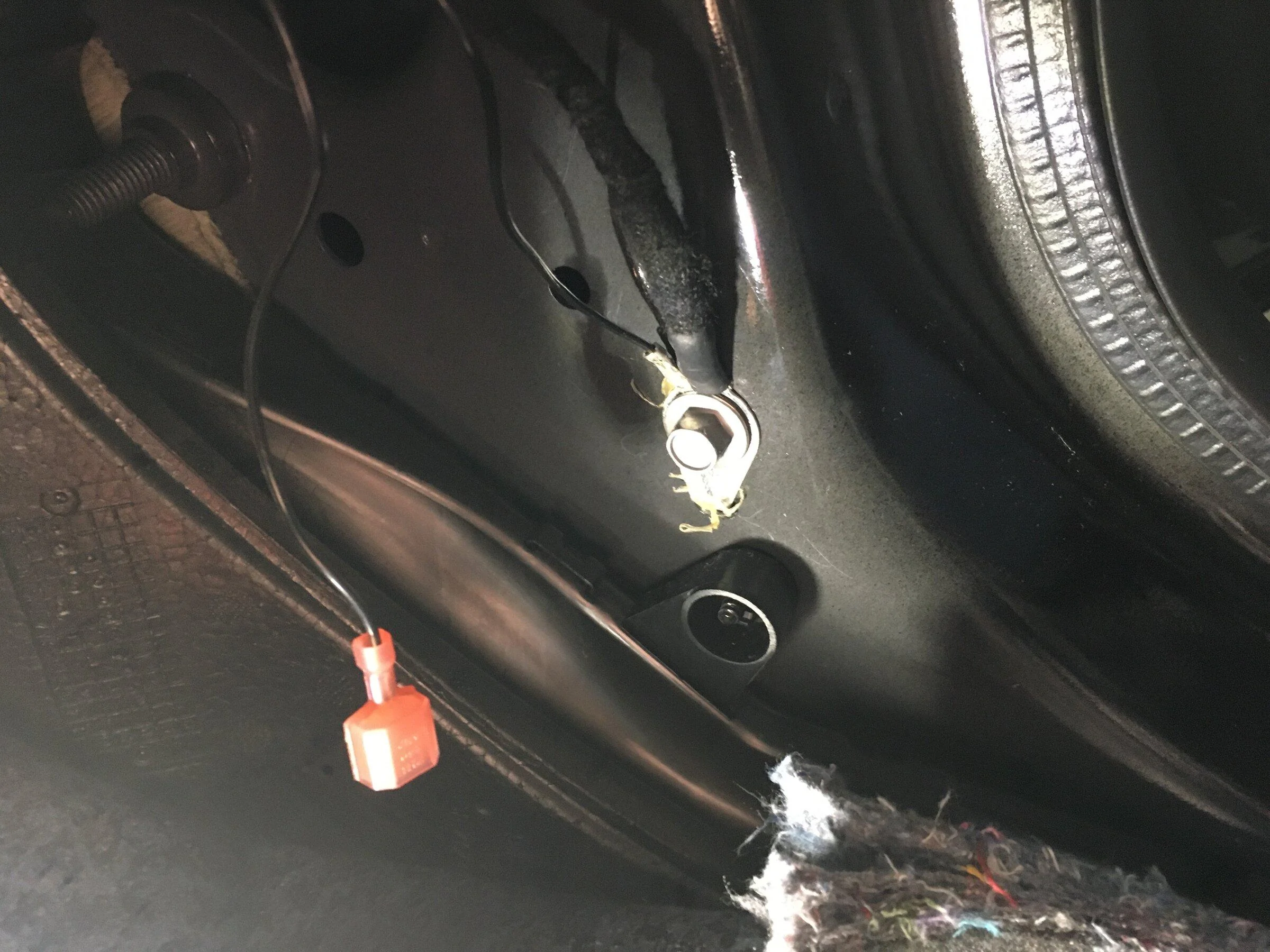

Today I was looking to install the hardwire kit for my dashcam and took my multimeter out and removed the panel from the fuse box only to find there does not seem to be a decent ground location anywhere near the darn thing. I'm not against running a longer wire I guess, just wondering if anyone else has tried to do this yet, and where you might have grounded to? I'll probably poke at it some more over the next day or two, maybe there is a bolt somewhere behind the glovebox I can use.
I used this one under the passenger kick panel and used the blue/red wire for constant 12v and the yellow/green for switched 12v (both about 4-6” above the ground)
Ford Maverick Ground location near the fuse box for hardwire kits? 8176930B-B14A-4B66-8F1A-C6CD15A30503
