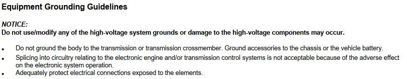

Sorry, you're correct about what the manual says, but that also runs counter to the Hybrid Modifier Guide document, it says to "ground accessories to the chassis or the vehicle battery".
I amend my prior post and recommend grounding to the chassis via a new or existing point.

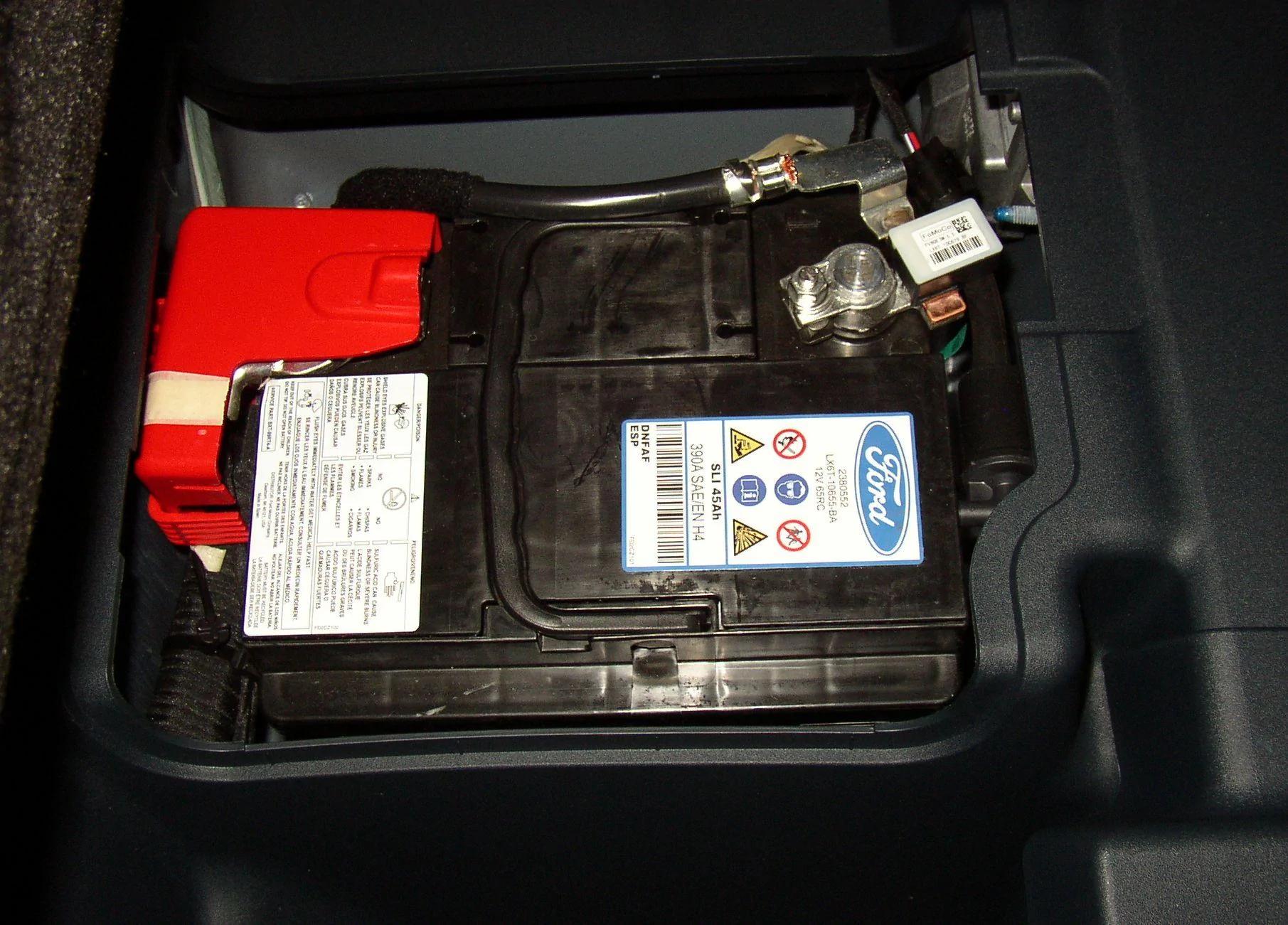

Specifically if you're grounding to the battery you would need to make sure it is before the BMS sensor which is adjacent to the post. So basically don't hook any terminals beneath the negative clamping bolt.
