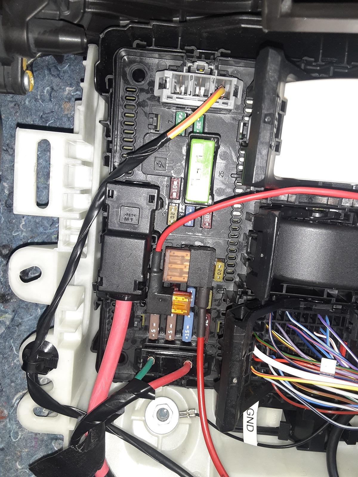

With my Garmin mini I used fuse #3 for accessories power and fuse 18/19 for constant power for parking mode.
Ford Maverick Fuse location 20231012_152702
