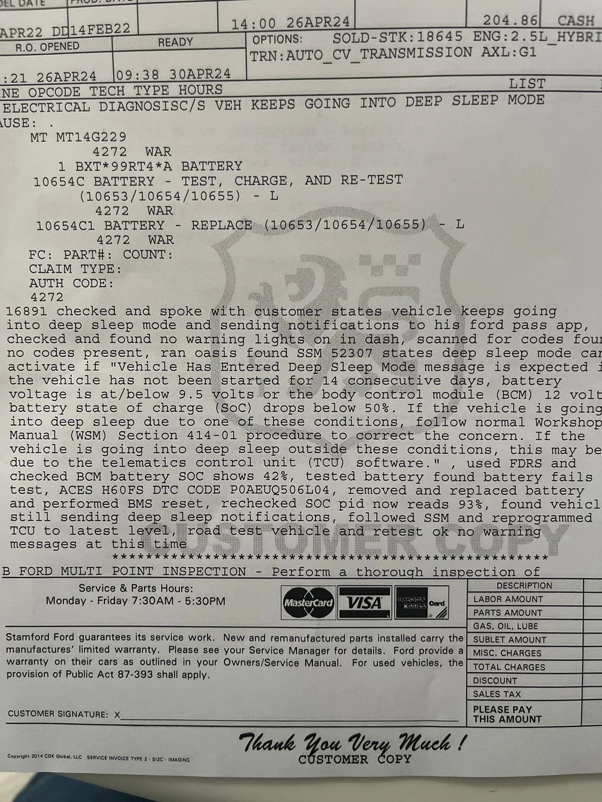

Hi had this issue for 9 months there was an error code SSM 52307… the dealer did all of these steps.. NO MORE DEEP SLEEP MODE! …
I hope that works for you. If I read the receipt correctly, it has only been one week since it was fixed?
