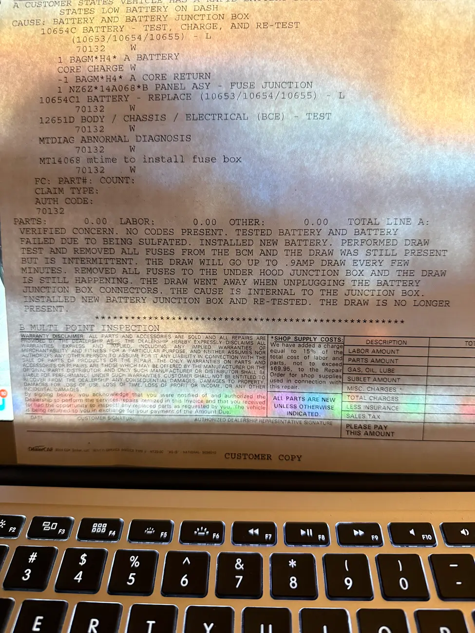

Hello, Today I got my 2024 Maverick Hybrid Lariat back from my Ford dealer. I had the truck in about four months ago for the "sleep mode" problem. They charged the battery and that worked for about three month. The issue got worse so I went back to the dealer with the same issue. After several days testing they decided to replace factory 12 volt battery with a AGM battery. I have attached the tech comments for you to read. If you are having sleep mode issues, there is a fix. Hope this is last time having the battery go to sleep!!!

So it appears that replacing the battery junction box fixes it.

Great find. That's a new one.
Since not all with slowly sulfating batteries have a parasitic draw - may not be the end all be all.
But at least it's another thing to check.
Disconnecting that also stops the feed to the BdyCM fuse box in passenger footwell - so gotta do things in proper order as the tech did.
But what an easy test.
Well - as long as you put the fuses back correctly.
You should encourage that dealership to have that tech submit his solution to Ford, if it doesn't automatically.
At least it's not going up as a "bad battery warranty replacement" work order.
