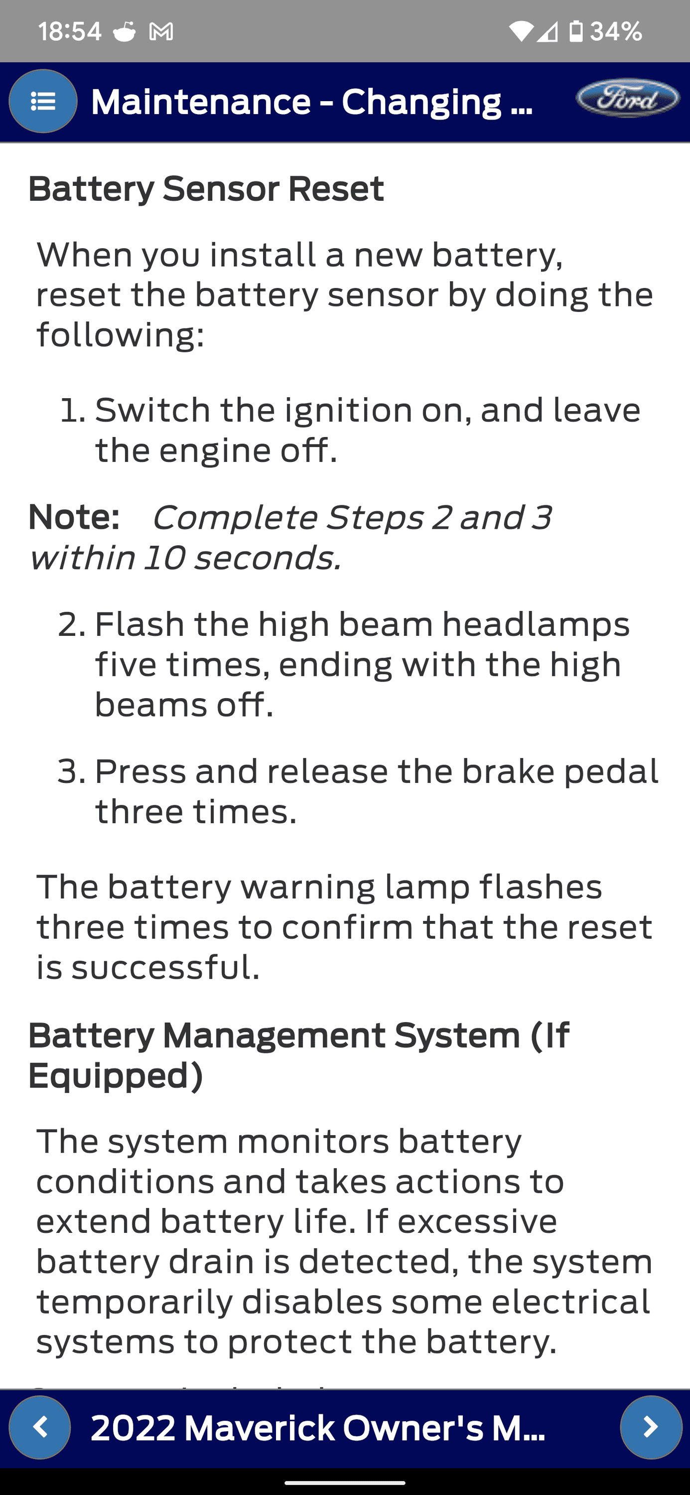

I left my Ford pass connection active. I like having the remote start and I get alerts if my perimeter plus alarm has been set off. I did turn off Wi-Fi in the truck settings.
Still no deep sleep after over a month of resetting the BMS. I just added a kicker hideaway under the rear seat. I'll see if that affects power draw.
