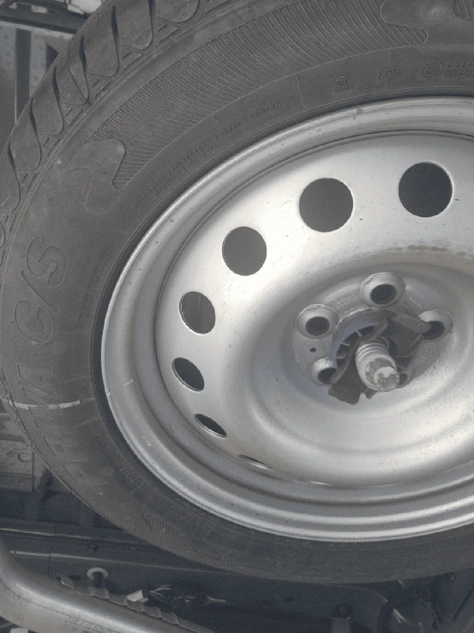

Has anyone mounted a spare tire the same size as the tires on the car? I did and needed to modify some things under the bed to allow this tire and rim to fit.

I searched vehicles that have the same bolt circle diameter (108MM) and a center bore of 63MM as the Maverick. Ford Escape from 2018 and up have rims with those dimensions. I purchased a rim from a 2018 Escape from a local salvage yard and mounted a 225 65R17 tire on it. To get it under the Maverick I had to cut off a steel weldment located just forward of the spare. After that it fits neatly under the bed.
I'm not sure but I heard that that's suppose to pierce the tire and deflate it in case of a rear end crash. Others have also removed it to put in a full size spare.
