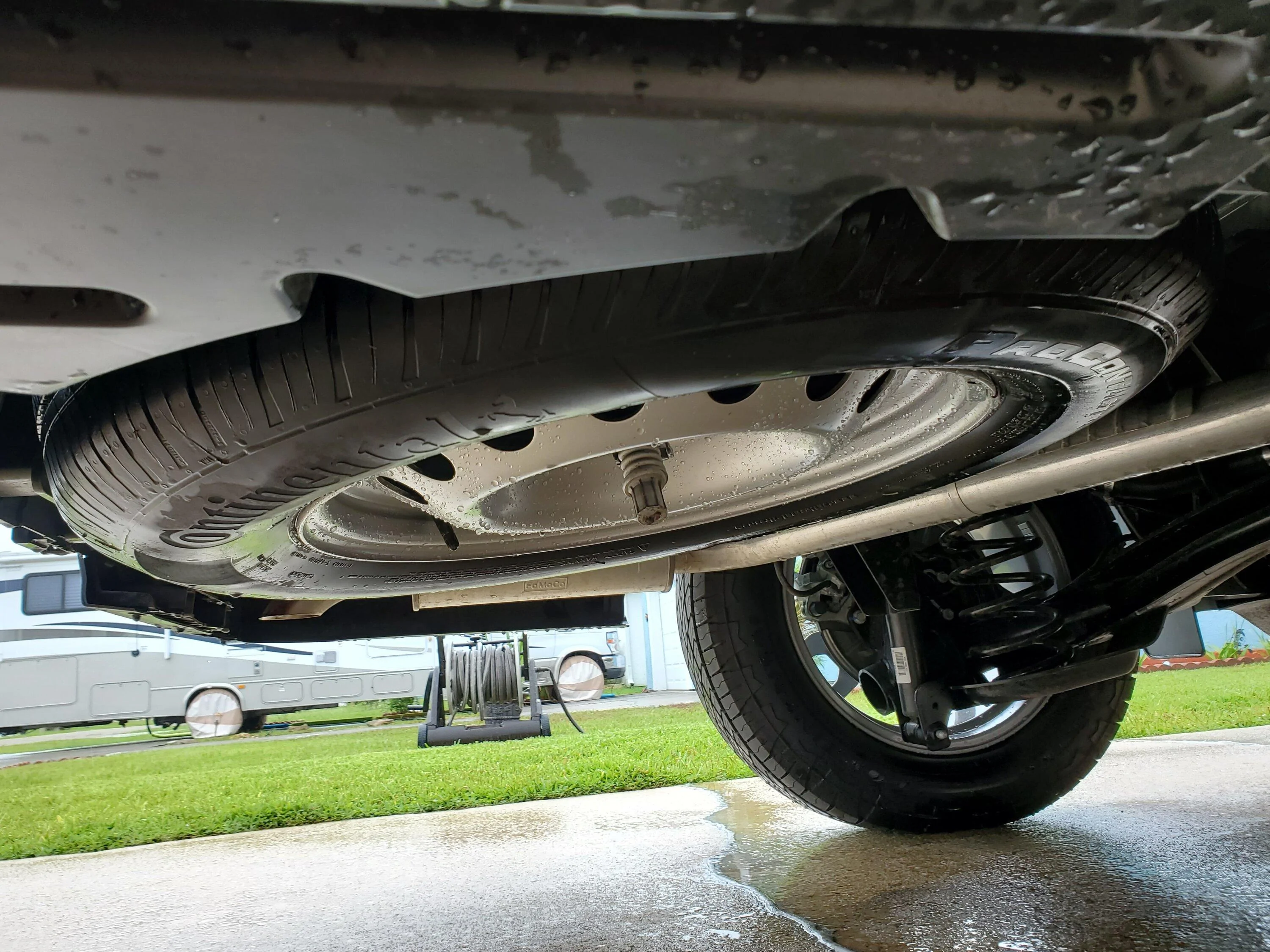

It gives you a standard steel rim instead of a doughnut sized rim. My plan is to hit a local used tire place and find something decent in the correct size.
right. but will that tire you pick up be able to fit in the spare tire well. or do you plan on putting it in the bed

Reports are that the standard 225/235's fit fine.

I run an aggressive 245/65R17 AT (Toyo) and it fits fine.

good to know bgn---where you able to put that tire on the rim of spare tire that came with the car?
were you able to sell the spare or store it in the house,,,just curious. I live in apartment
not much space to put old spare in living room

I run a Unique 83 wheel 17x7 from Discount Tire. The donut spare wheel and tire went to their trash/recycling. You might be able to get some money for it, but I didn't want to deal with it.
