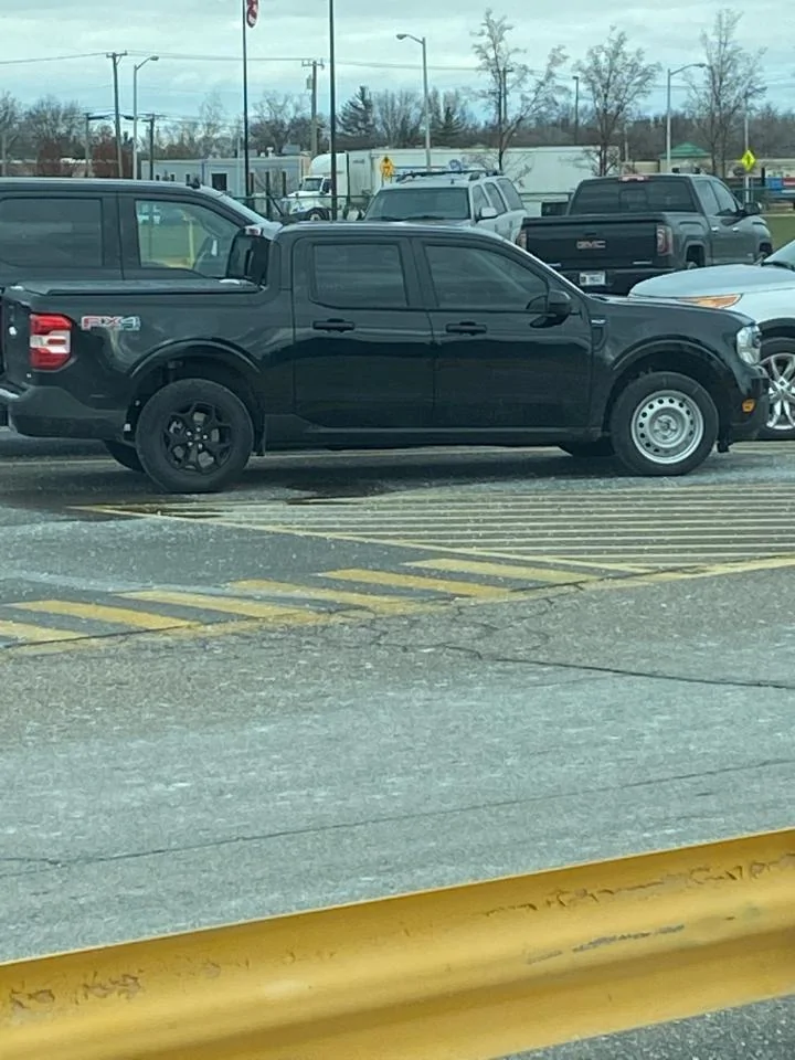

This is what it looks like on the truck. The wheel weight was improperly mounted and caused my tire to go flat at 1000 miles. It looks to me like it's the same tire and steel wheel the LX comes with(?). I didn't look at the size when I had it mounted but it's definitely smaller.
there is no "LX" model Maverick ;)

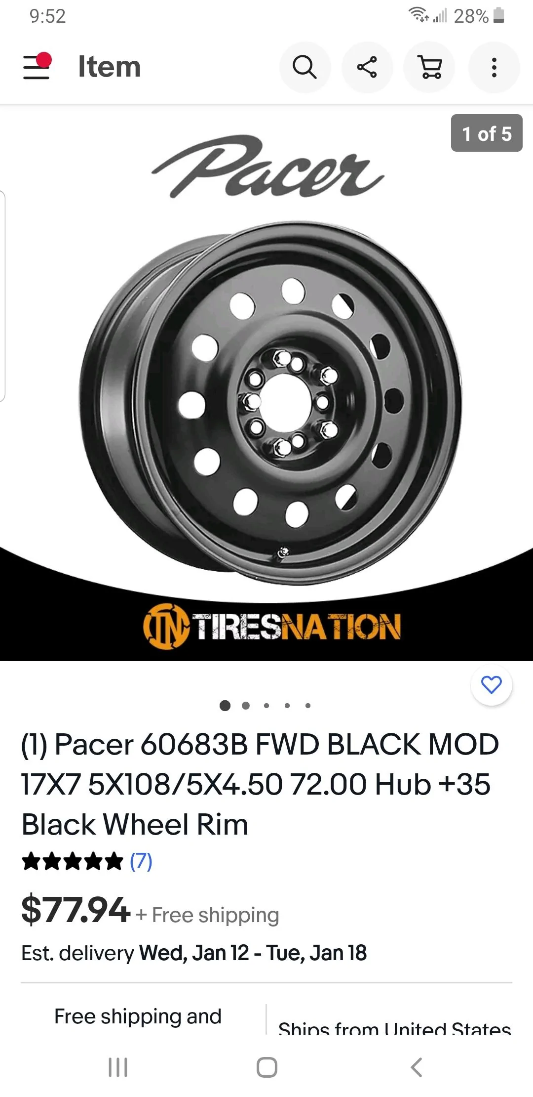

Get the donut, then buy one of these, and a matching tire to the other 4, and have em put a TPMS sensor in it and hang it under the truck. Unless the "full size" film is already a 17x7. In which case just get an off brand 225/65R17 and install it.
Ford Maverick "FULL" size spare not really full sized? Screenshot_20220101-215226_eBay
