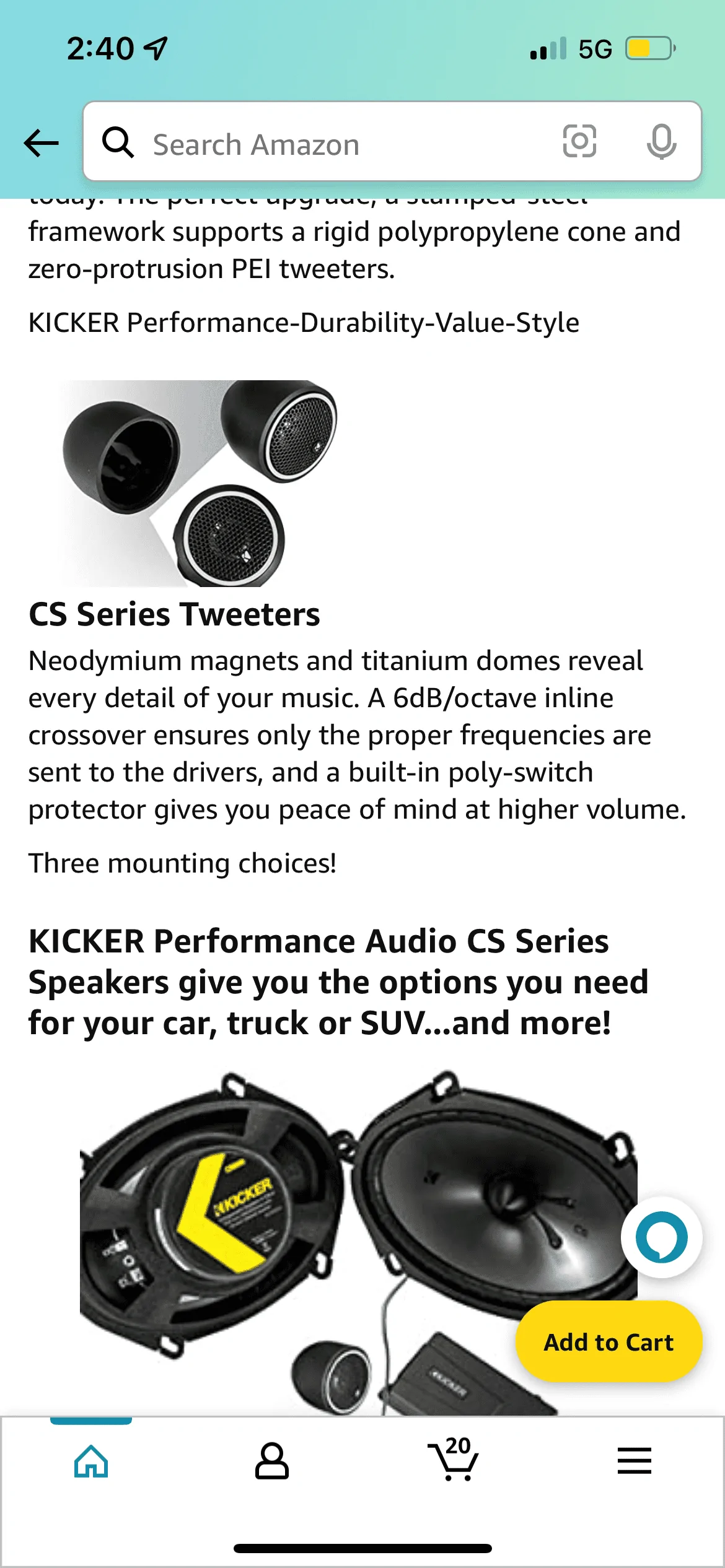

Why would the tweeter receive anymore strain or damage than the factory setup since this taps into the OEM wiring it’s not changing anything other than the rms wattage correct?
Even with the kicker key correct me if I’m wrong and upgraded tweeters not should be build to handle it?
im no expert but I’m considering doing this set up and I feel like y’all put a rock in my boot 😂 if I am wrong then what’s the solution
I’m planning on doing the key 200.4 setup with these speakers
1)Kicker 46cst204 tweeters 50 watt rms
2)Kicker 46csc674 door speakers 100 watt rms
3)Kicker csc4 pillar speakers 50 watt rms
4)Kicker 46hs10 hideaway sub/ amp combo
as well as using the hoel harness set up.
I listened to the speakers on crutch field and they sound just as good maybe better than the focals and very affordable and well I want all one brand and it just seem to fit for me. 1000$ set up but if ima blow the tweeters or if this isn’t gonna work man I’d sure love to
Know or how I can fix it
any suggestions

So the frequency issue was present in spite of a upgrade therefore isn’t a major issue just a potential one?

The stock tweeters have bass blocking capacitors installed on them (they're soldered on the back next to the connector). Aftermarkets, especially intended to be used with a crossover, may not.
i understand now completely so I can leave the stock tweeters and be fine or upgrade to tweeters with bass blocking capacitors built In?

... it's just math. you could figure out the specs of the capacitor used in the crossover and get your own, and soldier it just like the factory tweeter. there could be phase issues but at least the tweeter won't get damaged from trying to play low frequencies.

This kicker cs model tweeter has a built in crossover on the wiring harness from watching videos I’m sure I can stuff it in the dash under the tweeter correct?
