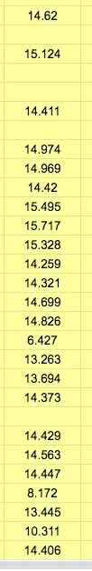

Only had 6 vehicles thru the years - all had a reserve under E of some size. Mazda, Toyota, Nissan, Ford.
Some with a light didn't even turn on until the bottom of E was hit, the light meant 2 more gallons. 1 did the light when it hit E.
I just added 40 miles as failsafe and started noting the cheaper stations.
Get ready for test results to your question.
Here's my fillup history - maybe one tilted scenario in there, usually no more than 10 miles past DTE 0.
You can tell where I was on long road trips - stopping early so no problems with where the next station was.
