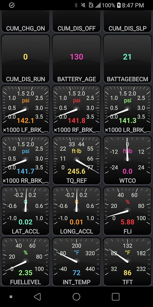

Ok - just hit 0 miles to empty leaving grocery store last night, next stop got a picture if the values for 2 PIDs.
Been observing those 2 since just past last fillup. (so couldn't confirm 100% start)
The Accelerometer PIDs show I wasn't exactly level at picture time, slight tilt to right and nose up - so away from the fuel pump area of tank, which is front left bottom.
FLI - Fuel Level Indicator, has been pretty much matching the fuel gauge drop at 75%, 50%, 25%. Not exactly, so it's not the gauge reading, but must be used for it.
FUELLEVEL - on the other hand, I'm guessing is related to a % of the fuel tank vertical space left, literally.
It was never at 75% or above when I added the PIDs, dropped faster than FLI until abouts 30%, then seemed to drop very slow as FLI went lower - then it caught up, and went lower.
So I'm guessing it's what % of a rod float reading scale the level is at - not sure where it would be located.
2.35% of 16.5 gal useable gal tank = 0.39 gal - even that doesn't seem right and way too low.
Maybe that's the level starting at minimum required for fuel pump. As Mavster Mechanic said in his test of running out - it just stopped, no sputtering last few drops, and started right up on fill-up as no air in line.
My guess if I kept going - it would drop very slowly.
FLI 5.88% of 13.8 used in math = 0.8 gal - that sounds better as built-in reserve when it's declared 0 miles left.
So even if someone doesn't want to believe about the extra 2 gal really there - you have plenty of miles left to get to station.
So pay attention to the highway sign stating "180 miles to next fuel stop", but don't rearrange your errands or get questionable gas because you think you have 0 miles.
(unrelated - TFT - tranny temp is held better after a grocery store stop @ 28F than INT_TEMP of DCDC Convertor)
ETA: just filled up level ground - normal 2nd click (done in case the 1st clicked very early, which happens).
FLI maxed at 96.xx%. Needle was top of full line.
Going down slight hill later - read 100%, didn't go over when it probably could have.
The reading does change quickly as tilt happens, so slosh. The gauge must use this, but smooth it out for display.
FuelLevel - only went to 39% - so it must mean something else, or values being read wrong.
Ford Maverick Fuel Lesson Learned Screenshot_20251203-204709
