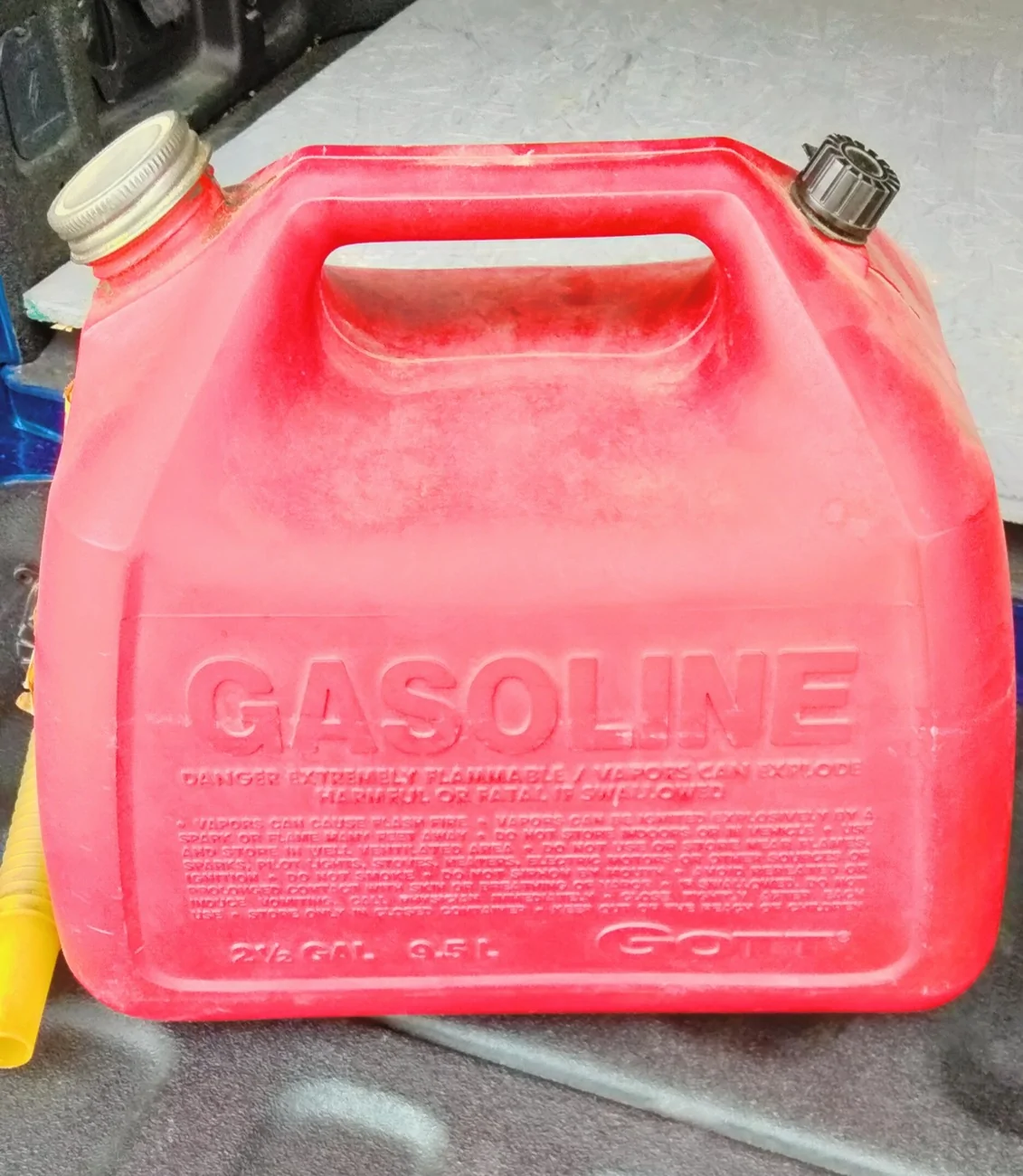

I can of course always extend the range of my hybrid Maverick.
When I feel I need it.
Ford Maverick Fuel Lesson Learned IMG_20251118_083955
