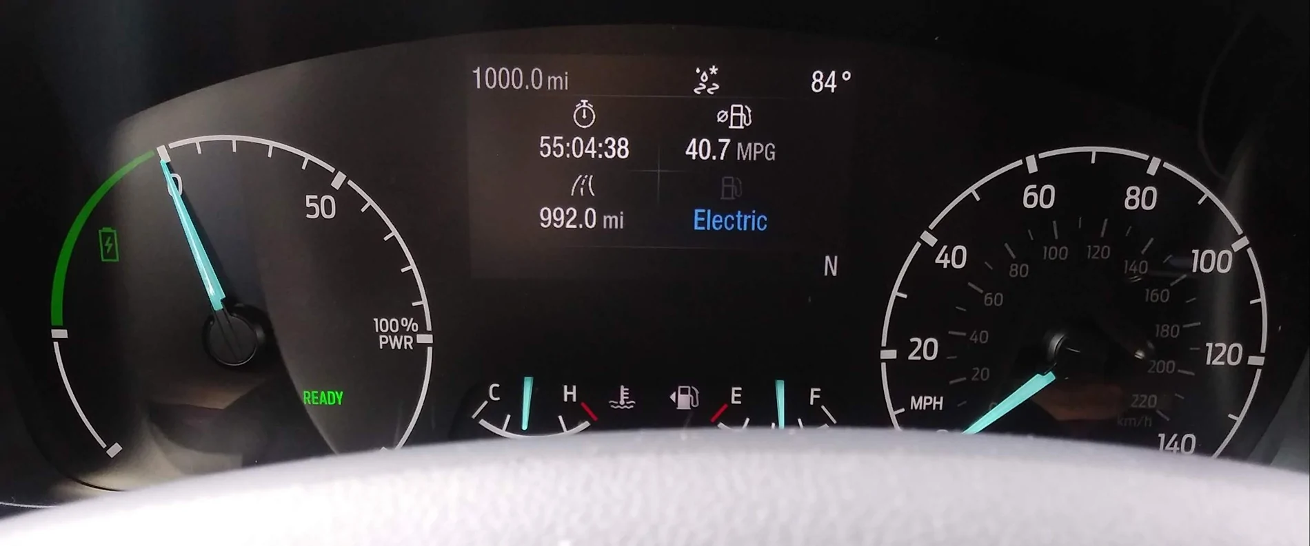

Yeah, the fuel gage is the suckiest suck that ever sucked. It would be a deal breaker if not for the Miles to Empty reading.
The cluster design in general is bad, lots of wasted space. My pet peeve is the small little vertical bar that is shown for the Power %. The total available bar height is like 3" but the power % never exceeds like 1/2", there are no graduation dash marks, etc.
Yikes - didn't realize no hashes appeared or % when in use.
Even the pre-25 design left plenty of space on the screen though. Especially when 10% max EV power was a limit to attempt to stay under, but get close to.
I wish the speedo would give some 5 mph increments instead of 140 mph - but I've observed thru the logs they have 3 different readings for speed that rarely match to 1 mph - so perhaps that's why.

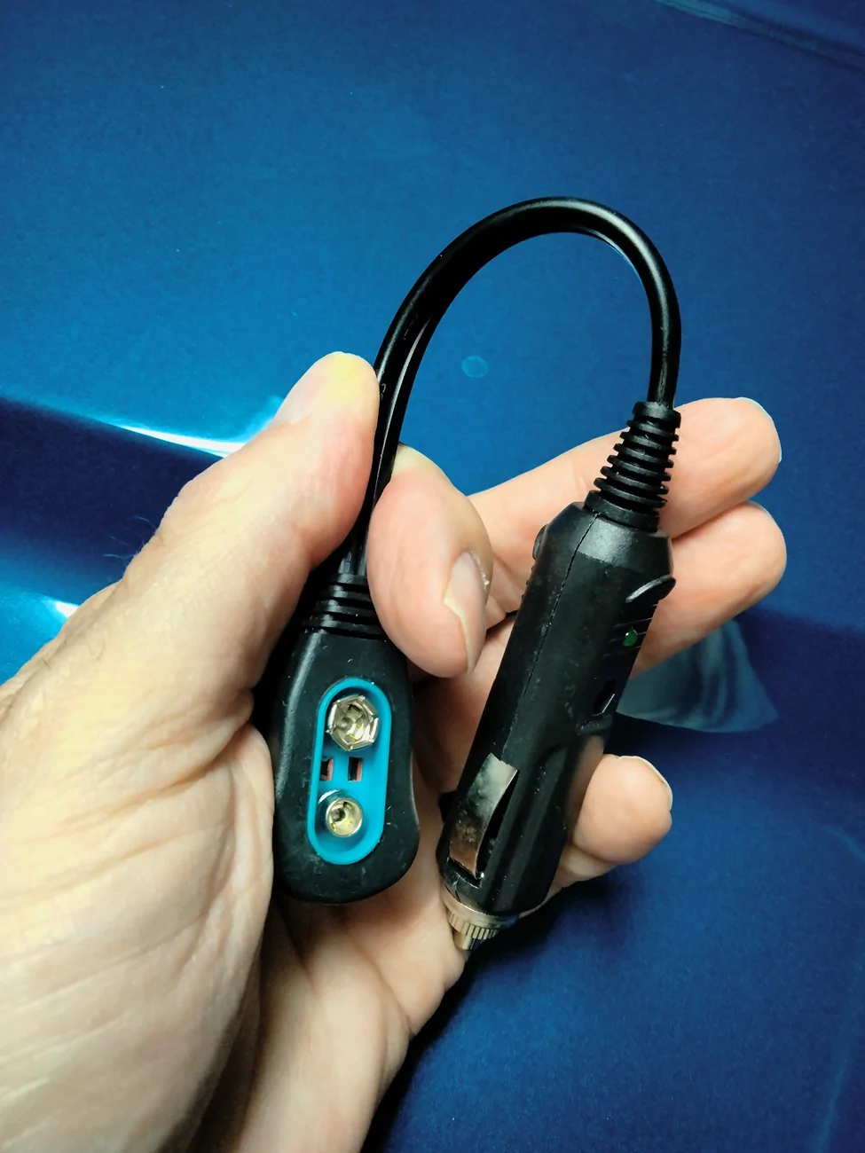

smart trickle charger
Will probably not deliver any current to an open circuit. The old trick was to connect a fresh 9v battery in parallel to the 12v before removing and replacing the 12v battery, but I have not tried that on any modern car.
No surprise the radio presets were retained as the radio has an operating system similar to your phone and should be storing the preset information on an internal flash drive (so, a non-volatile storage media).
El Kabong
Apr 1, 2026
419
844
Carnation, WA
2026 Maverick Lariat Hybrid AWD, 2017 VW Golf Wolfsburg
Well, yes, but nowadays the 12v outlets are usually behind a relay and thus disconnected when the vehicle is off.

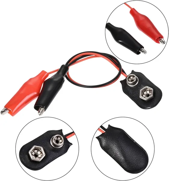

Somewhere in my vast Piles of Electronics Crap I have a homemade version of this, but it's been years since I used it:
Ford Maverick Fuel Gauge Question 9v crocodile clips
