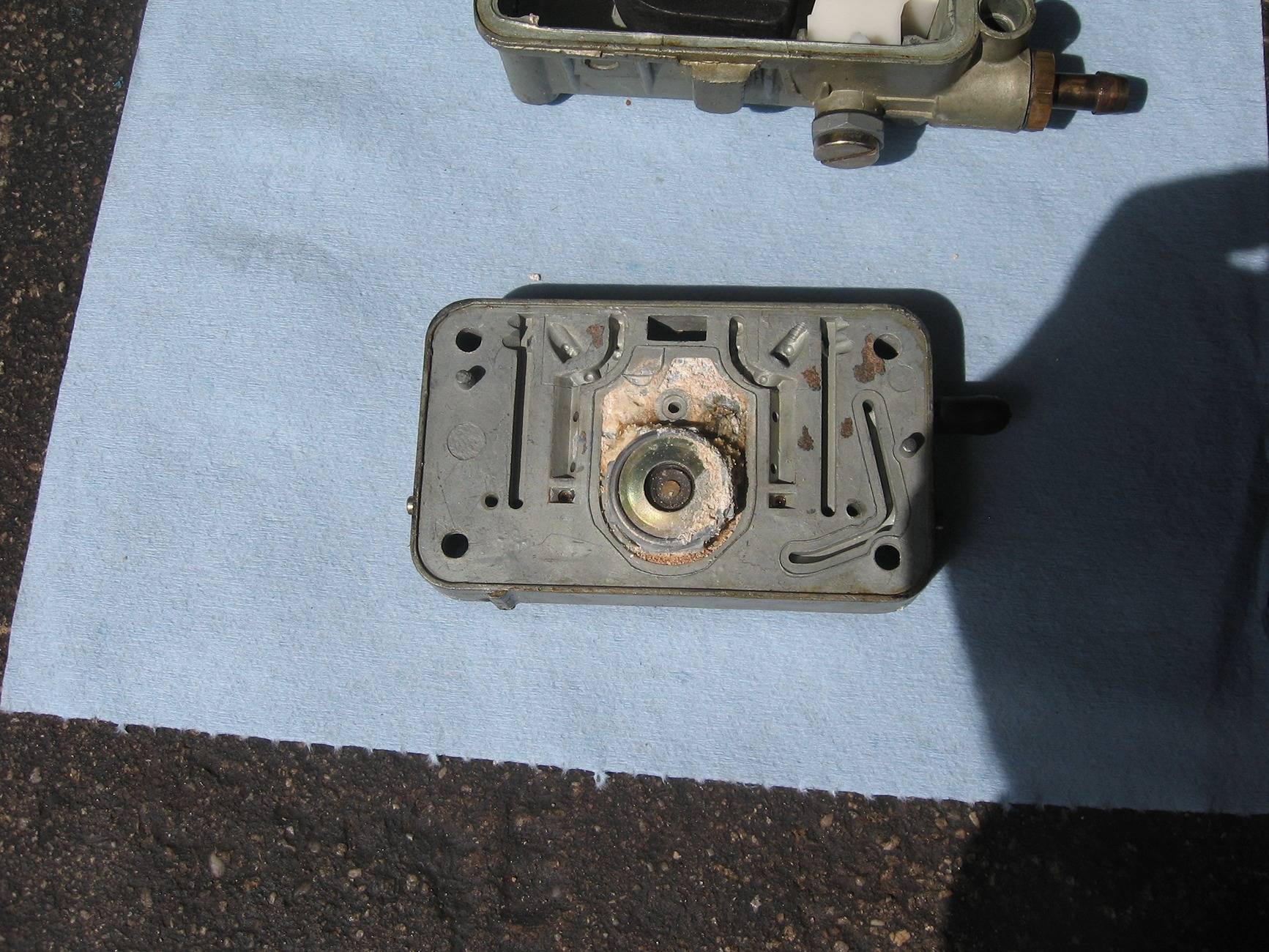

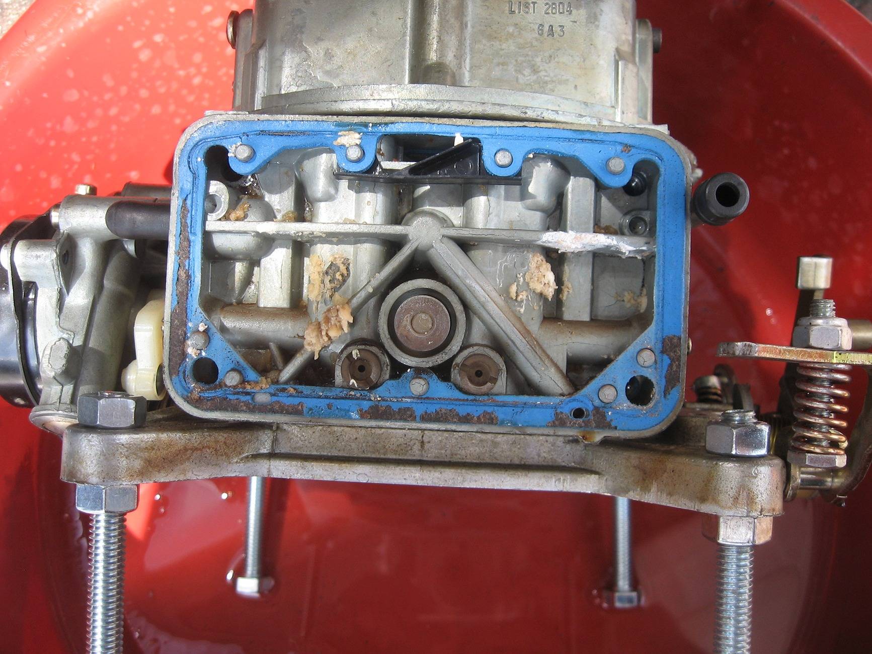

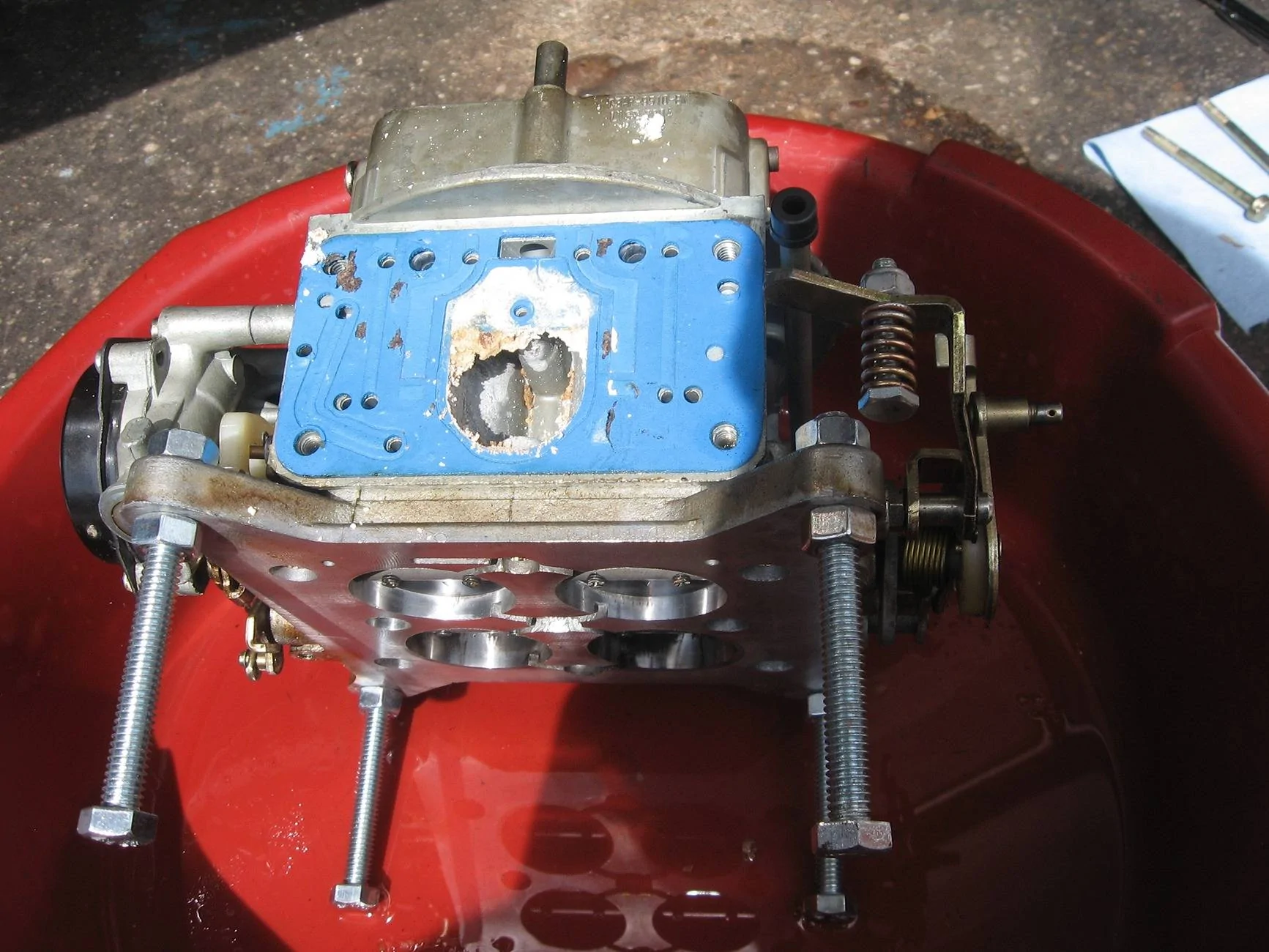

But apparently he didn't tell you why.
Ethanol changed the air/fuel ratio.
Expensive fuel injected cars adjust A/F ratio automatically. Small simple carbureted engines do not self adjust.
Ethanol is harsh on natural rubber compounds, natural cork gaskets, and lead solder uses in older simple engines. Modern vehicles have none of that.
Boaters should not use ethanol as it will dissolve fiberglas. Boat may have fiberglas tanks as well as hulls. Your Maverick does not.
Also ethanol is harder to ignite with a weak cooler spark. And harder to ignite in cold weather. May be harder to start "pull start" engines.
He explained all of that and more after I showed him pics of my Holley carb from my 67 Shelby GT500. Was it the ethanol? I don't know but I never had this problem before ethanol was added to gas.

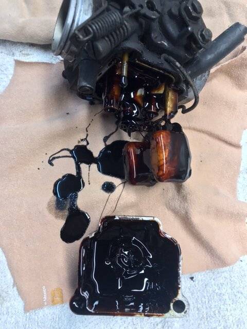

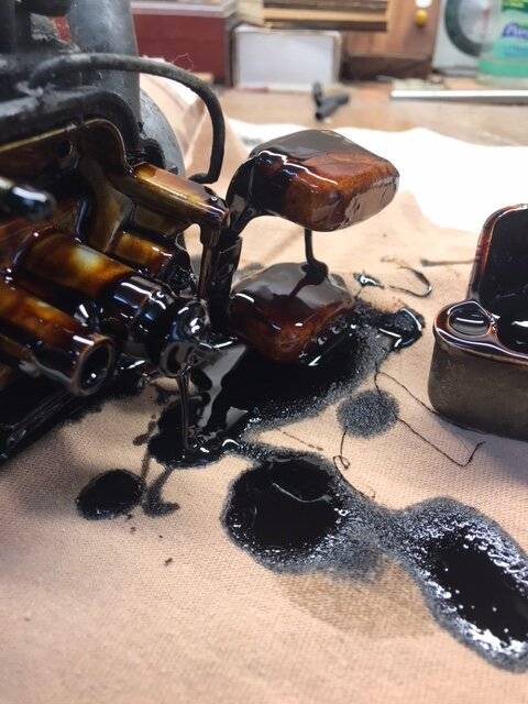

I have an instance where I was very fortunate to find pre-ethanol gasoline in a vehicle. I bought a very low miles 1975 BMW R90/6 motorcycle that had been sitting for over 30 years. The guy I bought it from admitted to not being much of a mechanic and it had spent the 30+ years sitting w/ gas in the tank and carbs w/ the petcocks not turned to Off. It was very nasty in there BUT if it had been ethanol laced fuel instead of cleanable stinky goop I would have had complete destruction.
