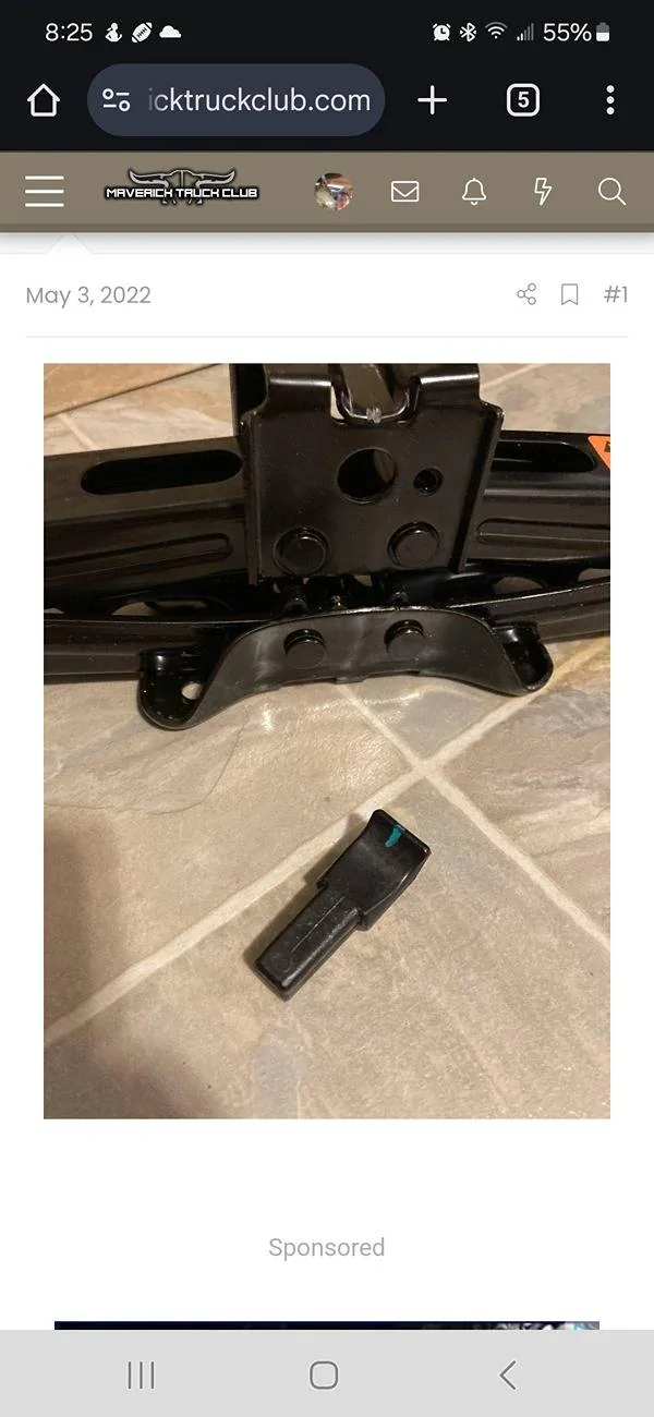

what's this pry tool for? i've used scissor jacks since forever and can't think of why this is needed.
It's used to manually open the hybrid fuel door, but should work for a stuck ecoboost. Page 178 in owner's manual.

Huh? It can be used for the fuel door I guess, but it isn't mentioned there:
Ford Maverick Frozen gas cap door 1735314421271-0d
*Edit: Based on what I know about the thickness and durability of paint on the Maverick, I wouldn't dare use a hard plastic anything as a pry tool in body panel gaps.
A far better guess would be that the little plastic tip goes on the end of the tire tool and is used to pry the XL lug nut covers off. ;)
Also read: Pry tool that slots into one of the winch rods that you can use to pry off center caps or hub caps to get access to lug nuts on XL wheels.

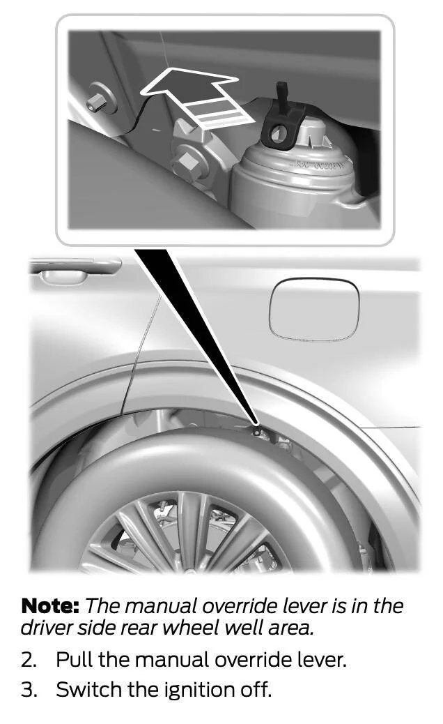

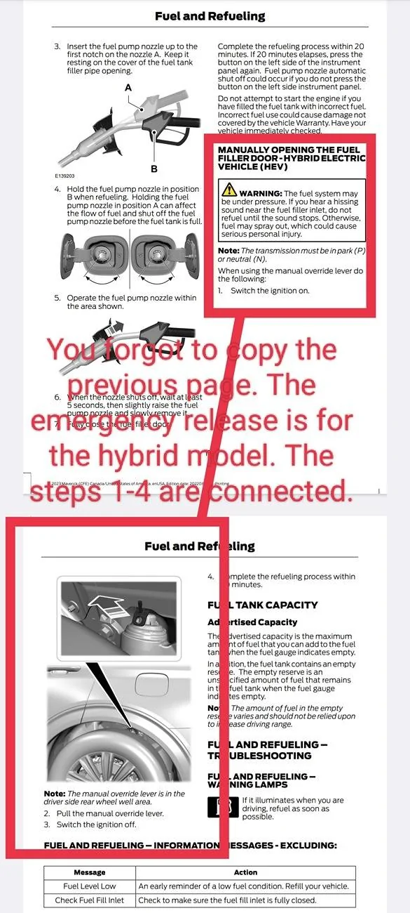

The emergency release is for the hybrid not the EcoBoost.
You omitted the previous page of the manual.
Ford Maverick Frozen gas cap door IMG_20241227_083755

You omitted some information
I sure did, but it wasn’t “grab the plastic pry tip from behind the rear seats.”
Step 3 undid what was done in step 1.
Carlitos_92
Mar 24, 2024
2,494
5,243
Take a look at my post again I wasn't done posting or editing. 👍
I was done, though. 😉
My response was to a post suggesting the use of the plastic pry tip. The manual filler door release process is well-documented around here and off-topic to the OP, so my intent wasn’t to regurgitate it.
