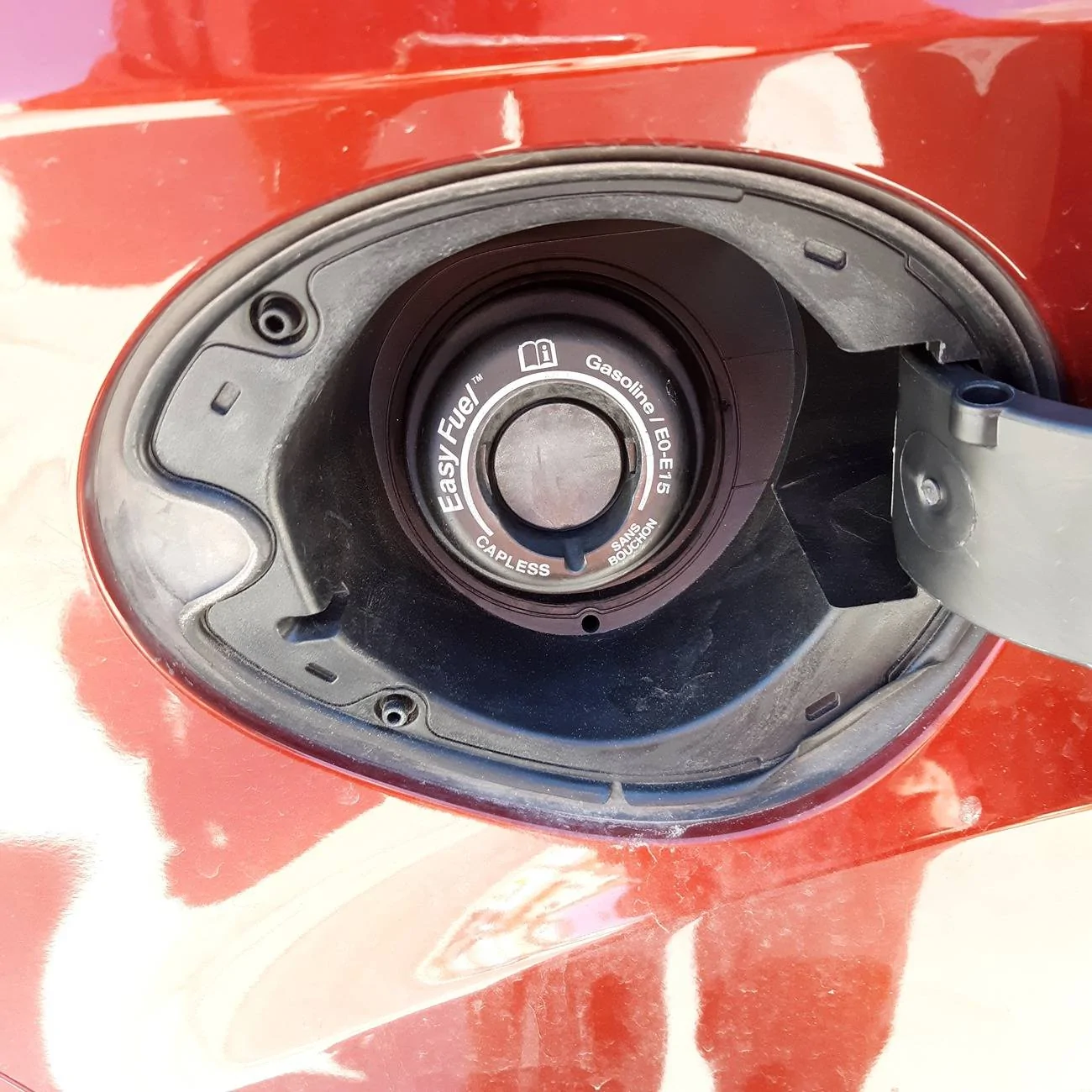

Only the Hybrids are cap-free. They also have a pressurized tank.
Ecoboost models do have a gas cap.
🤔 Interesting , I didn't realize that Ford went back to gas caps on the EcoBoost Maverick's.
The picture below is of my wife's 2016 Ford Escape and her 2009 Escape also didn't have a gas cap. Both Escapes were non-hybrid.
Having had Chevy Volt along with my Maverick. I realize our tanks are pressurized and have a locking fuel door
Ford Maverick Gas cap problems 20250405_103132
