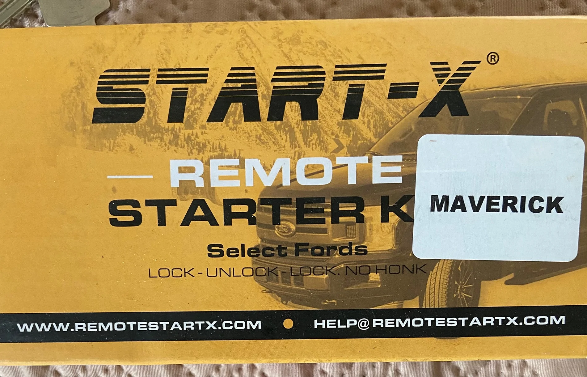

I own a MY24 Lariat (that may change how the new fob works with an XLT vs a LARIAT.) My two original fobs already had that remote start capability. I did purchase two additional fobs and programmed them exactly as the video showed and they are now my primary carry fobs.
The 22 to 24 Maverick Lariat has sync 3 and push to start. The XL and XLT do not have Sync 3 or push to start. XL &XLT have "Connected Touch Radio" and you have to use a key.
Therefore there is no way to just add a Key FOB Start without an additional piece of equipment whether it's a car alarm or something like "babutruk" posted below.
I bought this after I picked up my MY24. Amazon looks like there are several options. Never opened the box:teehee:
at the time it stated MY22/23/24
