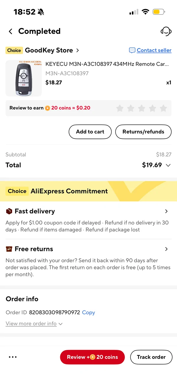

I just got my $20 key programmed and have remote start working. Too easy!

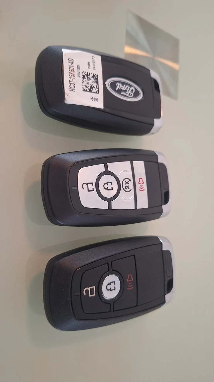

I got a cheap remote from China
315MHZ
And it's working
I performed the two keys activating method
I got three keys now
I didn't get remote start button from factory
Ford Maverick 2025 XLT remote start with Cheap replacement key fob 20260120_162917
Cancunbadlands
Cancun
Jul 5, 2025
4,429
4,766
Cancun
So is this possible on a (keyed) 2025 XL hybrid? I am able to remote start thru the app, but it kinda sucks. Proximity feature would be nice too.
Will work, just make sure to order the correct MHZ frequency
Mine came with 315MHZ
But yours could be different
And, you need to perform the two keys activated method
So you need the two OEM Ford keys and the new spare key with the start bottom 2X
