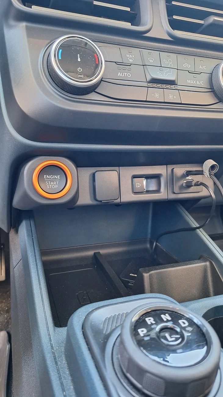

To program a new key without FDRS you need 2 keys already programed to the vehicle.
Remove the liner in the bottom of the center console.
You will see a indentation slot to place a key in there, its the back up slot in case the battery goes dead in the fob
Keep Foot OFF the brakes for entire procedure
Place the first programed key in the slot & press the start button
Wait 10 seconds & press start button again turning it off.
Within 10 seconds place second key in slot & press start button
Within 10 seconds place the unprogrammed key in the slot & press start button
You should see a message on the instrument cluster "Key Programing Successful" & the door locks will cycle
