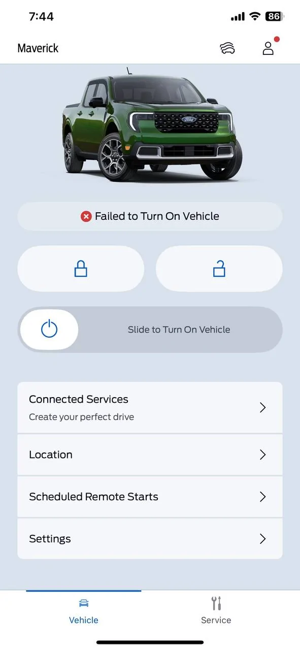

This is what I get when I try to remote start:

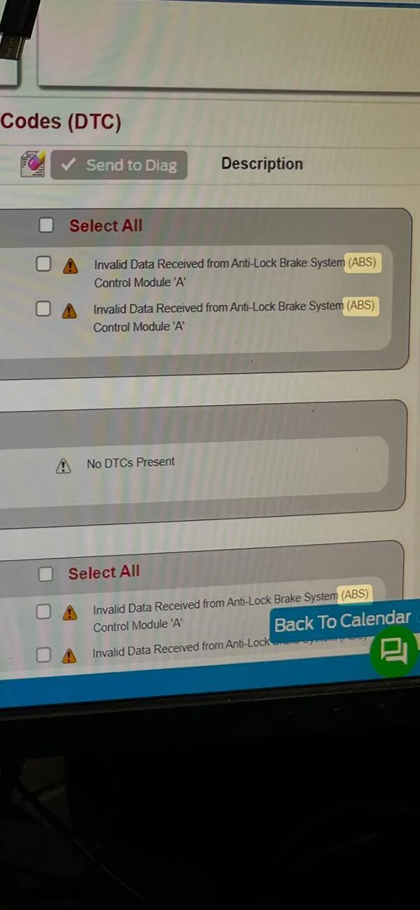

EDIT: Talked to the Ford Customer Relationship Center via chat because I discovered my dashboard was saying I had service actions, and I was curious what they meant since I have 275 miles on the truck. I found out that, "there are several health alerts that state 'Invalid Data Received From Anti-Lock Brake System (ABS) Control Module).'" Oh goody.

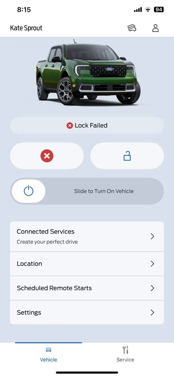

Just keeping track: After what was probably over a week of working fine, my FordPass was nonfunctional yesterday.
Ford Maverick Ford Pass Remote Start Problem 2025 XLT 1741351085539-s8
