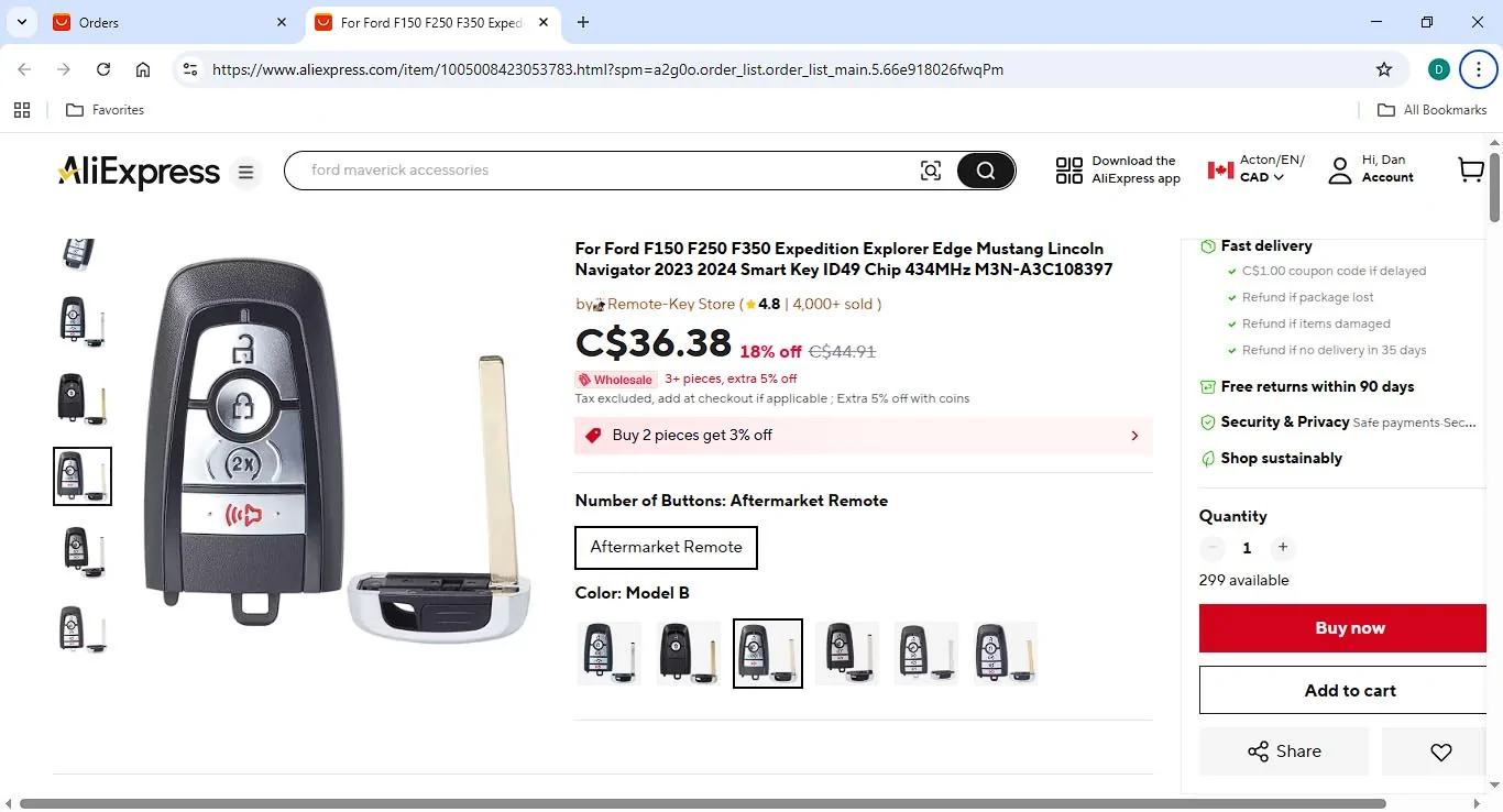

Can anybody tell me if this works on with or for a 2025 XL since I have a key not a fob setup like the rest of the Maverick's? I have in the main instrument cluster a option for remote start so I am looking for info.
Question I assume this means you can do that remote start with these key fobs.?I ordered 2 each for my Tremor and Ranger the switch blade type on Alli Express about 2 months ago. Programming is easy. Just make sure the frequency and FCC ID is compatible with the one you're going to order because you could have the correct frequency but not have the correct ID number and it will not work. The FCC ID number is usually located in the pocket if you have the switch blade key FOB. I have my keys laser cut from an online locksmith. I have used him twice with great success .Cost is usually around 60 bucks for 2 keys.
Yes It should work the same for your Maverick IF you have remote option. However you said you just have a key? Your vehicle did not come with a FOB to operate door locks or windows?Question I assume this means you can do that remote start with these key fobs.?
