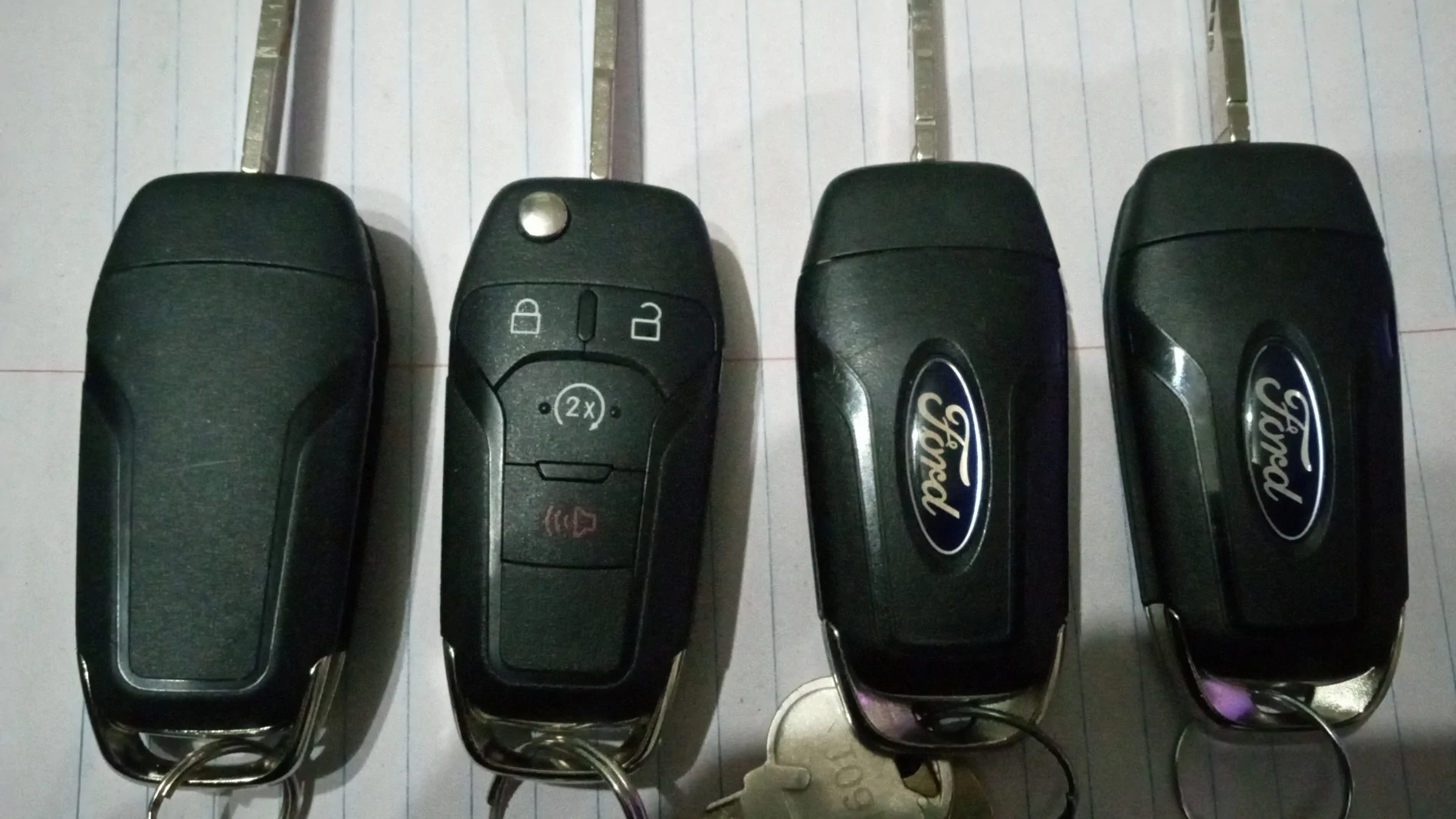

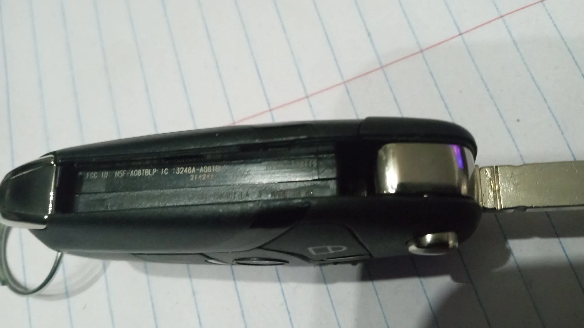

I ordered 2 each for my Tremor and Ranger the switch blade type on Alli Express about 2 months ago. Programming is easy. Just make sure the frequency and FCC ID is compatible with the one you're going to order because you could have the correct frequency but not have the correct ID number and it will not work. The FCC ID number is usually located in the pocket if you have the switch blade key FOB. I have my keys laser cut from an online locksmith. I have used him twice with great success .Cost is usually around 60 bucks for 2 keys.

Well, got an extra fob for my 2025 Lariat, programmed it in a few minutes. Works fine. Need to get the key cut somewhere. Here's the listing I ordered from, selected "4 Buttons-A". Tip, don't remove the fob from the indentation until after you've turned the vehicle off, then swap it with the next one (unless it's the last one).
https://www.aliexpress.us/item/3256810354939660.html

Used the FCC # on the key and into the FCC link and got 433.589-434.251.
So is it a 433 or 434?
