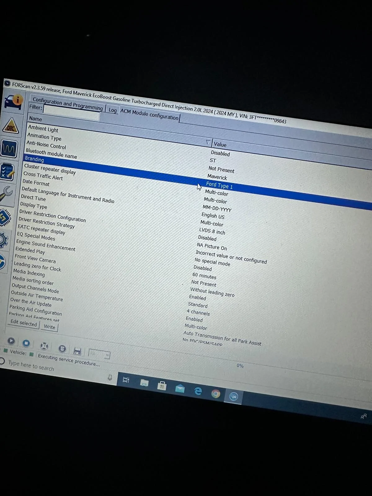

So am I. But every time I try and change the Animation Type to ST the write quits at 99%. My truck is a 23 Lariat Lux. Perhaps that's the reason.

Hmmmm. Are you able to write other codes just fine? Take a picture or a few of all modules in your ACM in easy mode. I will see how they compare to mine.

Sometimes for scan can act weird too so I would definitely unplug everything, close Forscan and try it again. And see if it does the same thing.

Here is a picture of most of my ACM module. It could be another setting is different and is preventing that from writing. I do also have “Driver restriction disabled”. It could be a Forscan, cable, or computer issue too. It could just be a bug and will work if tried again. And also it could be our differences in trim or even model year that is affecting it.

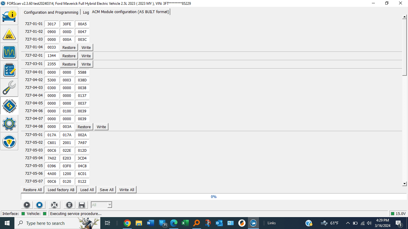

Thanks Ian, I changed mine to match yours (from the picture you posted). If it's not too much trouble could you compare my AS Built ACM settings to yours?
Just checked and your as built codes are 100% different than mine. They are completely different and that kind of stumps me. It makes me think the 2024s coding is a lot different for some reason. I took pictures of all my ACM settings the as built and the easy mode.

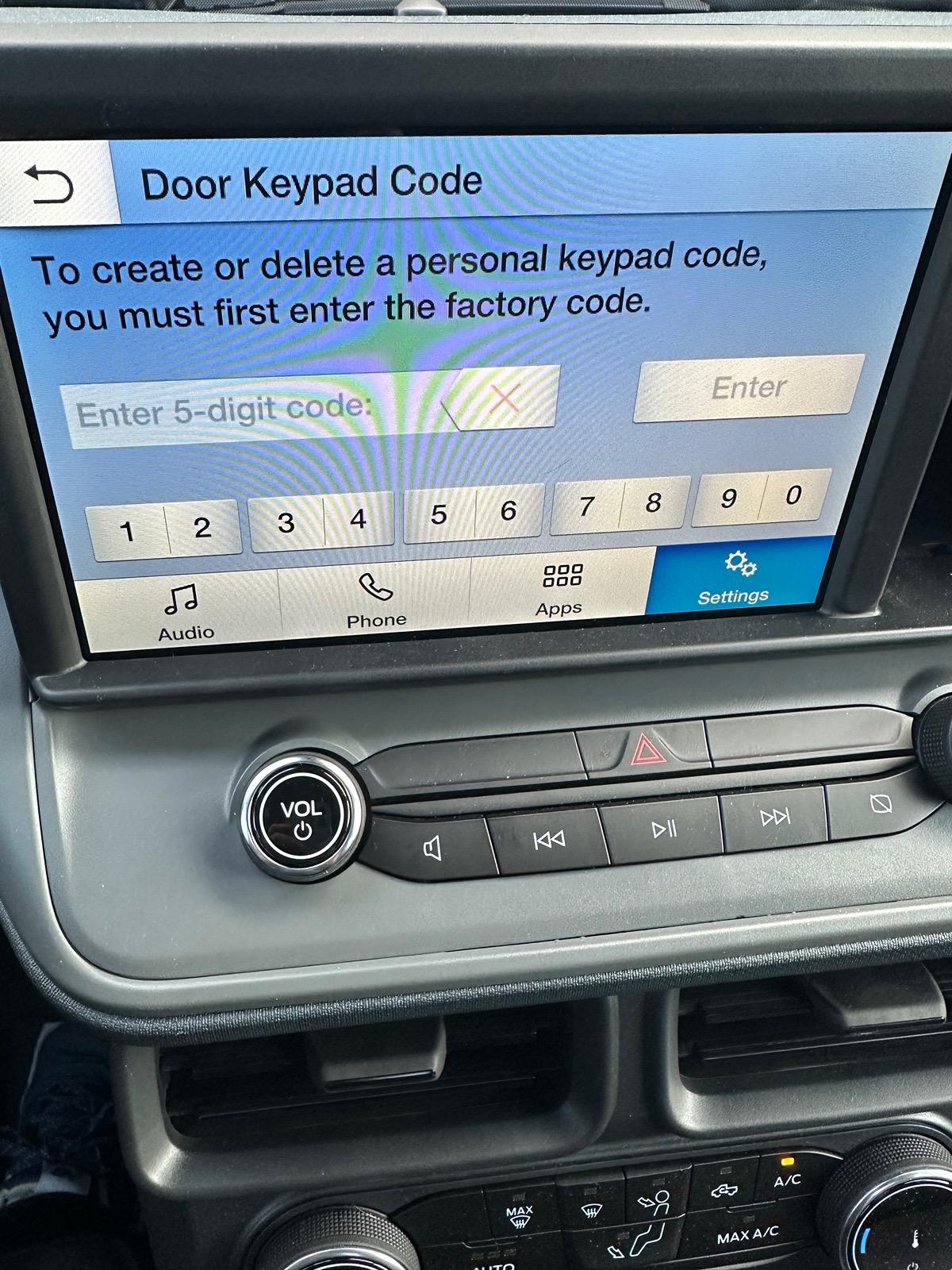

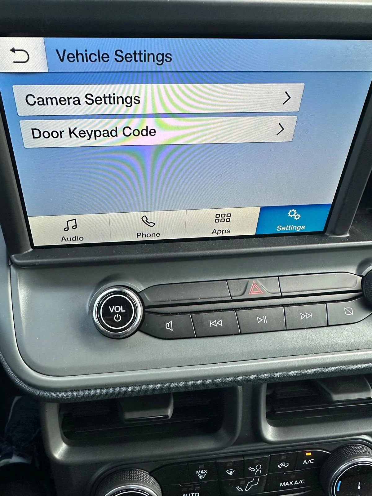

I found another ACM tweak but I am not sure it would be useful to anyone but I was able to add this menu to the vehicle settings in the radio. I don’t know if this menu is already in some mavericks or not.
Enable Door Keypad Code Menu
1. ACM
2. Enable “Vehicle Settings”
Ford Maverick Forscan Ideas for Dummies (Things You Can Do Using Easy Mode) IMG_2841
Ford Maverick Forscan Ideas for Dummies (Things You Can Do Using Easy Mode) IMG_2842
1. ACM
Interesting! My guess is this would only work with a factory installed keypad, since it asks for the factory code? Or would this work with the stick on battery powered version that is available for the Maverick from the dealer?
That’s my question as well. It would be nice if it worked with the battery powered one that is available.
