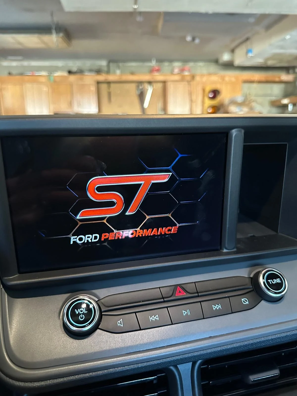

Thank you for putting this together. I have one more to add!
ENABLE RADIO ST ANIMATION
1. ACM
2. Under “Animation Type” change Standard Ford to ST.
This animation only comes on when you first enter or exit from the vehicle. Here is a picture of it I did it to my2024 maverick. Cheers to finding even more of these tweaks!
1. ACM
Nice!
The great feature about these Forscan tricks is knowing you can always go back to the 'default state' if you need to...but I'm going to try this one and probably keep it. Thanks for the tip!
