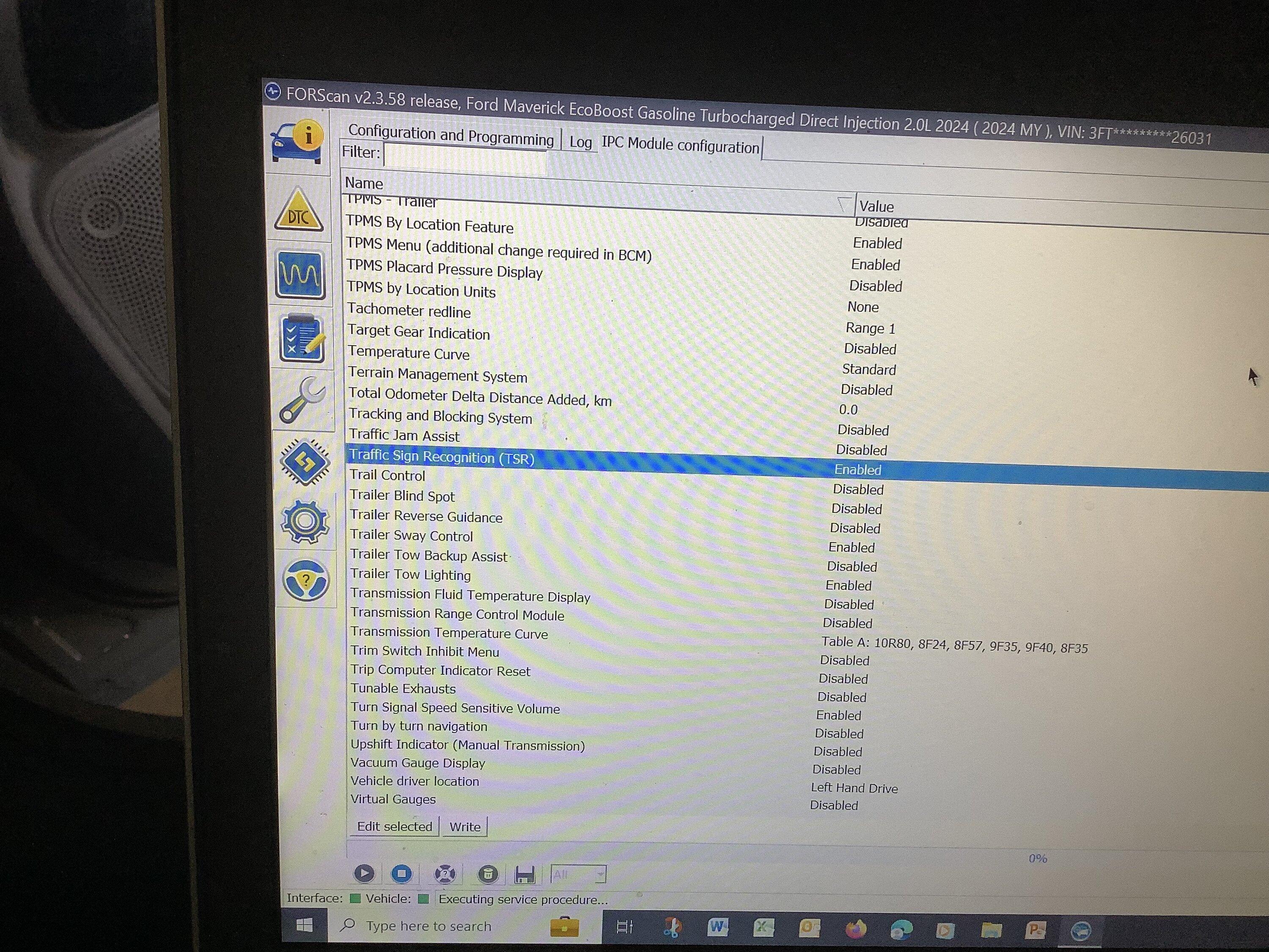

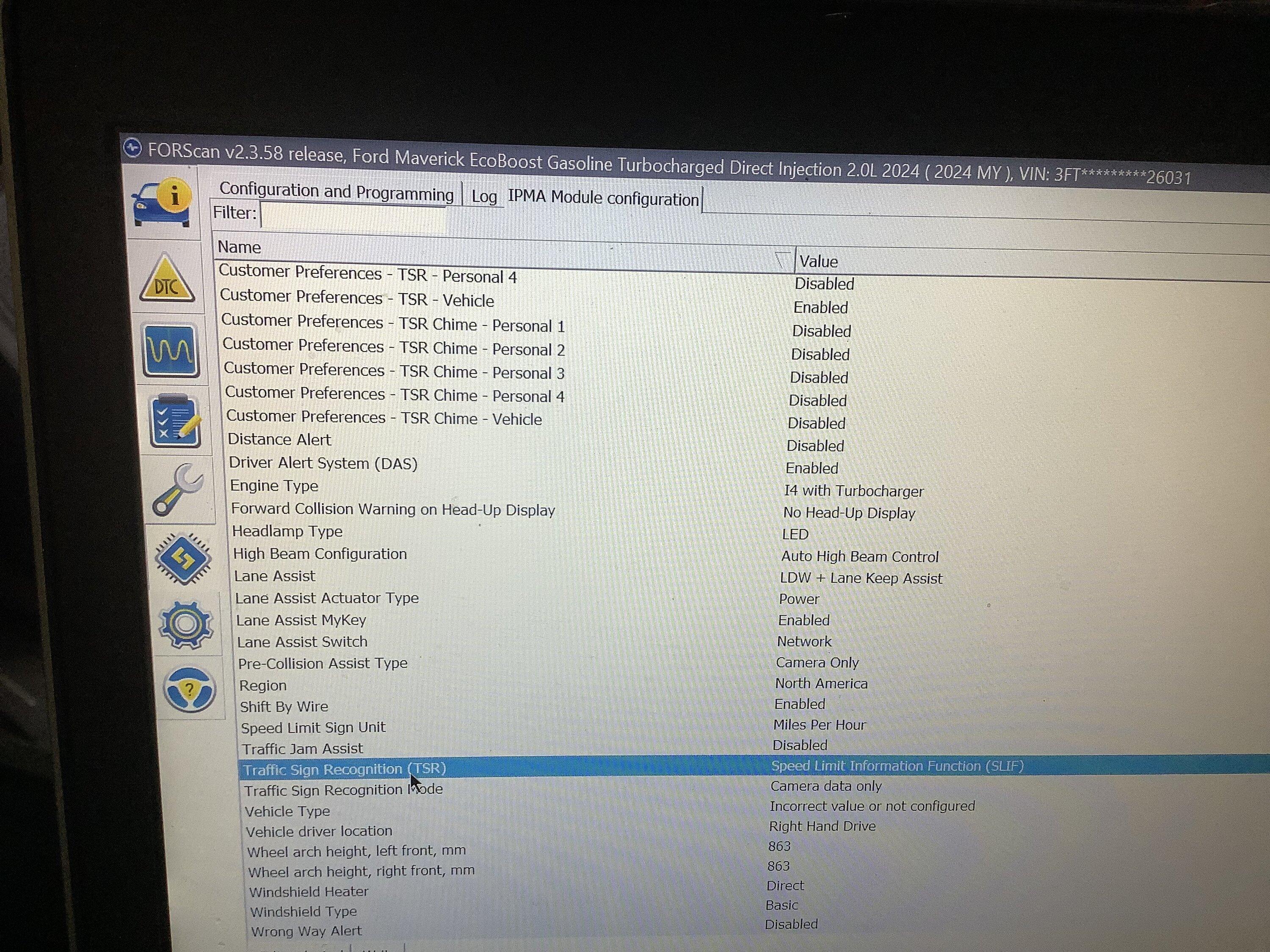

I followed most of the suggestions, however ran into a problem when adding the traffic sign recognition (TSR). In the IPC module, I do not have a SLIF option, only TSR. When TSR is disabled, there is not any display; when it is enabled, I get European Traffic symbols.
In the IPMA Module, my settings are:
TSR set to SLIF
TSR Mode set to camera data only
The attached pictures show my situation. I don’t know how to get the US roadsign symbols.
I drive 2024 Ecoboost FX4 AWD
Am I doing anything wrong?

I'm no expert but I think you're supposed to have "Traffic Sign Recognition (TSR) disabled for it to work, I know, its counterintuitive. Somebody correct me if I'm wrong.
I missing a function that others seem to have. I have tried every combination of settings. Right now it is working well, but displaying the traffic sign speed in the European style. I can live with that if I need to
