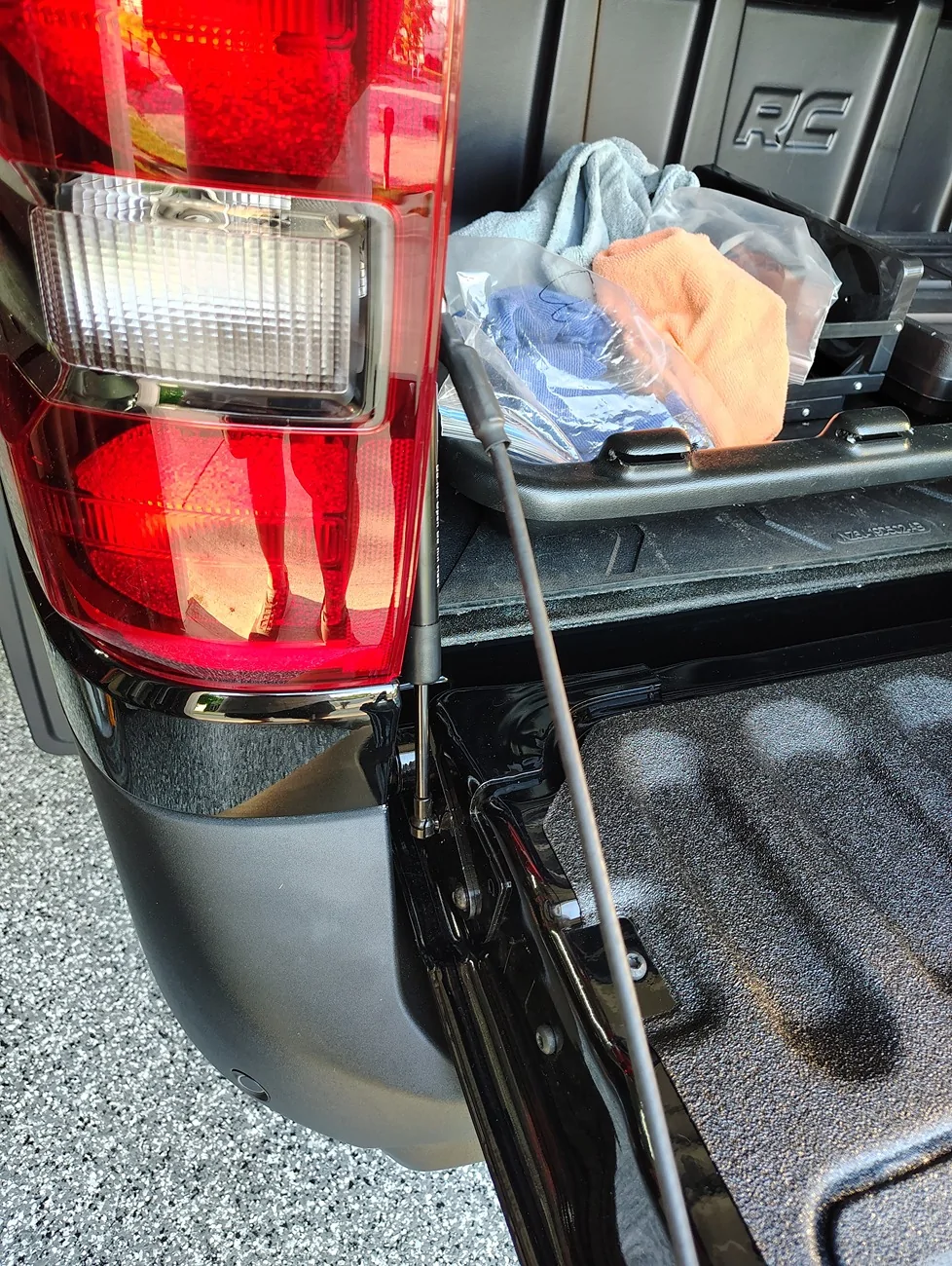

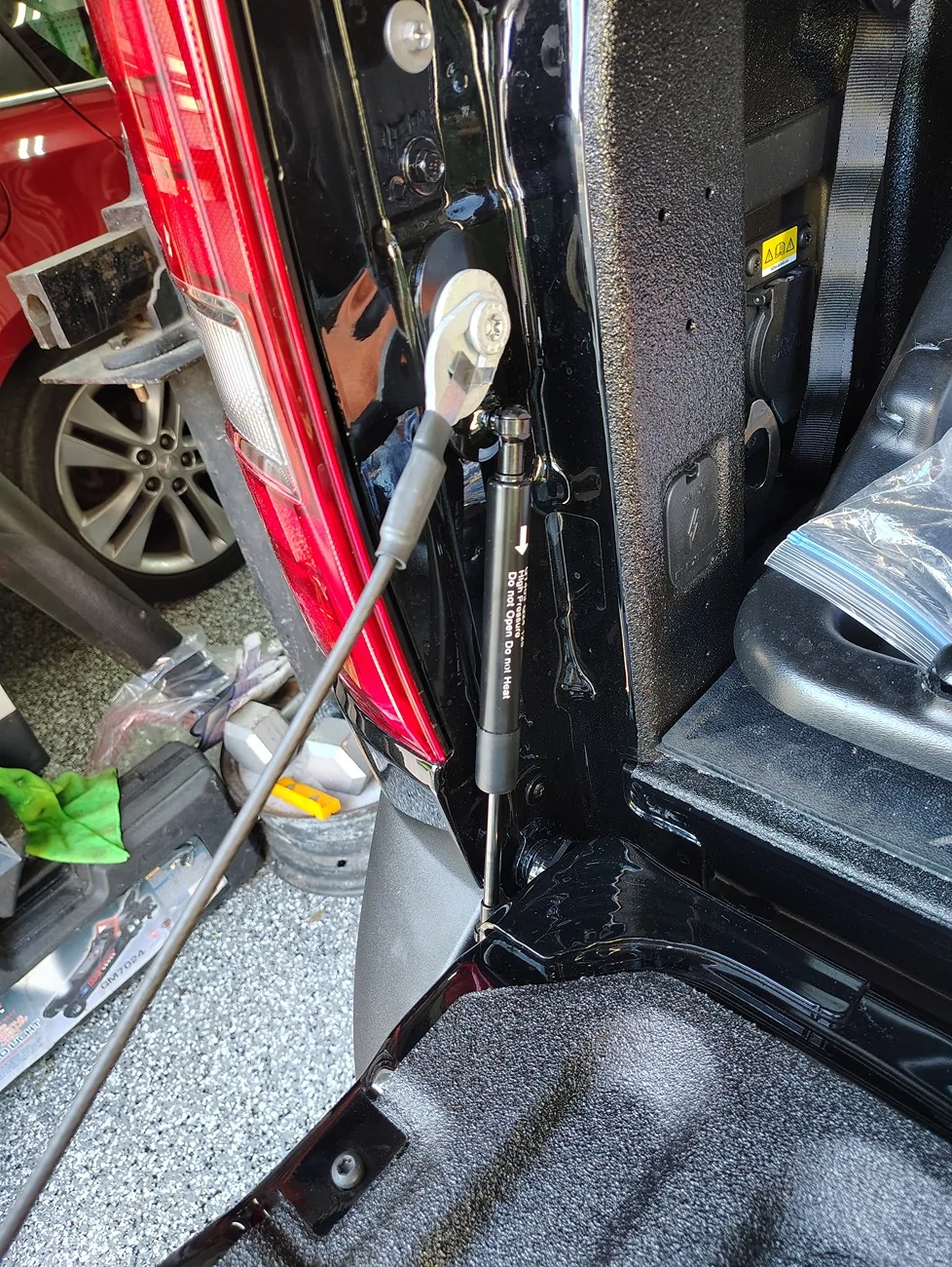

I agree it's a great mod. I didn't have one on my 22 but after a few a my buddies dropped my tailgate on my 25 I installed one. Also you don't need to lose the tie down. Just replace it with a D ring tie down. Works great.

One of the first mod's I did.
It's all about convenience.
Being able to drop the tailgate if my hands are full, without having to hold it or having it slam down.
