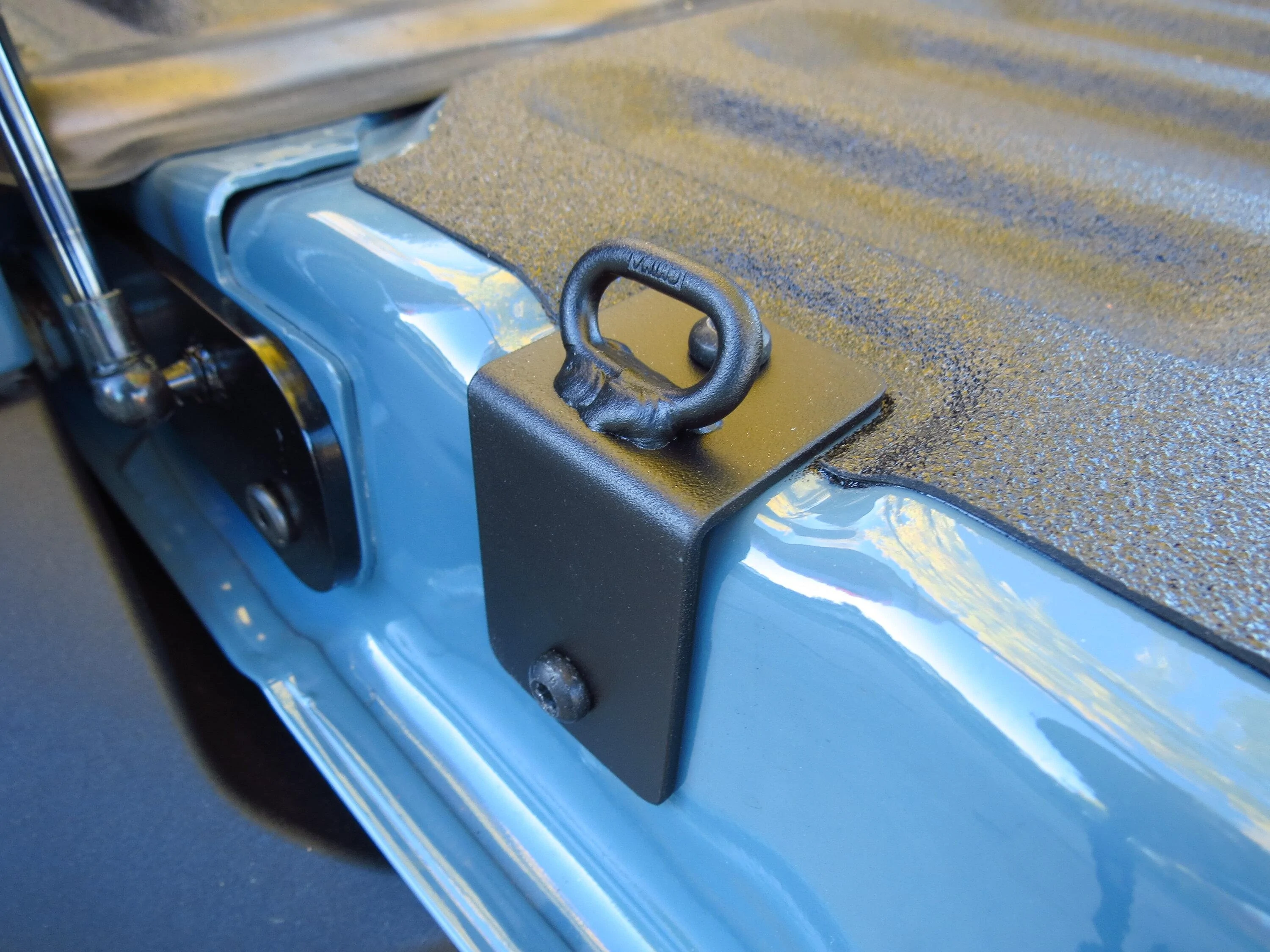

I'd like to get a tailgate assist, but I dislike the idea of losing that tie down point. Anyone added anything to the tailgate to assist with tie downs that aren't on the side of the tailgate by the assist?
I made a simple one from some steel from my workshop scrap bin. The loop clears the strut when closing the gate.
Ford Maverick Best Tailgate assist on Amazon img_1558-jpg
A few people asked if I'd make them one, so I made a few more. If anyone would like one, I posted a thread here in the For Sale forum.

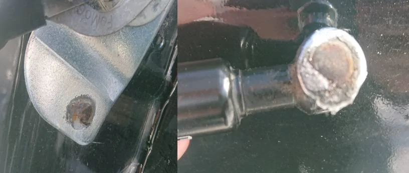

I had a DeeZee on my 2023. It ended up freezing solid one night and I broke the bracket forcing the tailgate open. They sent me another, but to be honest I wasn't happy with it. Took way too long for it to engage. Kinda fell open and then at the last second would slow down. I ended up leaving it on my 2023 when I traded it in.

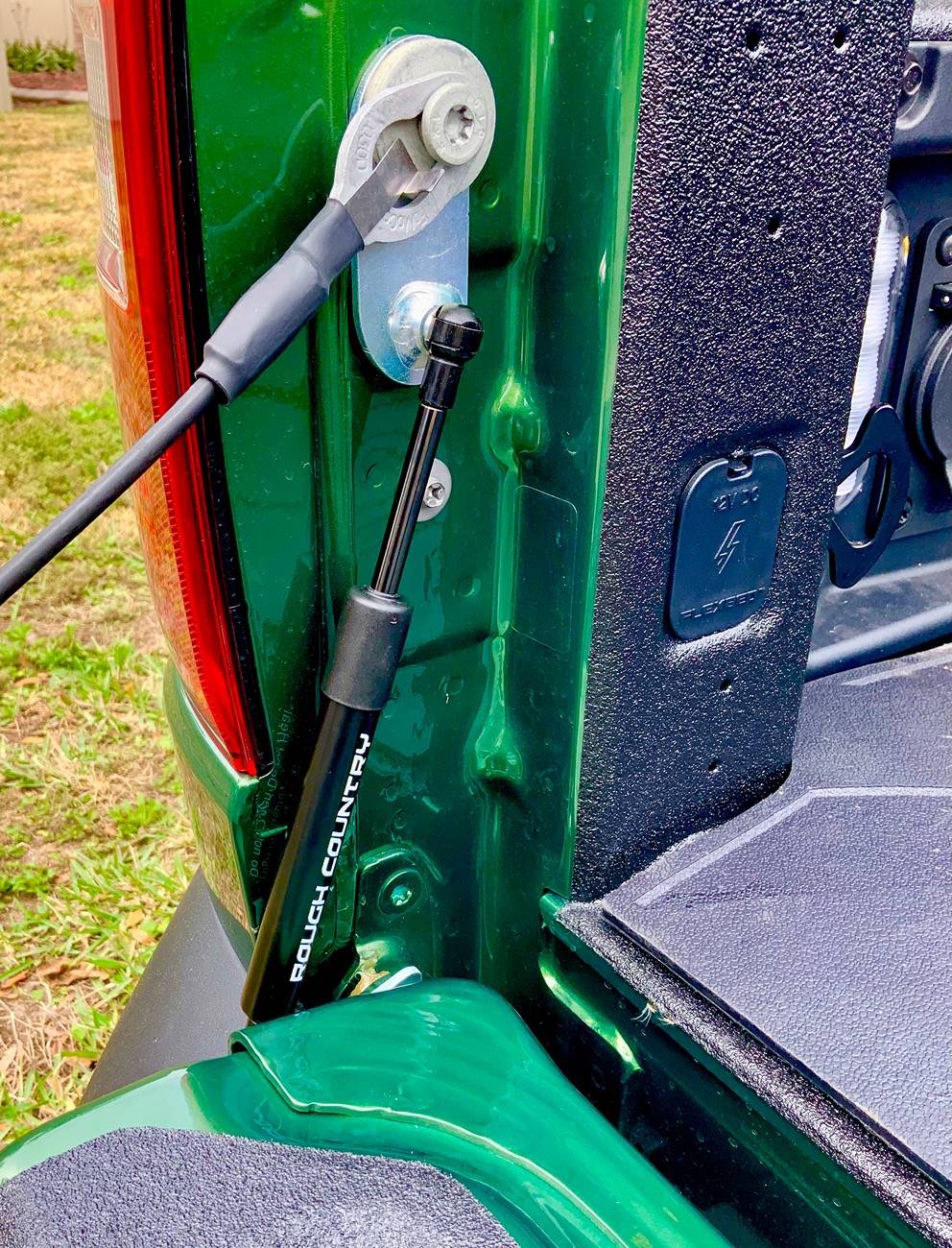

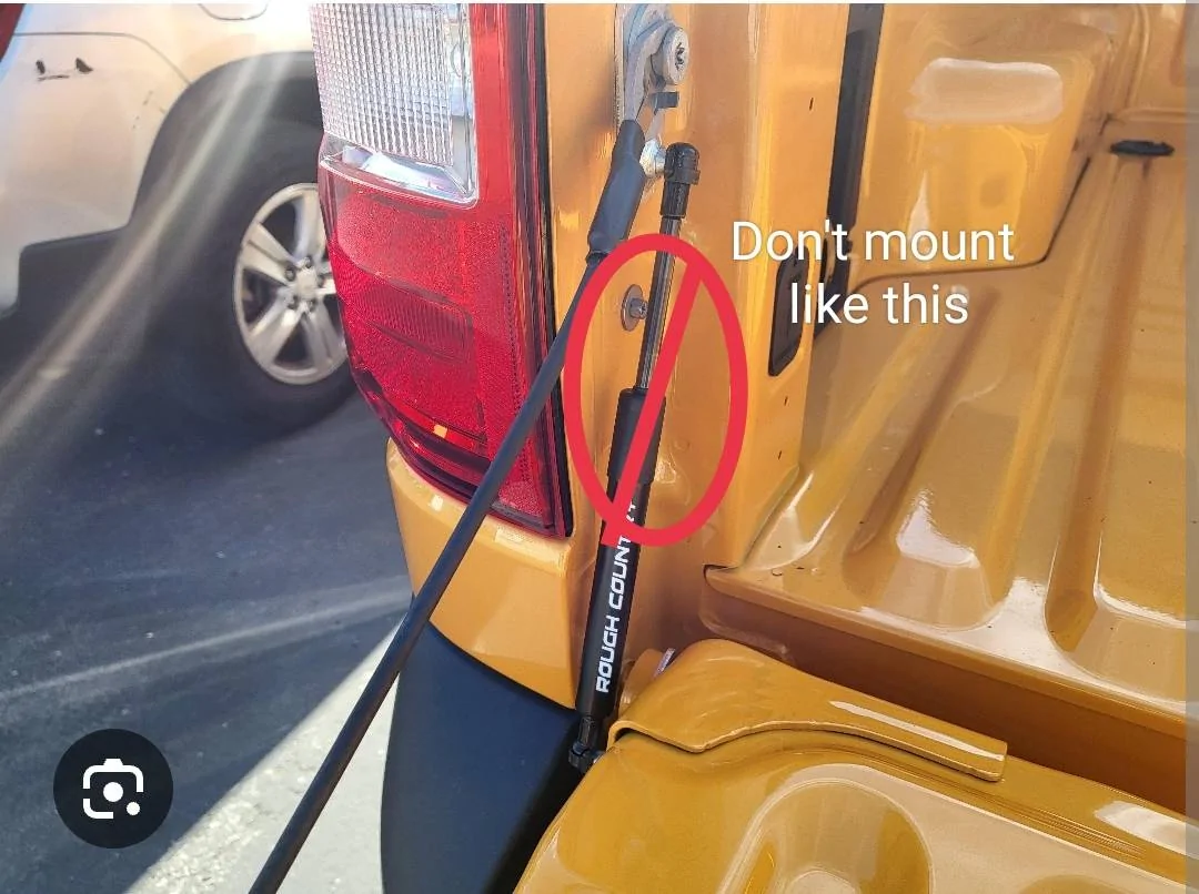

🤔 I don't know how water would have gotten inside the pressure cylinder to freeze, unless the strut was installed upside down, as shown in the picture.
My opinion is that Rough Country mounted the strut upside down for advertising purposes. In order to better show off their name.

I installed the “rough country“ tailgate assist no issues very easy to install - can imagine there is much differences between any of the brands except pricing IMO

Mounted per instructions of DeeZee, as you can see in the picture. Never saw ice or water of any kind but it was frozen shut. I had to use such force to open it that the weld snapped.
Regardless I wasn't happy with the replacement. Would fall almost all the way open before the assist would engage. You think DeeZee is worth another go or is there something better on the market? I'll send it back immediately if I get another one that takes that long to engage.

Number one I think Rough Country wanted it mounted that way out of vanity, so that their name showed. Common sense would have dictated it be mounted the other way around for the reasons I stated in a previous post.
As far as the tailgate dropping it has to drop because the first 10/15 degrees there's no compression from the strut, as a transitions from straight up and down to an angled position.
As I show in my attached video and picture.
Subsequently there is going to be some free fall before the strut has some resistance from pressure.
