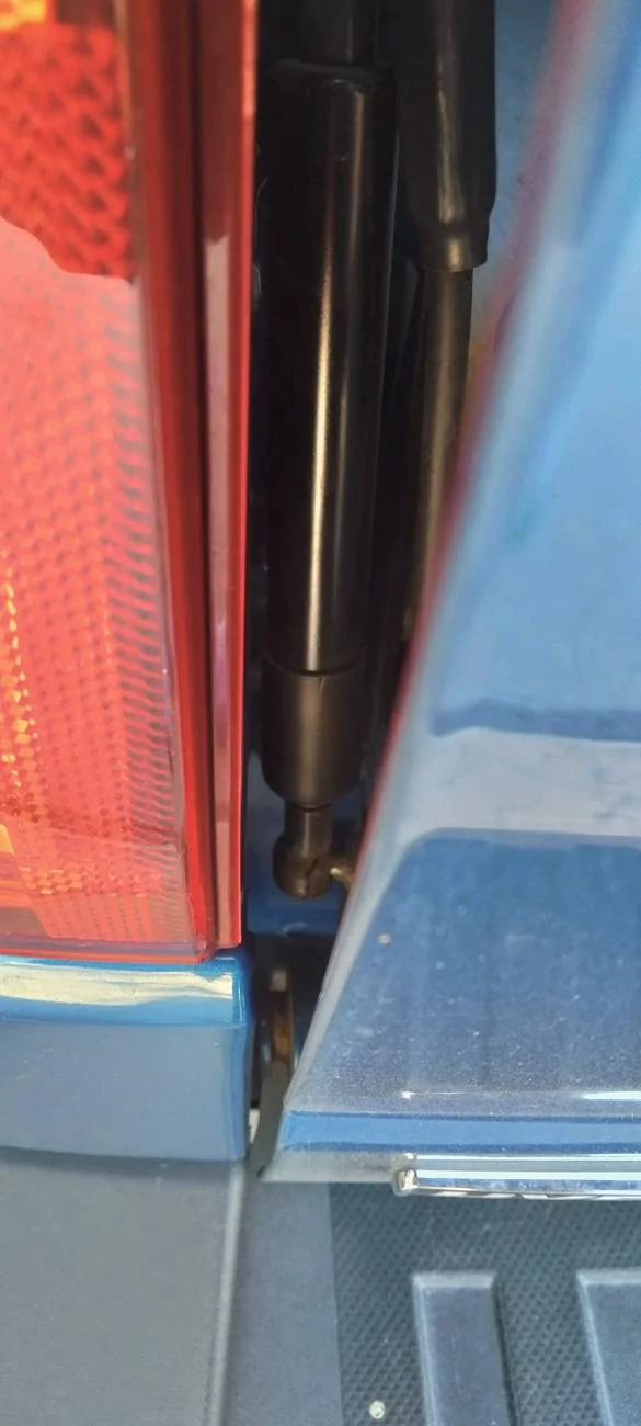

Number one I think DeeZee wanted it mounted that way out of vanity, so that their name showed. Common sense would have dictated it be mounted the other way around for the reasons I stated in a previous post.
As far as the tailgate dropping it has to drop because the first 10/15 degrees there's no compression from the strut, as a transitions from straight up and down to an angled position.
As I show in my attached video and picture.
Subsequently there is going to be some free fall before the strut has some resistance from pressure.
Both of mine were mounted exactly like yours (that's how DeeZee shows in the manual) but it still froze up solid. That's the large end on top with the broken bracket attached to the inside of the bed. Slim end faces down and attaches to the gate.
The first one was smooth as butter until it broke. Second one had a rapid drop... nothing like yours.

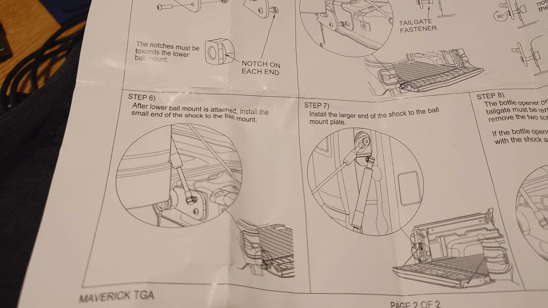

Here is a good video on the installation of the tailgate assist damper, including the reason why it should be mounted cylinder up.
Again... both of mine were mounted cylinder up, just like in the instructions from DeeZee below and just like in my picture of the broken one that locked up. No one is debating the logic as to why it should be installed in that manner.
That said, I wasn't happy with the function of the replacement model and want to see if a recently purchased/installed model still drops rapidly before I give them another chance.

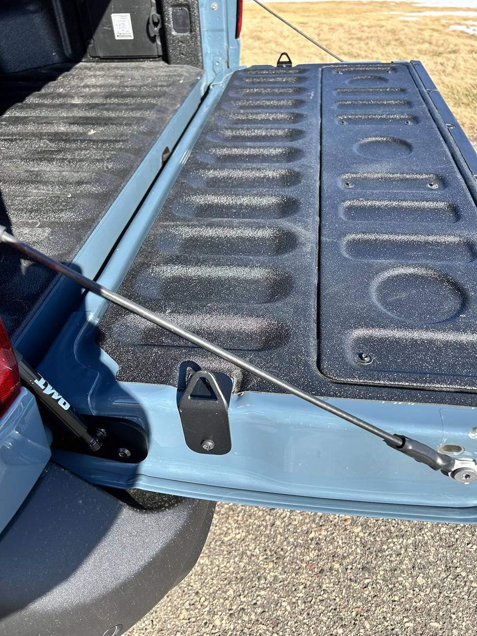

I have the OMT and it works fine. It doesn't slow the tailgate down until it opens about 10% first, and then slows it substantially. I figure I can always buy another one later so no big deal. Well worth it IMO.
