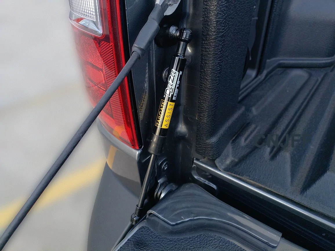

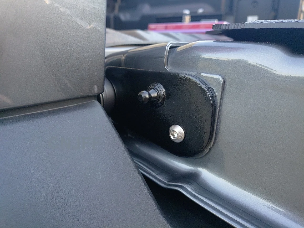

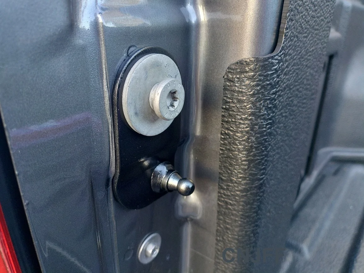

I always browsed these threads thinking "Pffft... Just lower it with your hand it's not difficult!"
So anyway, I needed another ~$15 for free shipping from Amazon (Bezos got enough of my money for years worth of Prime when I wasn't buying much). I was a little uneasy buying the cheaper off-brands since a lot of reviews weren't great. The Dee Zee kit was "on sale" for $32 and people seem to prefer it.
I didn't like the shiny metal plates so painted mine black. Single coat of gloss, didn't need to be perfect. Didn't tape off the pins but seems to be okay. Big thanks to the tips in this topic/forum for the lower bolt. Removed the Loctite and ran the nut as close as possible before inserting. I put some extra grease on the pins as well. I might remove or paint over the logos on the piston since they are a little obnoxious. Maybe I'll throw some black paint over the lower bolt as well.
