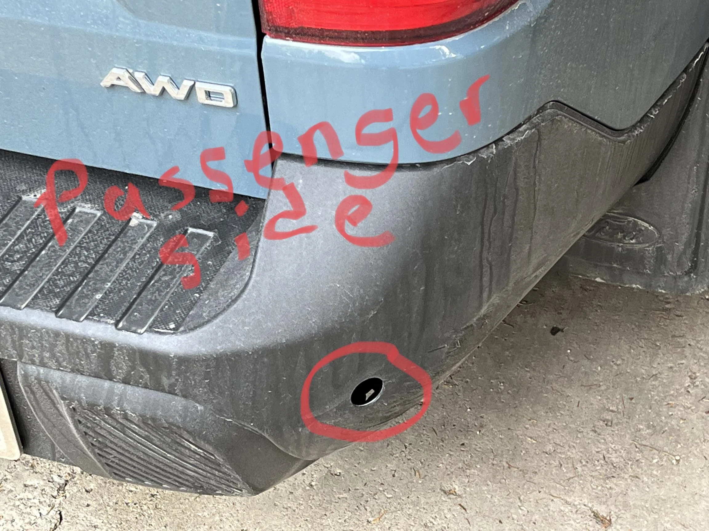

Check to see if there is any obvious damage or dirt/blockage on the small circular sensors on the back bumper.
Here is an example of someone who also would get that same error as you. Can you tell why? Haha.
Ford Maverick FordPass Monitor says Blind Spot Detection with Cross Traffic not functioning 9545cf14-0b0f-49ad-8308-a5b390d75db1-jpeg

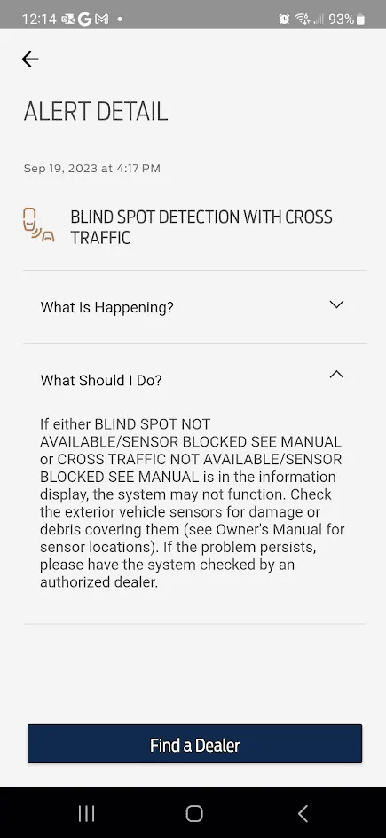

Anyone got this fixed at the dealer? Not looking forward to taking it in.
