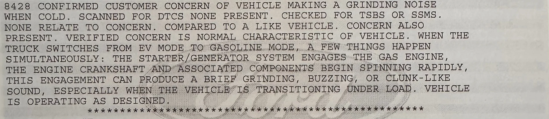

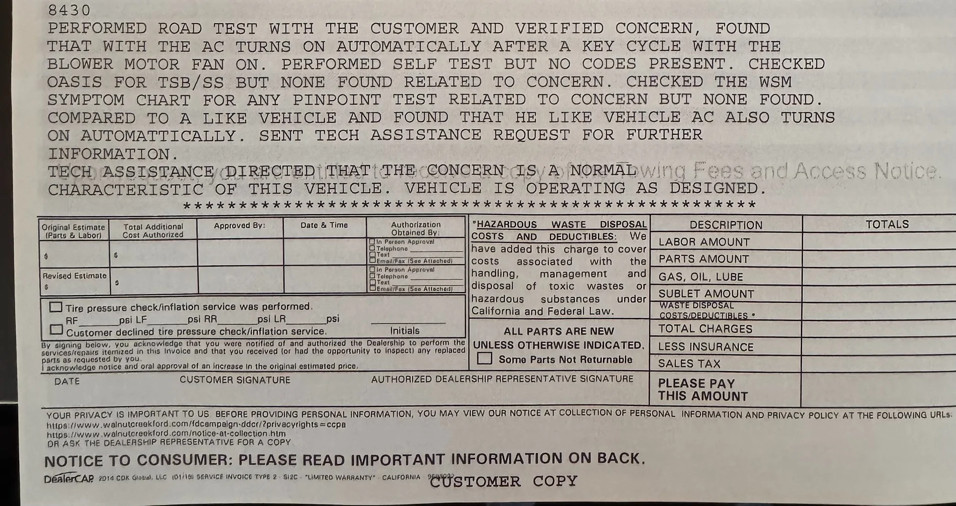

Just picked up my truck. Surprisingly the the dealer not only validated my concerns for the grinding and A/C but they also provided a detailed description. However, I'm very disappointed in Ford's design. I don't like this Atkinson motor/Hybrid system and the HVAC software. Likely going to be the first and last Ford I will own. For a $40k vehicle this is not what I expect.
You should reset your expectations. Its a $40k truck, not a $70k one from the competition, and not a $120k Mercedes.

This is my first Ford and first Hybrid. This engine is very noisy. 1) there's subtle vacuum sound that seems like its sucking air in/out. 2) when the engine warming up and toggles from electric to hybrid I hear and feel a grinding that feels like it comes from the transmission tunnel near the accelerator. Both are like finger nails on a chalk board.
When you add these two big items to annoyances of A/C always turning on at start (fan speed must be at least 1) and seat belt message "OK", it really grates at me.
So, if I could address at least the vacuum sound with insulation that could help. I'm having the dealer look into the grinding and the A/C issue.
I also have an extremely loud AC grinding noise...but the dealer told me (twice) that it is normal. I may look into this hood liner kit to help quiet it down. It's not too noticeable inside the vehicle, but if I'm standing outside with the AC running it's downright embarrassing.
That's a bit sad. I was hoping Ford would acknowledge the problem. I have Toyota Prius as well (Hybrid) and the AC doesn't make any unusual noises at all.

Why is that sad? Everything is working as intended, which means there is no actual problem. What are they supposed to acknowledge, that the customer prefers the exhaust note and the noise, vibration and harshness of a BMW or Mercedes over a Ford?

Well...If you actually heard the noise you would probably agree that it is a ridicuously obnoxious grinding noise. Just strange that they wouldn't use a hybrid compressor(quiet) like other manufacturers use.

It's only when the AC compressor is running. and if I ramp up temperature (down to Max Air) the pitch changes and it gets louder. Really noticiable in electric mode.
