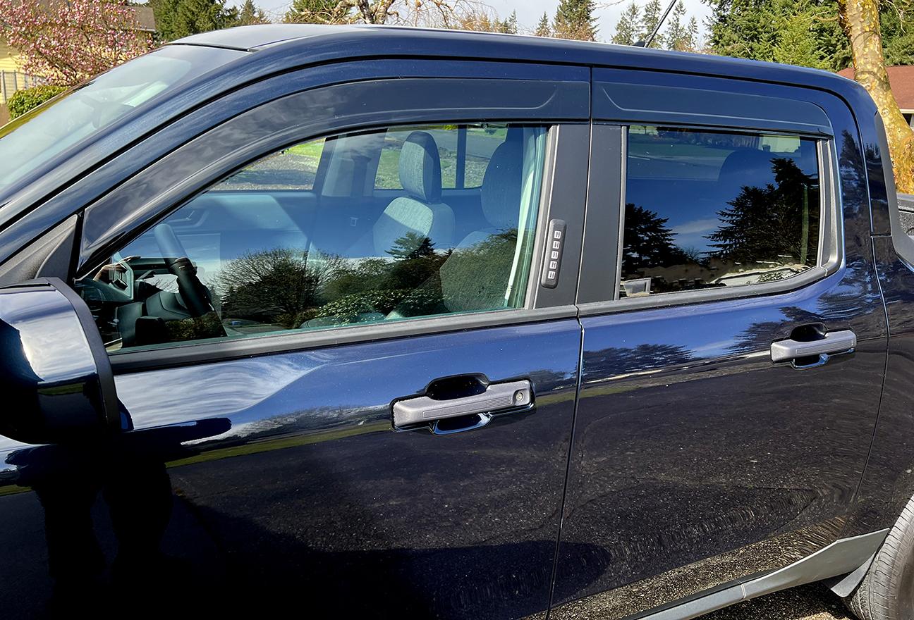

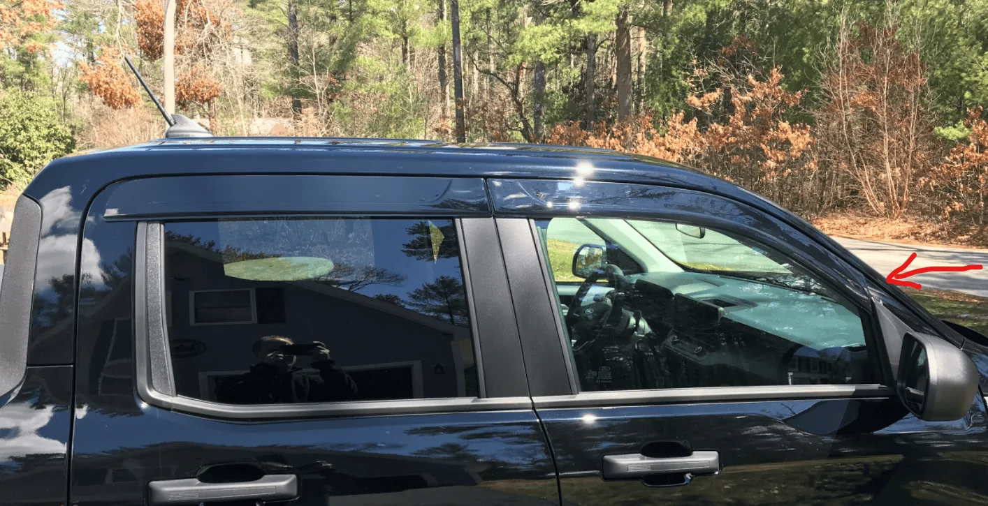

What was your strategy/tools to trim them like that?
I held them by hand tightly in place, and then with a xacto knife I made a tiny score mark on the upper edge and bottom edge of the square side of the trim. The marks were made where the trim met the very edge of the rear door.
I then placed them on my workbench, and using a straightedge I made a score mark from the top to the bottom of the trim piece with the xacto knife (between the 2 small score marks I made earlier). I then took a very tiny fine-tooth saw and slowly and carefully cut it. It actually cut pretty easy. Since you have about a 2" piece to cut off, you can make a practice cut near the edge to make sure you can make an even cut. It's possible that a small hacksaw blade could be used for cutting. You'll want to cut the piece off at a very slight inward angle so that the front of the guard is a hair longer than the opposite side, if that makes sense.
After the pieces were cut off, I used a real fine sandpaper on a sanding block to fine-tune the cut portion of the edge. I then used some car wax to sort of buff the edge. For final installation I lightly applied the pieces and then slowly worked my way from one side to the other. Note that the guards do not 100% perfectly align with the window trim, but when installing you can force the guards to align a little closer.

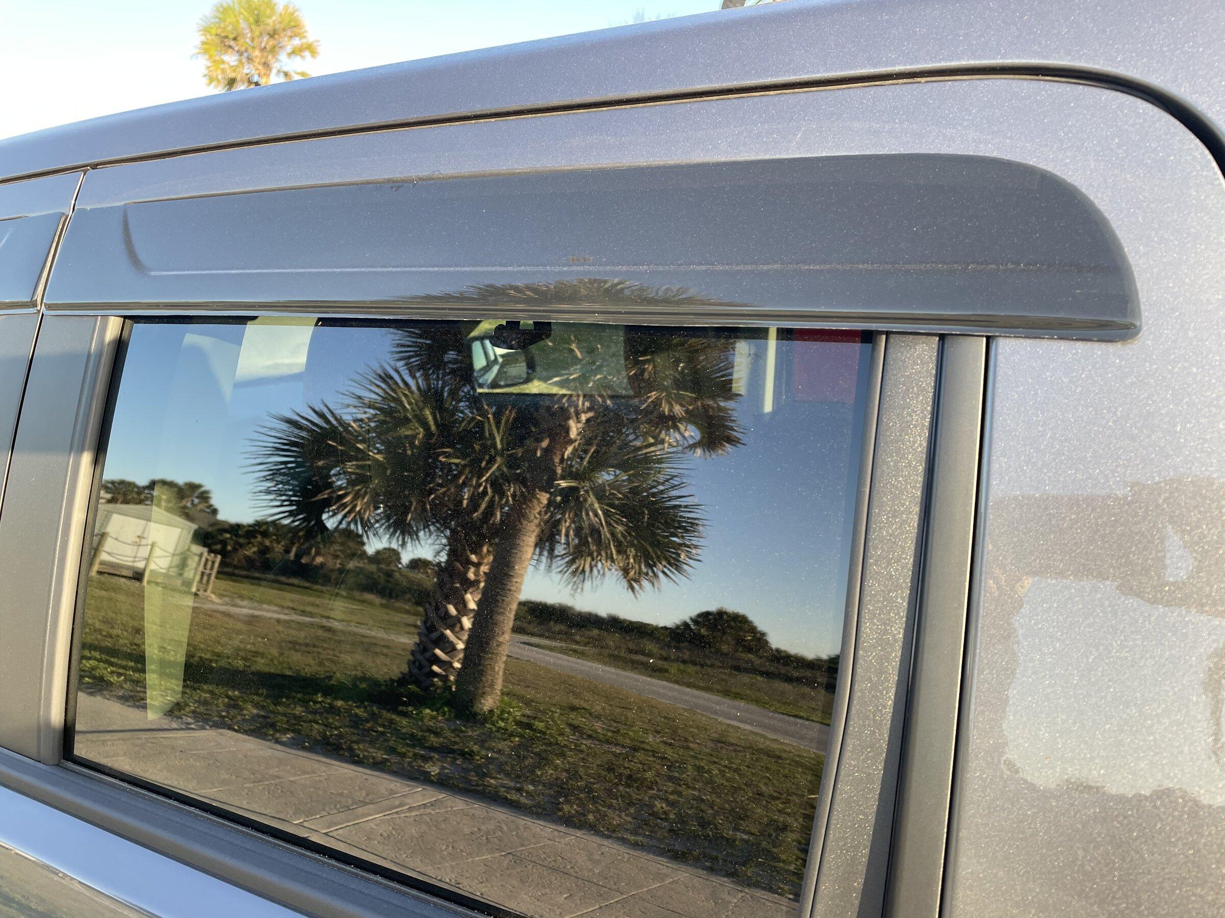

After looking at everyone’s pics I thought I should see how mine were installed by the dealer. I wasn’t impressed with them the first day and am still not impressed 😕 Where do the instructions say to install them?
I think the dealer did yours by the book, but it seems kinda up to personal preference if someone likes it this way so that is matches the trim around the side mirrors, or if they want to mod it slightly to rest at the tippity top of the window, and then you have a bit of a zig-zag up from the mirror trim.
I’m still trying to get used to them. I have never had window deflectors before and I’m still trying to figure out the pros and cons. I have tried opening the windows a little bit, halfway and all the way and I still haven’t figured out the benefits. Some say they’re great when it rains.
Had they not been on the truck when I bought it I would definitely not have ordered or purchased them. I don’t even like the looks of them so I am considering taking them off.

Nice trim job. Looks better.
Have you had any issue with water entering in a downpour with window cracked ? I suspect the overhang was necessary to affect a better water seal due to the low profile design.
GLad you installed them correctly on the rubber modling and not the actual paint. Agreen Not Happy with my purchase, not sure if im keeping yet or sending back

What did you trim them with
A small hacksaw, carefully, and then I lightly sanded the cut edge to smooth it out.
