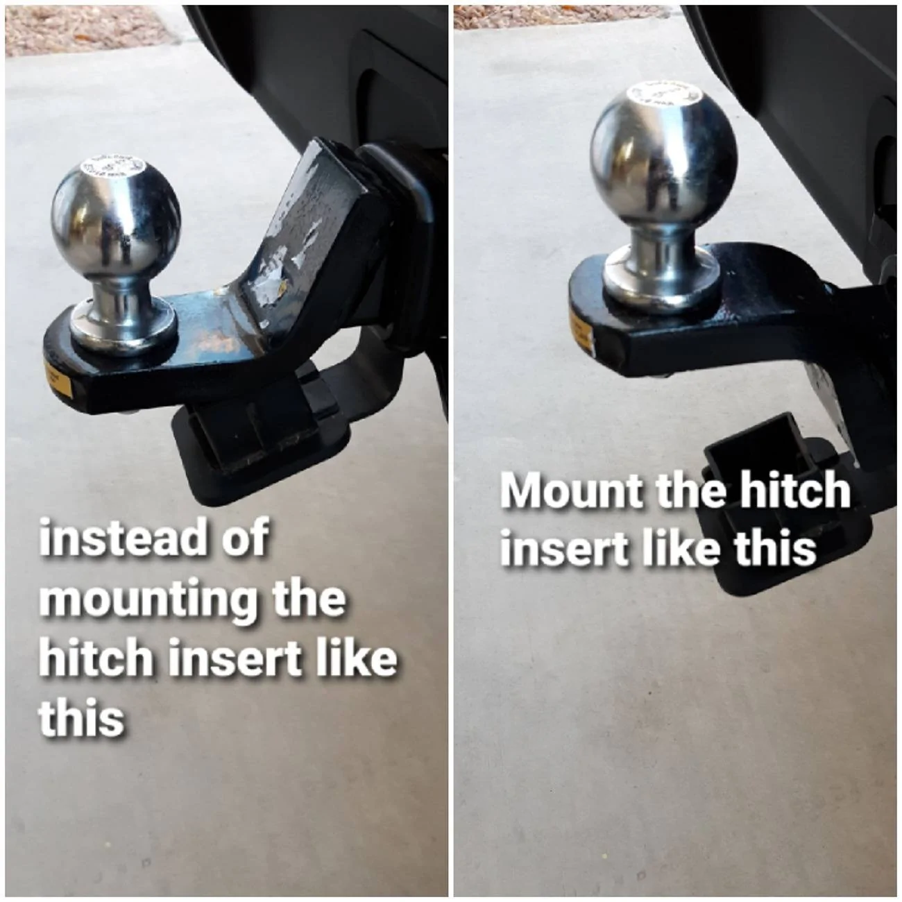

Edit: In some ways this hitch may be better than factory. Since it sits lower, it may allow you to open the tailgate with a trailer attached. With my trailer and factory hitch, if it was about half inch lower, I’d be able to open mine and not worry about hitting the trailer hitch by accident.
Huh? You still need to have the ball at the correct height for your trailer, you would need to use an insert with more rise, if the receiver was lower.

I'm hoping OP found their Maverick on the lot and didn't order it without one intentionally. Regardless, I see a lack of care from OP and then the dealership taking advantage of that.
The hitch was installed correctly. The OP purchased the wrong hitch and was misled by the dealership. Tough spot to be in.

I guess I should have done more research but the dealership told me it was after market but the same as the OEM. I didnt get a picture nor was I told which after market part it was just a price. I should have asked more questions but yes I was mislead into believing it was the same part.

I mean, I would be raising all sorts of hell as well but I just think you're in a tough spot getting the dealership to do anything. Definitely got a raw deal but you acknowledged to them it was aftermarket. Just a crappy situation to be in.

I believe the reason this particular aftermarket hitch sits lower than the actual Ford factory installed unit is that the aftermarket one does not require removing the rear brace or "crash bar" behind the rear bumper.
This hitch will function fine, the only problem I see is you lost some ground clearance at the rear of the truck. Most owners won't even notice the difference in ground clearance during normal use. A steep driveway exit/entrance might result in scraping the hitch on the pavement.
Every truck/hitch and trailer combination I've owned has had different ball height requirements due to tire sizes, actual trailer tongue height, truck hitch mounting point( bumper mount or frame mount) and of course wether the truck is lifted or lowered. Therefore I own several different configurations of rise/drop ball mounts.
One more point - the factory hitch, when ordered with the truck is only $100, but that same hitch installed by a dealer can cost you $1000 once you add the wiring and labor in. This leads me to ask what this dealer charged you for this particular aftermarket version.

The OEM they wanted to charge like $1200 and the aftermarket was $900.

I feel Ford should have made the hitch standard on all Mavericks and offer a $100 hitch delete option.
You got what you bought. You saved $300.
Other than in your words looking ghetto or aftermarket add-on.
It will serve the same purpose.
