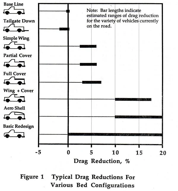

I raise the BS flag for a very simple reason. OEMs will spend insane amounts of money to improve MPG. That's why the ecoboost comes with a stupid stop-start system and an AGM battery to support it. Because a 1/2 MPG improvement across a fleet is HUGE when avoiding CAFE fines.
So if the OEMs knew that there was a significant fuel economy boost from having a cover on the bed, you can bet every pickup truck in the USA would come with one. Maybe a cheap one - but if it gave 1/2 mpg, it would be standard equipment.

To me, it's more a matter of whether you need a tonneau cover to protect your goods or you don't. The mpg difference is negligible and won't change a thing in your day to day life. No sense picking nits. 😬
I can only imagine how the dealership service department would view inexpensive bed covers. I bet every other bugger out there would be bitching about how much they leak, squeak and rattle and roll!!
Besides, if it was bought to use occasionally as a truck, depending on the type of cover half of the people would be complaining about where to store the stupid thing when wanting to haul an appliance or similar item.
I would wager most are added for extra storage.
