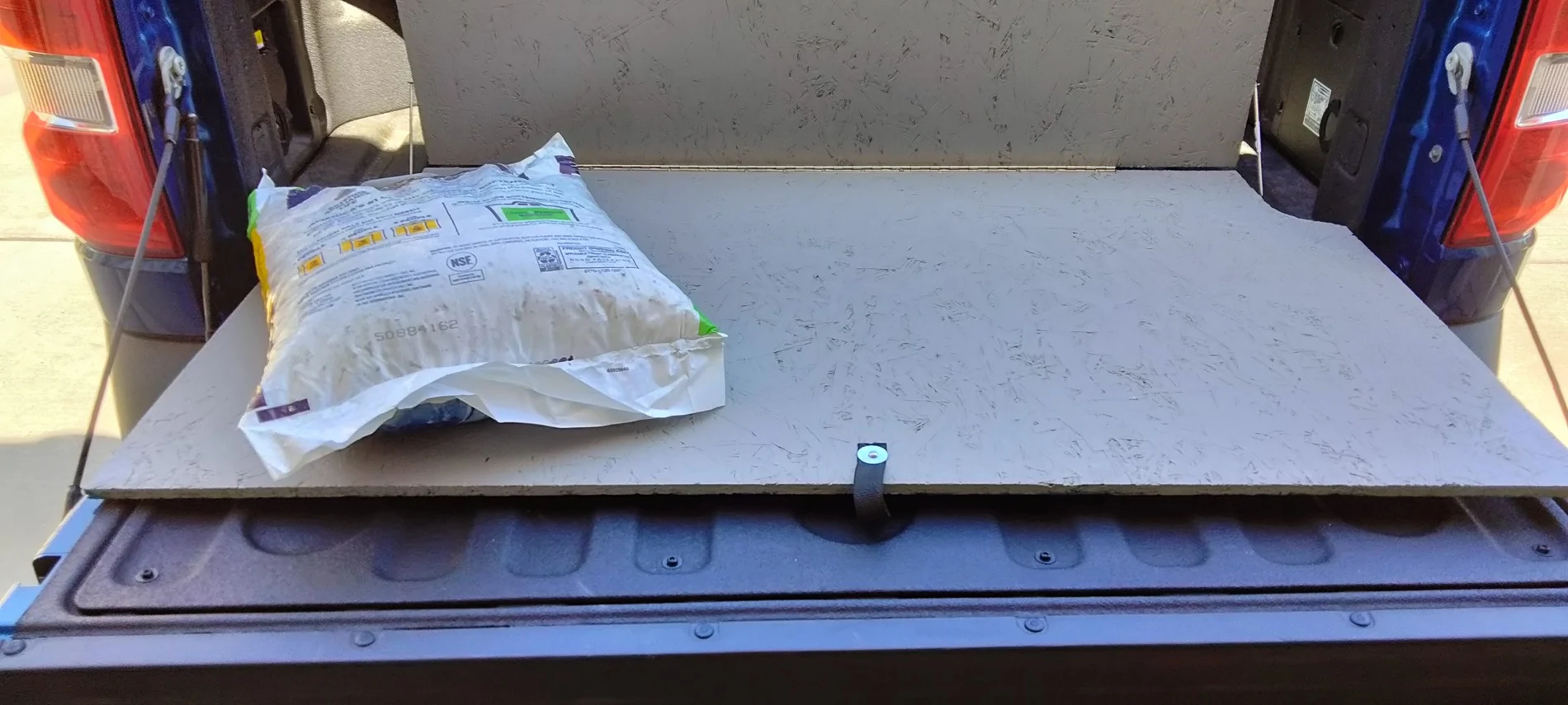

Nope, not yet. I don't know how well that seal kit will work with my slide-out bed tray.
Might create a friction barrier to how it slides.

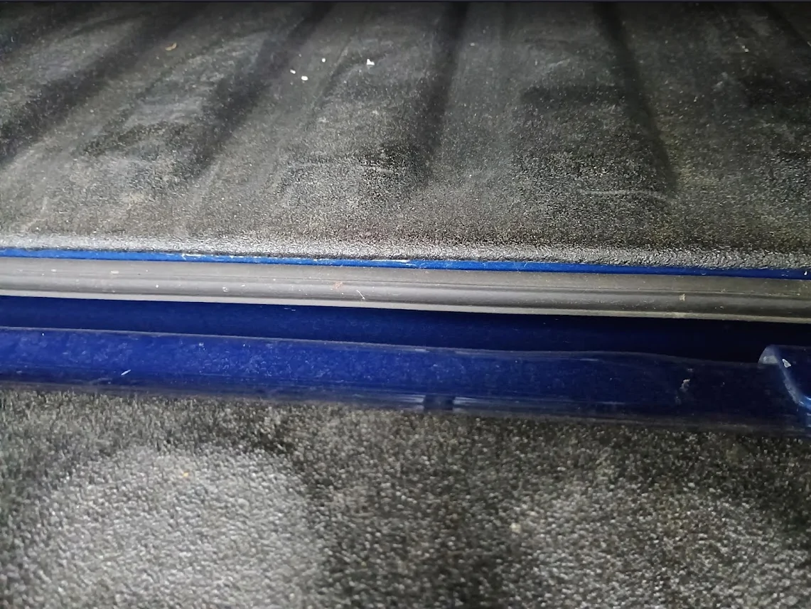

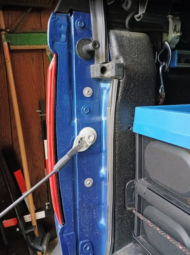

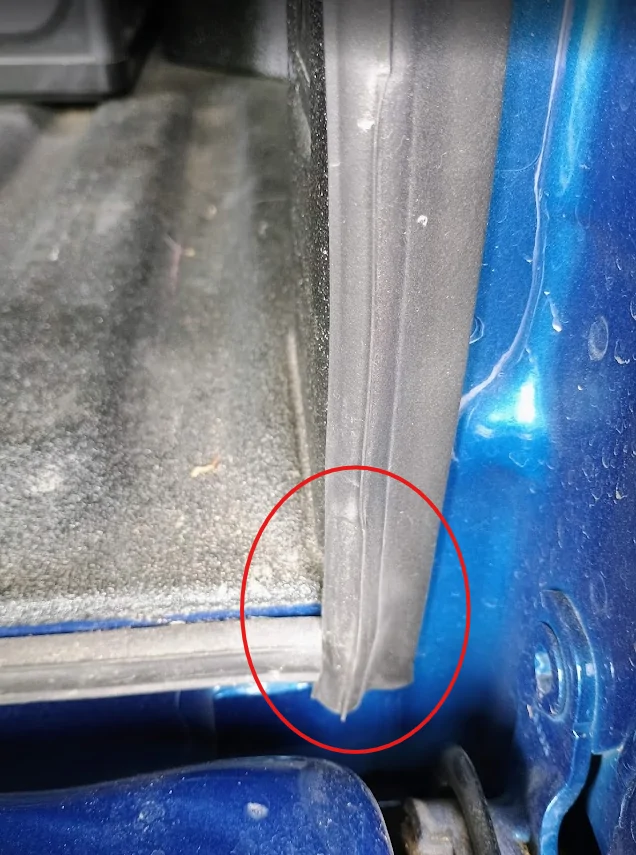

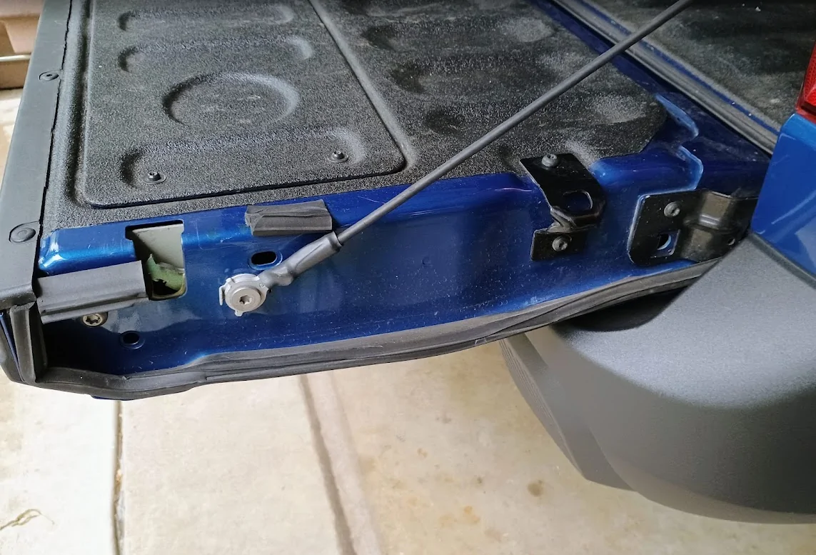

Here are the pics of the ESI tailgate seal installed. I drive dusty roads/trails in CO a lot, so this is a must to keep the dust out.
@Glen Baker LLC , the seals mounted on the sides of the bed opening protrude into the opening only very slightly (maybe 1-2mm), so I think you'd be OK as long as your careful sliding your tray in and out. From your picture, it looks like you have pretty good clearance there.

The only seal that I think would get tore up from the tray, would be the inner seal on the bottom sides.
If I were to install the seals. I would cut the sides at the bottom short. Allowing for the tray to pull out without hitting them.
