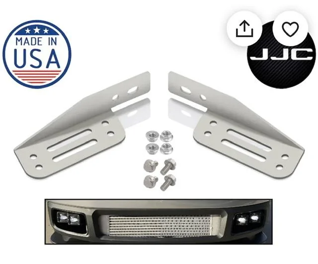

I got a metal bracket off Etsy.

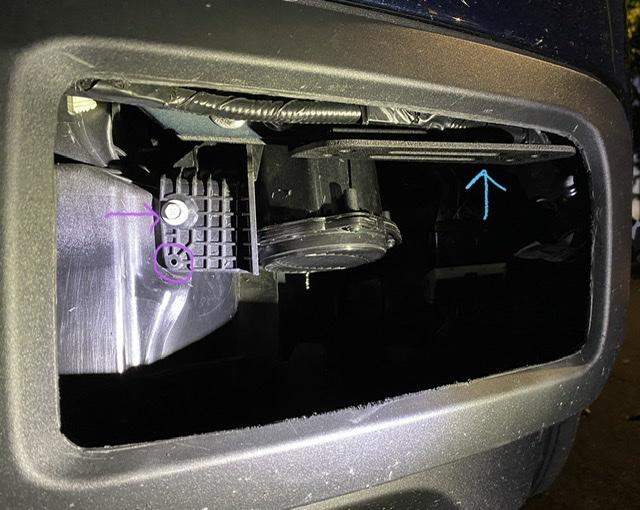

I cut the plastic out with a Dremel like tool. Started small then enlarged the hole. BEWARE there is a wire bundle running along the TOP edge of the rectangle "cut outs". Then I smoothed the edges using a file.
BEWARE where the tow hook would be, there is the engine sound speaker about an inch or two behind the plastic. More space to the tire side. But then my lamp would not be centered. Alas, I still cannot get it absolutely centered because the sound speaker is in the way.

The Etsy brackets work, but you'll need to remove the sound speaker, bolt in the bracket, then reinstall the sound speaker.
The Etsy brackets work, but are a tad too long. They sit "proud" beyond the edge of the truck bumper. Not in love with that. MAY shave them down later. First photo shows bracket a little proud.
Yellow = cable bundle to be aware of.
Pink is speaker screw hole with solid pin.
Red = bracket bolts
Blue = bracket
Speaker and Bracket in position
Never-mind the crookedness. Everything just finger tight for a test fit.
